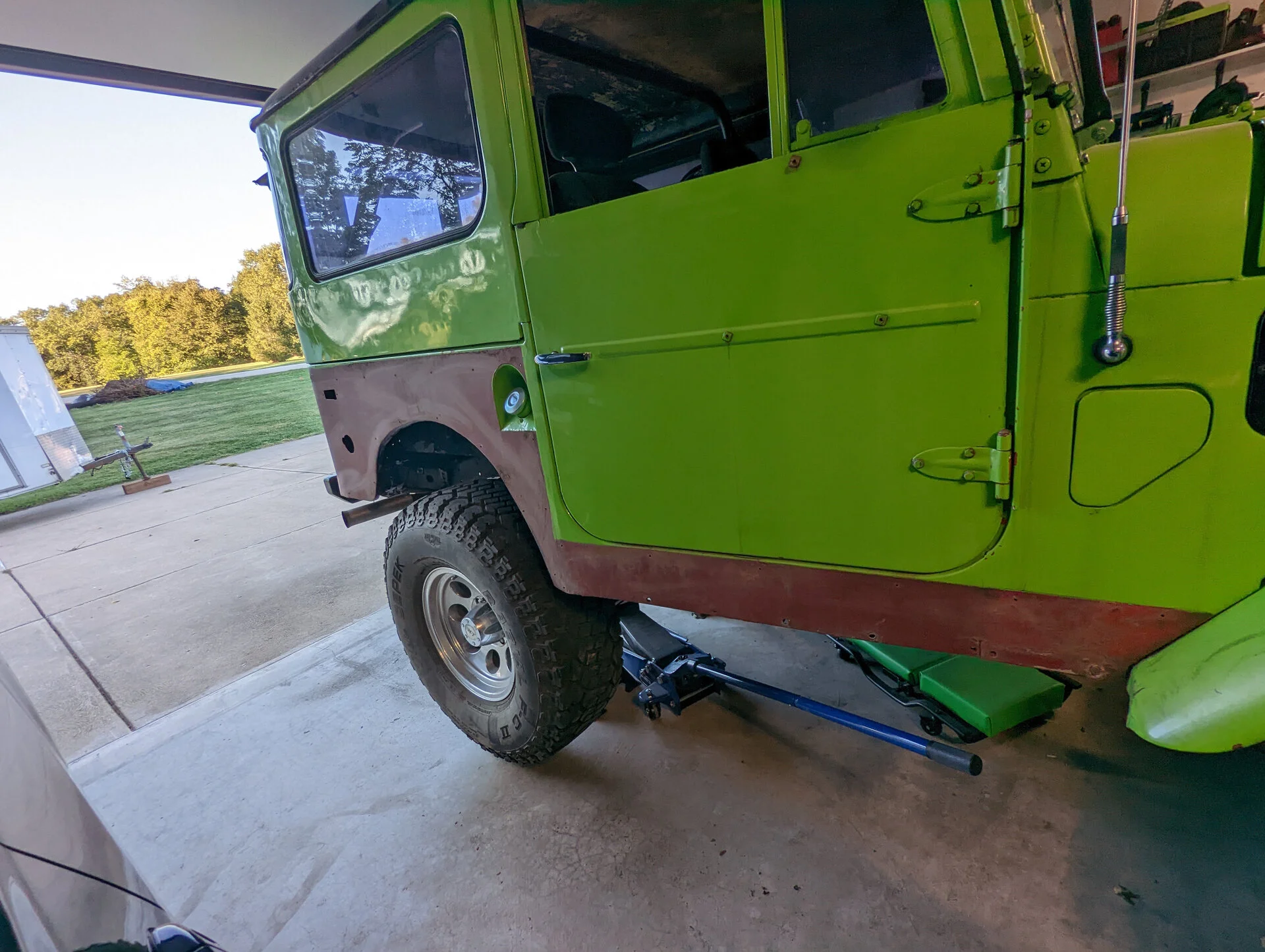

December 29th 2023: End of year wrap up and the body goes back on for a bit​
I was able to get the transmission mounts installed and the cross member is firmly attached. I took a quick video of what's been done over the course of 2023.
With the drivetrain installed. I needed to make sure everything still fit and I didn’t just create a bigger issue. So, it was time. The body was going back on (temporarily).
The good news is that everything fits except for stuff I didn’t expect to fit like the transmission hump. The bad news is that the straps slipped when I was lifting it off my rolling tables and the entire body came crashing down on a cherry picker leg gaining me a new section of body work.
But, it fits!!

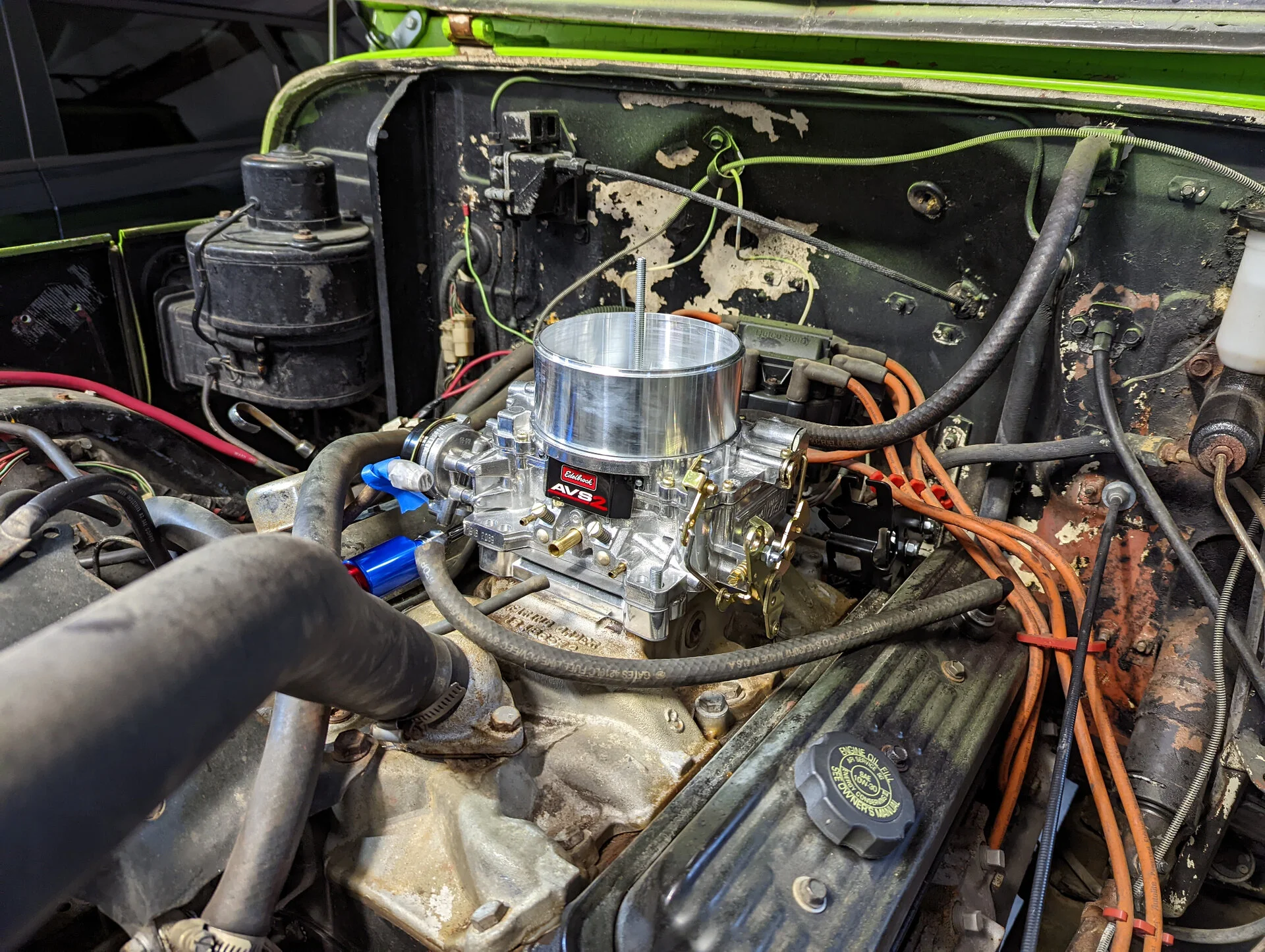

The first expensive fix came in the form of an Edelbrock AVS2 1916 offroad carb. The install went pretty smoothly, though my carb arrived with some damaged parts and misconfigured floats. After taking it apart and getting replacement parts sent to me from edelbrock, it fires up faster than my fuel injected 4runner.

The last easy fix was getting rid of the old diamond plate. I was afraid I would find a ton of rust underneath there, but overall it’s in pretty good shape. There is a mass of bondo that I’ll have to address, but I’ve got a welder and lots of time. The original color looks to be whit and at some point a red primer was sprayed on before the wild green.

March 7th 2024: Maybe I should just buy a new tub​
While I'm waiting on gaskets and brake lines to arrive, I decided to replace the valve covers on the engine and try my hand at body work. The great news is that, under the very beat up valve covers, the top of the head on this engine looks fantastic. Practically brand new. I nabbed some aluminum covers and a new set of goat horn manifolds and everything mounted up nice and easy.
A little more challenging was trying my hand at body work. I've never done this before and watched a whole heap of youtube videos to get the rough idea. Basically it's drywall but more unforgiving and you need to be afraid of heat instead of water. So here's my first attempt. It's not great, but I saved this fender from the trashbin, so I'll take it.
I'm waffling on the final color. I really like this gray but I think that with my body shop skills, white might be a better choice. Though to be honest, I'm not building a show car, I'm building something that I want to have oak tree pinstripes, gravel road polka dots and an ever changing selection of mud, dust and dirt on it. We'll see I suppose.

So while I wait for the hinge plate, I did a little more engine work (replacing the distributor, clutch master and slave cylinders and cleaned up the hard lines) and finally made the steering column mount. I have a weld in plate but it showed up with the wrong dimensions, the vendor didn't have a correctly made plate or an ETA on when new ones would arrive and, by the time I had enlarged the hole myself, there was no way I was going to be able to weld over the gaps I created. So I went down the route of getting one of these bolt on mounts and then turning that into a sandwich of sorts around the firewall. I had to grind out a little bit of space to fit the pivot ball, but this actually worked out really well and looks pretty trick in my opinion (the bolts that create that sandwich aren't installed in these pictures yet, still in shipping).
