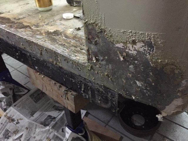

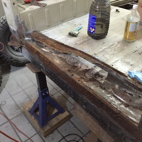

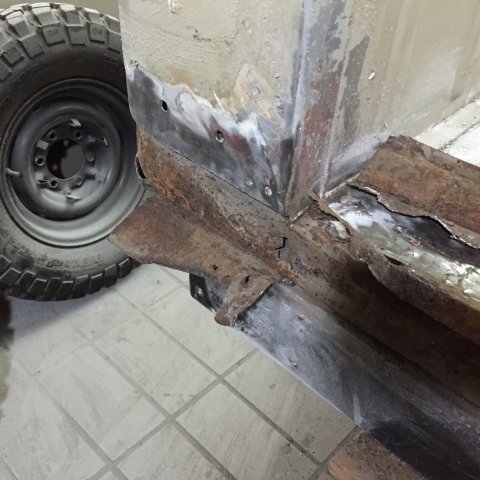

me I see some pics of your fj40 68!!, I'm doing the rear sill and I notice the seam is shoorter than the aftermarquet sills!!
Curious I couldn't tell did your sill have the visible welds on ends of the opening in the back? Those were there from the factory until the 79 when they moved towards the center a little.
on my 68 you can see the clean straigth joint between the sill and rear fender..... no weld on it
also the floor goes and fold over the sill frame and cover by the sill cover.....
is that what you mean??
I took a number of pictures of the weld on different cruisers which I can't find but found one of my 70 that shows the weld on the sill below the doors. Also the only section of the rear sill that is double walled is the corners, If your floor folds over the sill with a second piece covering the sill in the middle I doubt it's stock.
Glad your back! There are some detailed photos of my rear sill replacement in my build thread. First couple of pages show it. I can't remember off hand, but I think your drawing is correct.
X2 Taking a look at my 68 this appears to be how the factory put these together. Bought mine in 74 and the PO had cut a hole to install a trailer light plug. What's interesting isn't hard to tell it's two layers and feeling thru the hole I can feel a rib where I guessing the floor ends. Need to see if I can some pictures. The sides were welded but how did they get the floor sandwich between the sill. Guessing it was stamped? Just glad I've never had to replace one.
