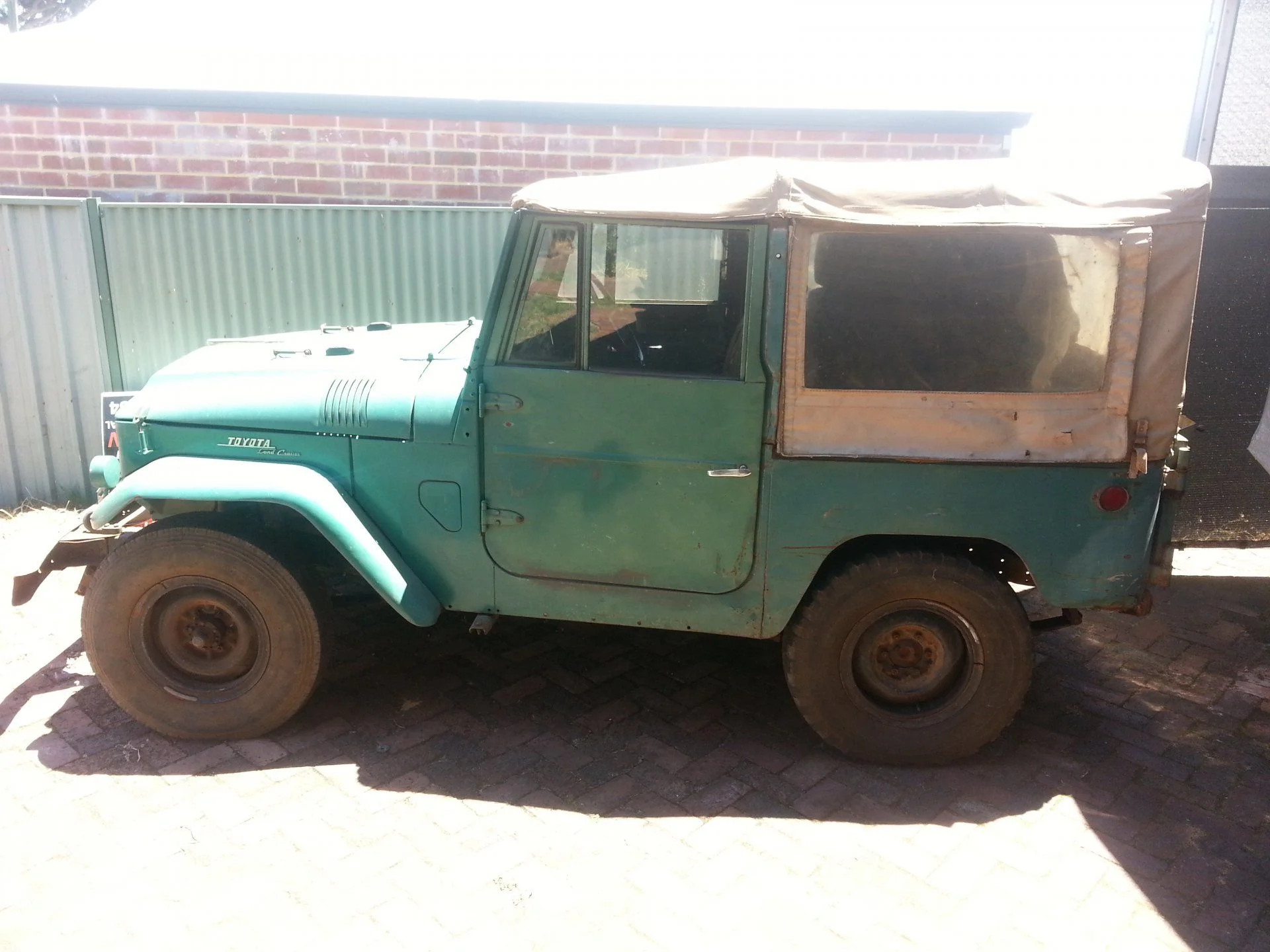

This would be a good subject for another thread. The lack of a thread hole could be as simple as a soft top model meant for a market with hard doors. The eyebolts do notnclear hard doors so no need for the threaded holes for them. Most markets had hard doors on the soft top model. Even when we we're getting a soft top with with the short curved doors other markets we're getting full hard doors on the soft top. I have pictures somewhere of a FJ43 FST in Australia that had short hard door from the factory.
