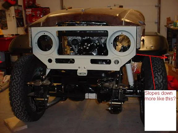

The '6X to '69 fenders are different. They slope down away from the hood almost like they are melting. The turn signal mounting is different and the inner fenders are more angled. There is also the mounting tabs for the coil and windshield washer bottle on the new fenders. From the looks of it, the slope in from the front to back is also different. As a quick fix, you could source a set of '70s era aprons and make the new fenders work.

I guess I don't quite understand, "Slope down away from the hood like they are melting", not seeing what you are talking about here.

I wish :) I've been pretty good about posting pics of anything I do on the lv. Last time I made any progress (at least worth posting) was Wed. night into Thursday. Pic(s) of the front clip on. I spent a few hours here and there the last few days playing with the front fenders. I drilled out the coil mount, so that's gone. I was going to drill out about 10 spot welds on the upper fender on each side, but decided to wait until the body goes back on. The body will bolt to the back side of the fenders and confirm that location. So I decided to wait unti I do anymore major massaging to the fenders. I think once the body is on and bolted to the fenders it will take 4 to 6 hours to get them pimped out. There fine where there at right now, I know exactly what needs to be done to get them to fit perfect.
