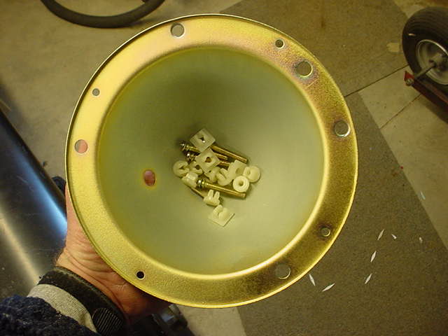

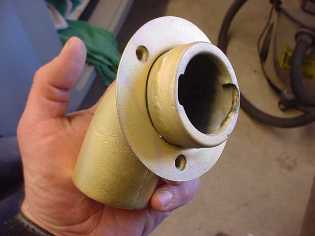

First of all, got back to the house and the mail man had dropped of a suprise. I opened the box and the, "blingo meter" in my garage went off!! Shane, you are the man :cheers: :beer: :beer: :beer: Those plated parts are the sh-t! It looks like brand new stuff, didn't get a chance to put them in, hopefully tomorrow. Also, got your other part you want me to work on, going to PM with a question on that shortly :)

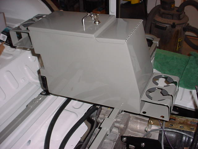

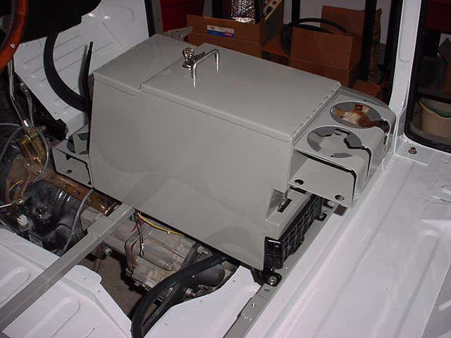

Put my cup holders back together and mounted them back on my center console, I think it looks real nice.

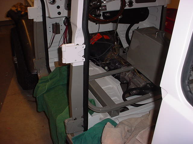

Also cleaned out all the paint in my hinges with a tap in the cordless drill and then installed those on the wagon. Doors will be a while yet, going to wait until I'm done wiring.

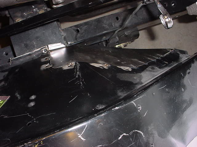

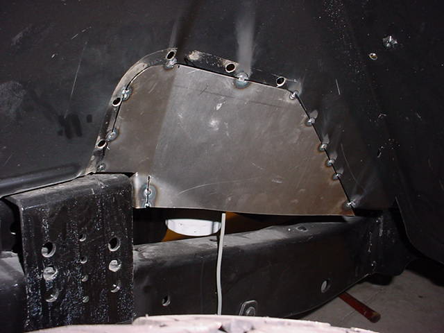

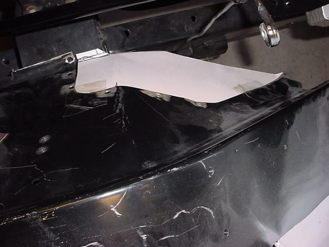

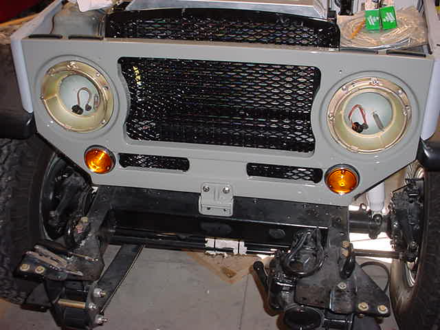

Started off the day by installing those freshly plated headlight assemblys, sweet....Then made a part for the driver side fender where the power steering area was that I had drilled out. Made a paper template and then fabbed on up out of steel. I just tacked it in for now, when I take the fender out to jam it I'll finish weld it.

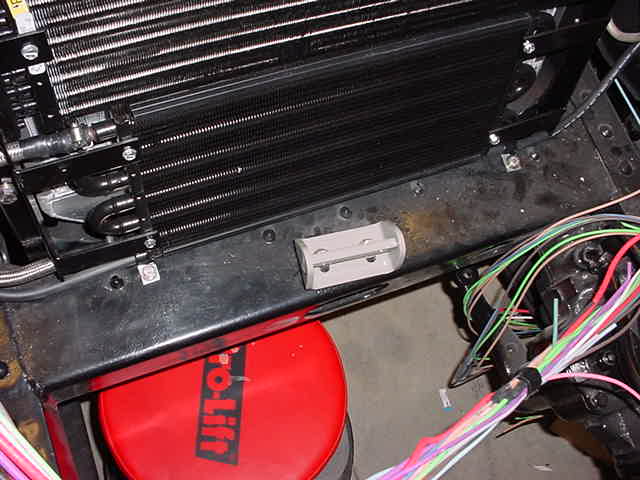

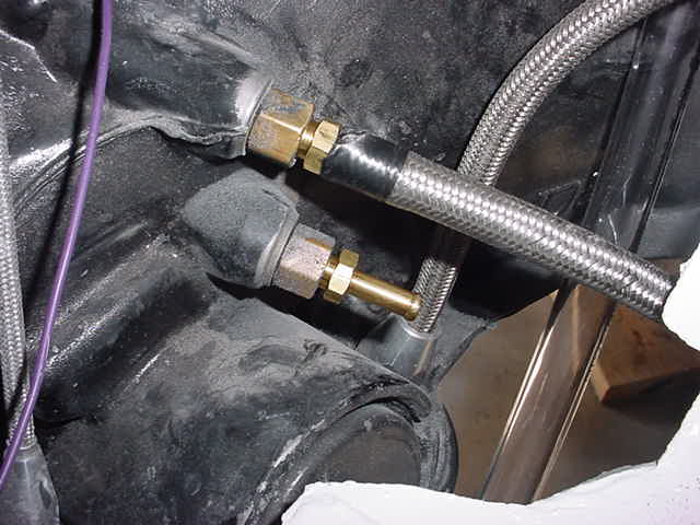

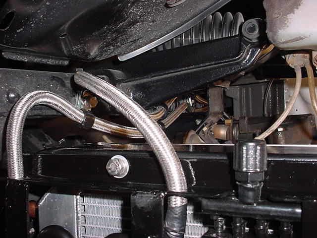

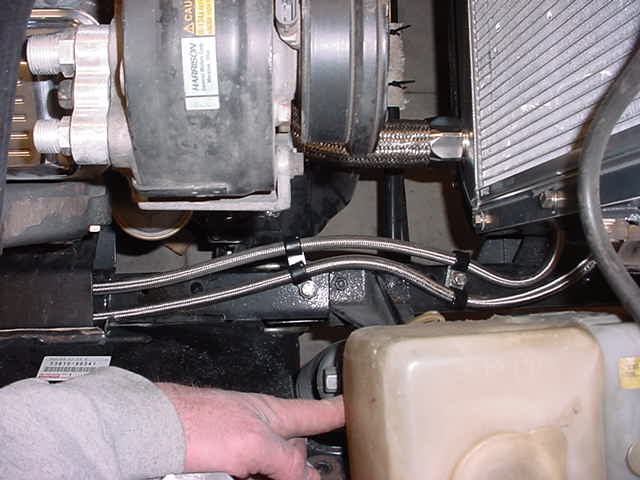

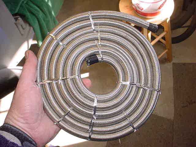

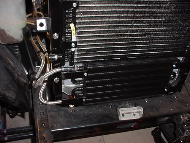

Moved onto my tranny cooler lines. I used some stainless steel braided stuff I had ordered a few weeks ago. I ran them up the frame and directly through my engine mounts. I have to order a couple different size adel clamps, but should work good.

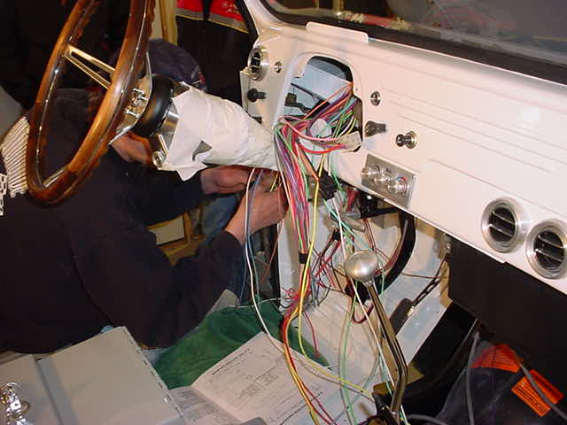

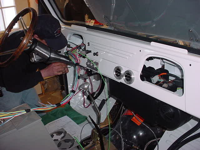

And then a suprise, my auto mechanic buddy showed up, and he wanted to start wiring!! He was over at my place for about 3 to 4 hours and we got quite a bit done. It took a good hour to get a game plan, but we started pulling wire. He was able to get most of the steering column stuff done and a few other things. Pretty much all the wires are pulled through where they need to be. He gave me a parts list before he left, misc. things I need to pick up and get done before he comes back. He's thinking maybe Tuesday night again, we won't finish Tuesday, not even close (he's thinking this a 20 to 30 hour job), but he does think we might be able to turn it over with the key? ;p That should be fun!

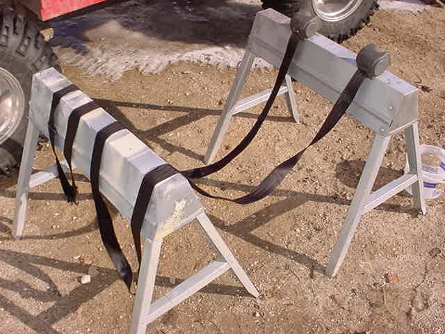

Also, the seat belts out of the 79 were pretty sun faded and what wasn't was grey in color. Had the wife mix up a batch of RIT clothing dye and dye the seat belts black, few pics of those outside, look pretty much new.

Man, you could sell those plates for skinning in the drive's fender when the steering box is removed. That's always bugged me about trucks when people do the saginaw or 60 conversion.....big gaping hole in the fender well left over, that and most people don't do a very clean job of hacking the fender for the 60 series conversion. Maybe you could just bend up a whole inner fender for 60 series ps conversions and sell that. :)

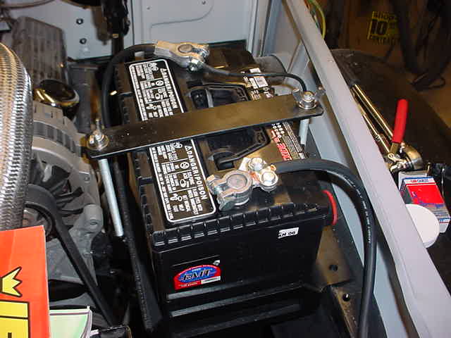

Lots of little stuff, my mechanic buddy left me a to-do list and that's what I was doing. Got all my clamps on my coolant hoses. I had to make up cables from the battery to the engine and tranny, also postive wire to the starter. I used a 4 gauge wire and ran it around the front x-member in front of the radiator, I think you can see a semi decent pic??

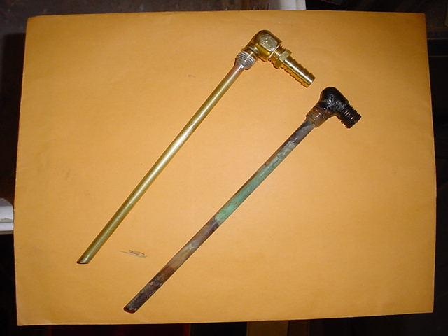

I made up a new fuel pick up at work today. The stock one was some time of compresion fitting, but the threads were unlike anything I had in the store?? It was just easier to make a new one, used a 1/4" street elbow, 1/4" MPT to 3/8" barb and then used a 1/4" brass tube and soldered it into the street elbow. This evening I installed it and ran tubing from the fuel tank up to the fuel pump inside the frame rail.

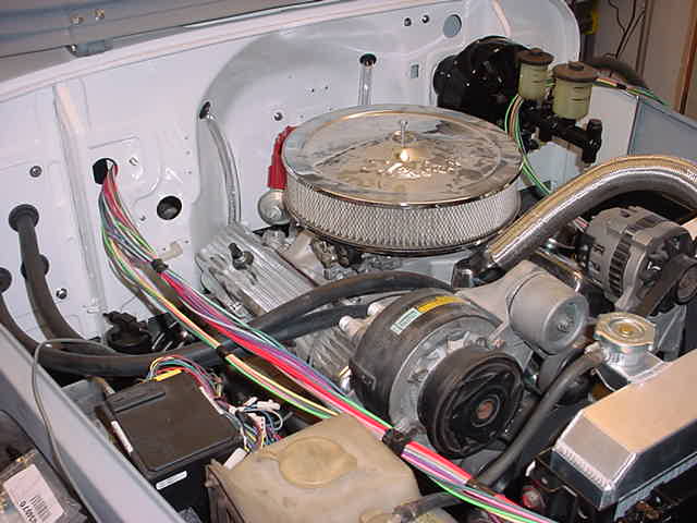

wngrog said:
attachment.php
Where did you get that tlarge stainless hose on the top of the engine?
Summit. I believe it is a 20" or 22", 1.5" on each end, the brand might be Spectre, not sure on the spelling??
The radiator I got from Man-e-fre had a 1.5" neck on it. I also got the billet aluminum adjustable neck on the top from Summit in a 1.5"
Hope that's what you needed?

Buck:
Make sure your ground path is complete. You need from battery to frame, battery to body, battery to engine, engine to frame. If you don't, bad things will happen.
I had a truck that ate three distributor ignitors while I tried to fiure out that the engine to frmae (or was it engine to body? long time ago) was missing. The gourn will find it's won path, many times thru things you don't like, if not provided a proper path...
