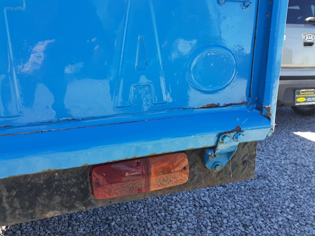

I think if someone was local it's worth a look. The wrong parts could be replaced, and maybe rust isn't bad. Haggle to 13k, and it's a pretty original 45 for a resto mod at the very least. Or replace the bed like I did on my 45. There's not that many of these, gotta be flexible if someone is shopping one out.
I don't think I've ever seen one with only 2 hinges on the tailgate?

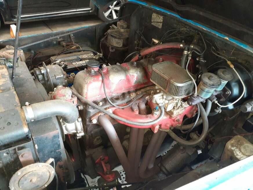

You guys think the VIN actually matches this truck? Looks like it was altered. I see a later model brake booster....maybe the firewall was hacked up? A hot mess in my opinion.
Late 70s to early 80s heater too... Run
