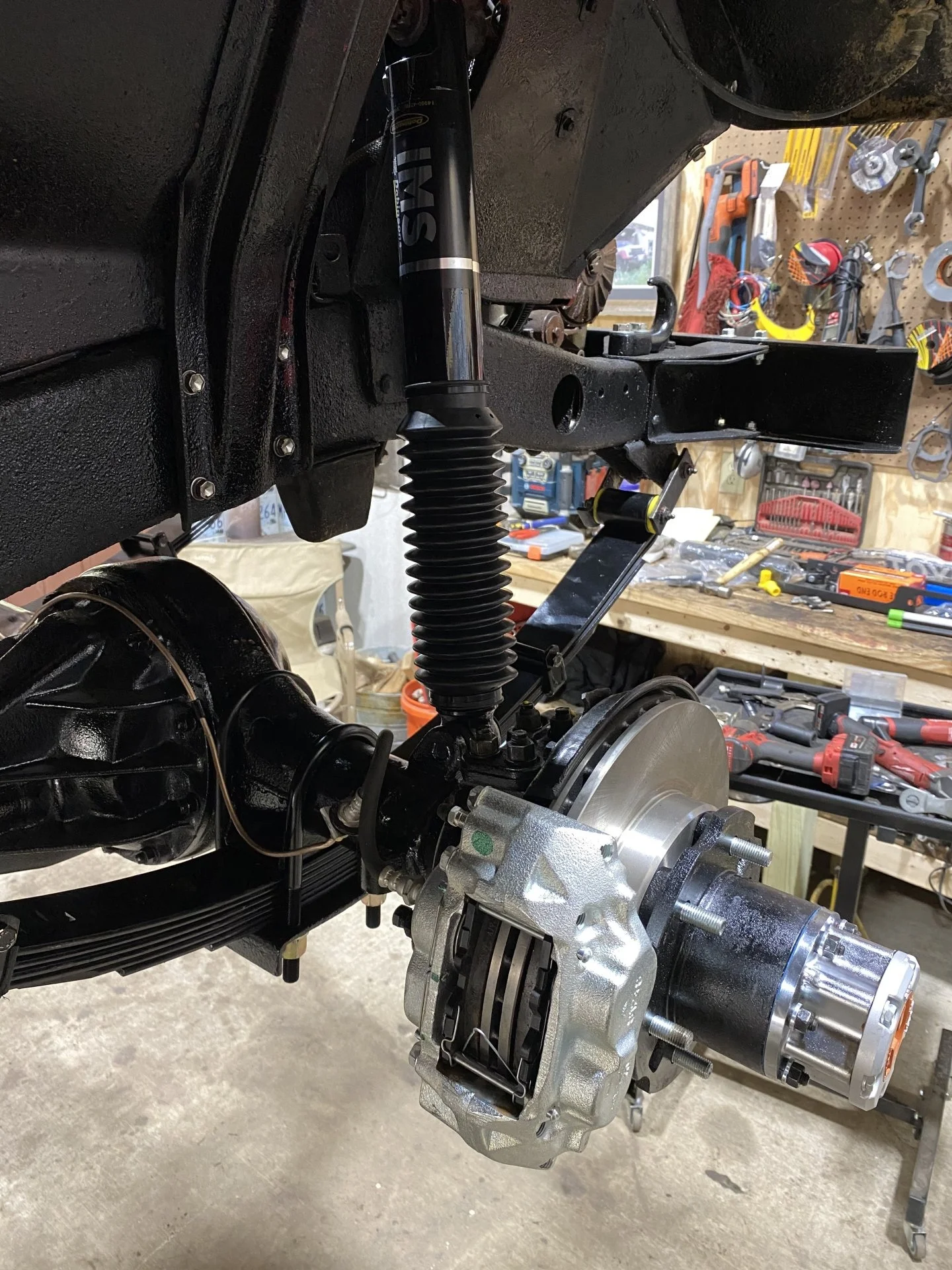

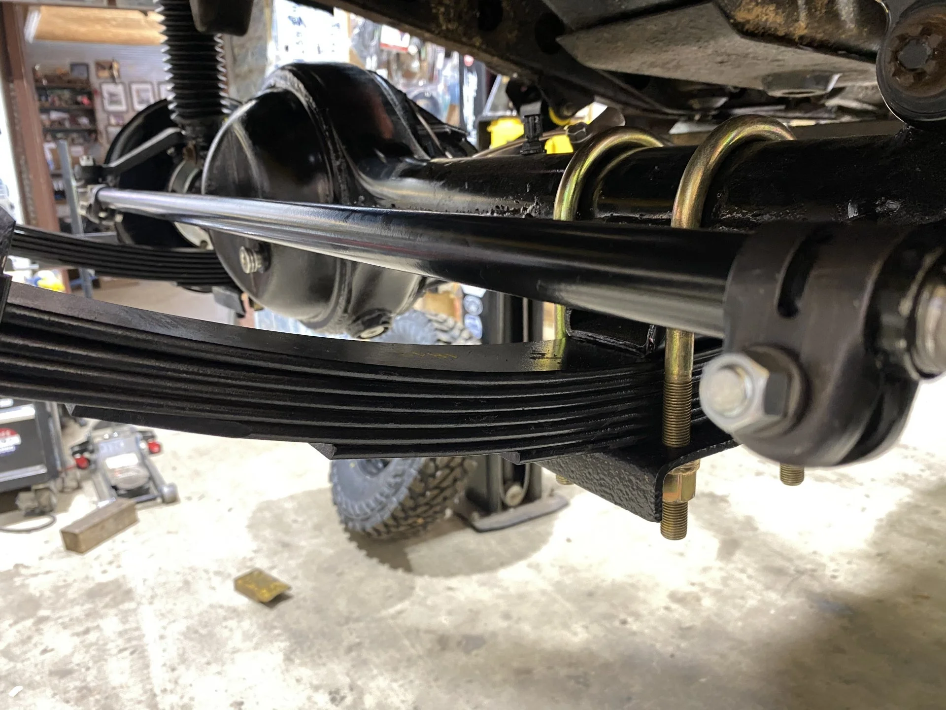

Next up. The front. The spring pin sent was a 60 series (or maybe the Aussie 45s had these) but as y’all know the front of a 45 is a 40.

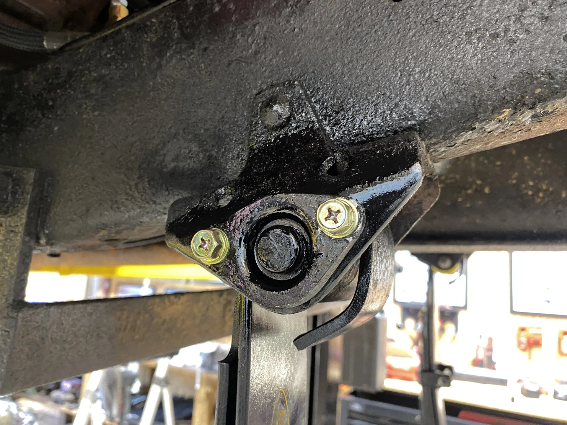

Luckily I had a full set of spring pins and shackles and most importantly bushings.
You need 15mm bushings with the big eyes like a 40.
IMS are a tight fit but they fit and even though they send 4 of the same length, the 4” of shaft showing at full droop is enough for the uptravel needs.

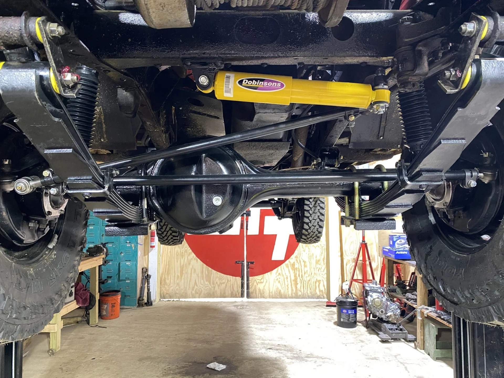

Freshly powdered new tie rod and drag link via @cruiseroutfit
I set the toe with my new toe plates. Also the front shackles provided were 18mm FJ60 style like the rear but the 45s need 40 series. I had some greasable stock style here and put them on.

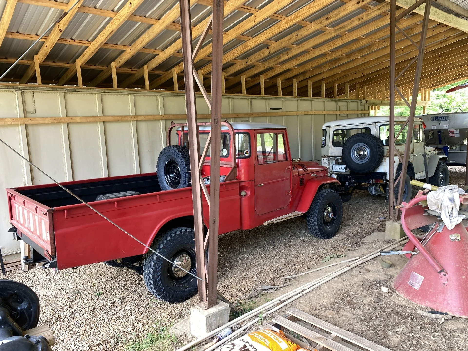

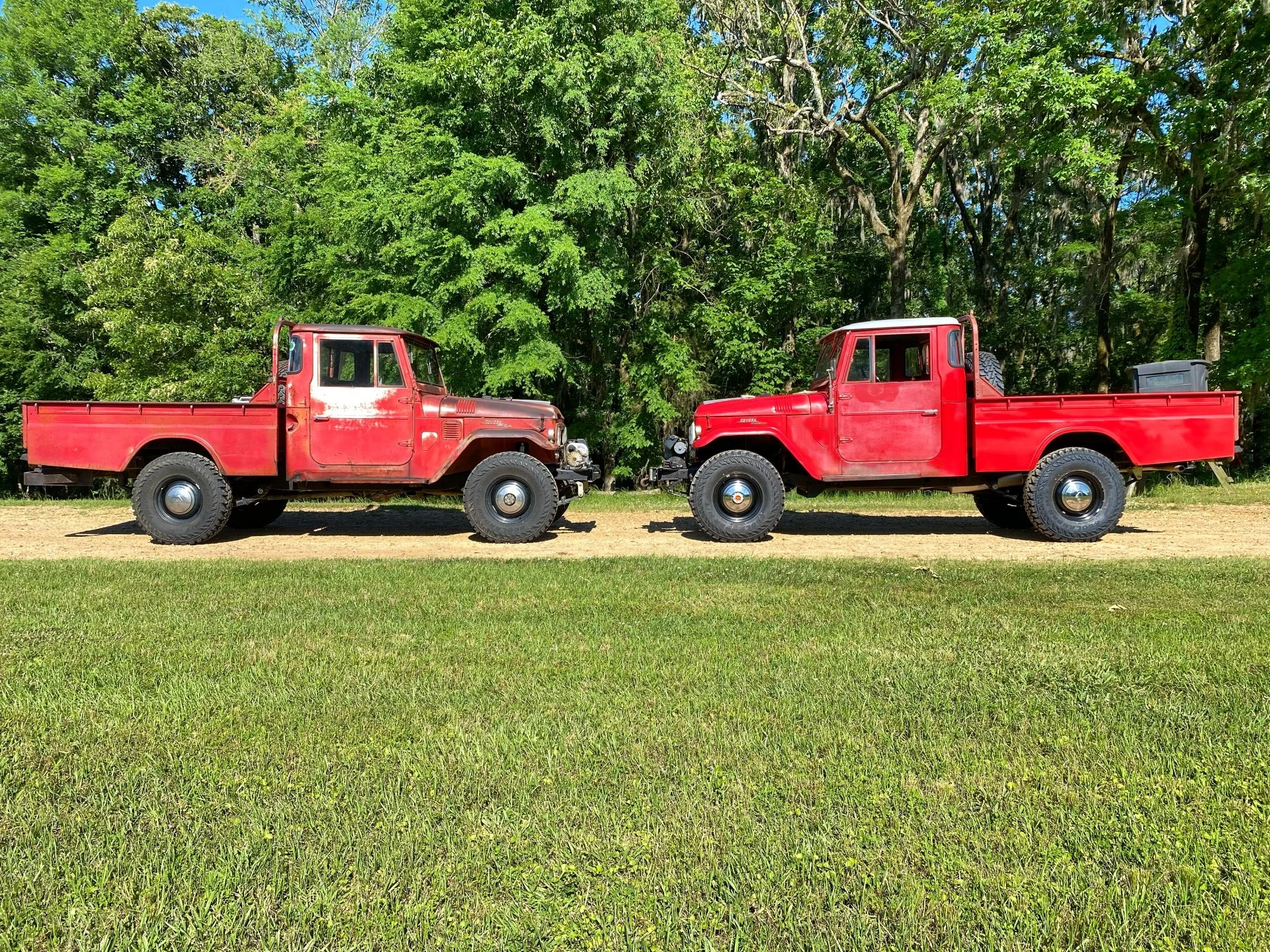

I still have a few items to button up and brakes to bleed but some pressing projects need the main shop so I got the ole LPB out for now and posed it with the ole Goat.
I absolutely love the stance out of the box. No leaf removal.
Keep in mind, my truck has 3 OME rear leafs removed and a leaf added to the front medium pack as well as a 1” longer shackle.

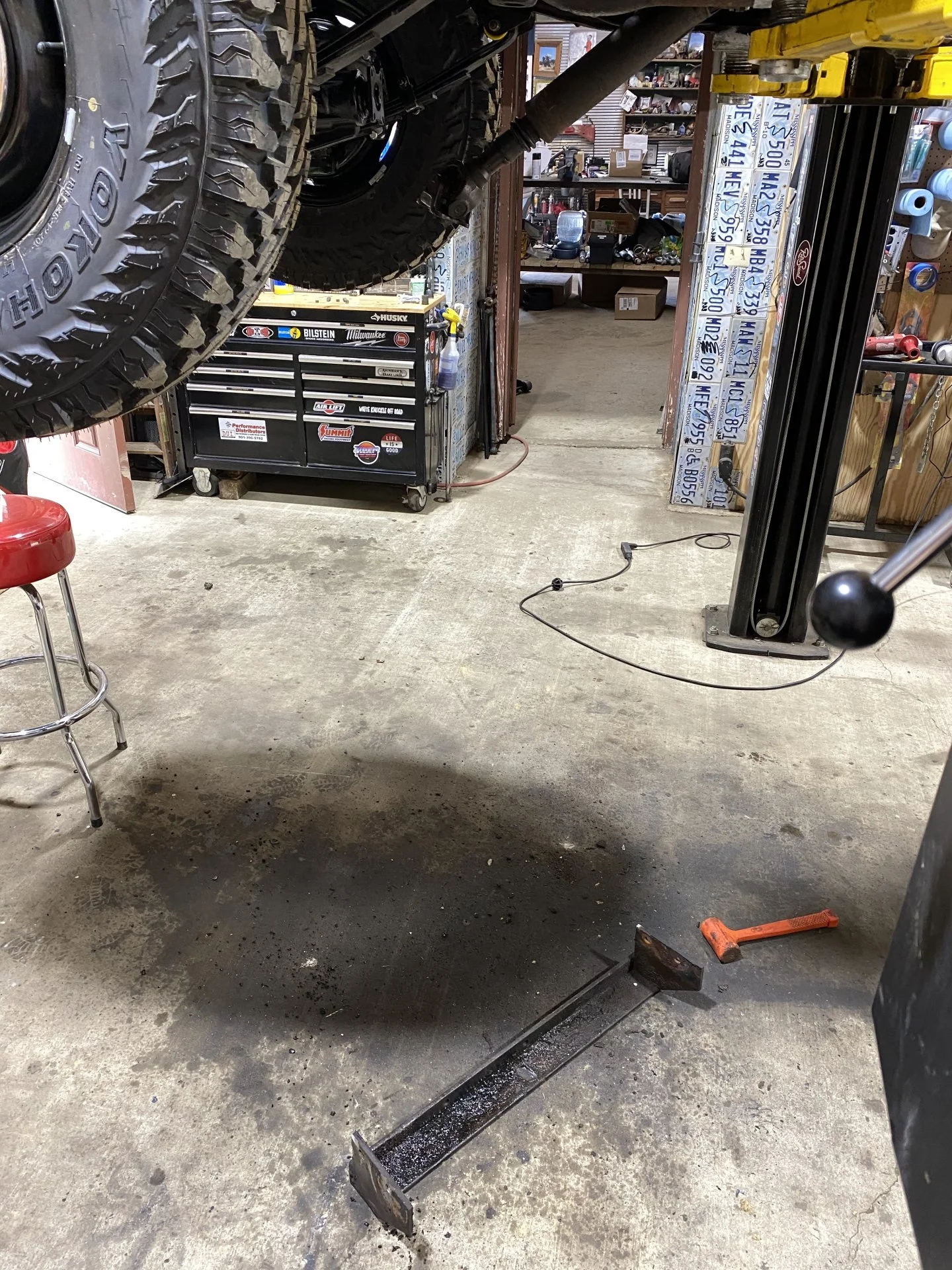

Went to install the front driveshaft and there is too much droop for this snow plow bracket to stay so I had to cut it out. I’ve been trying to stay in my lane on project trucks and not spin off on things I want to do, just stuff I’m asked to do so it did not get removed earlier when I had the hot knife after the old suspension.

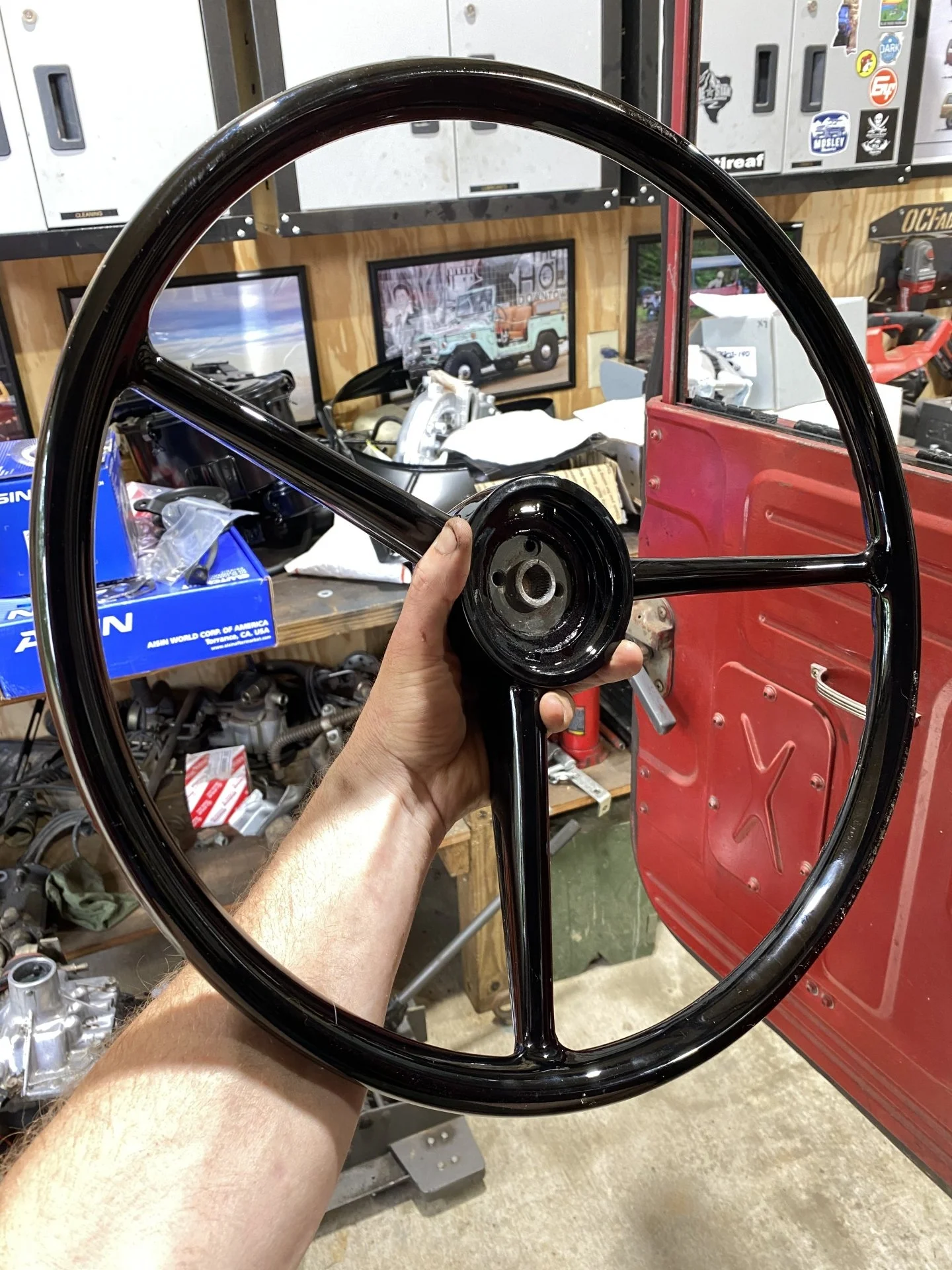

Last thing I was to do was add this fancy restored steering wheel.
Turns out the splines one the hub are bad. Dude restored a crap wheel. Also there are cracks and a piece that fell off so Shawn gets to send this one back.
I reinstalled the old wheel and took it for a drive again then parked it in the guest shed until we can arrange to get it to it’s new home.
