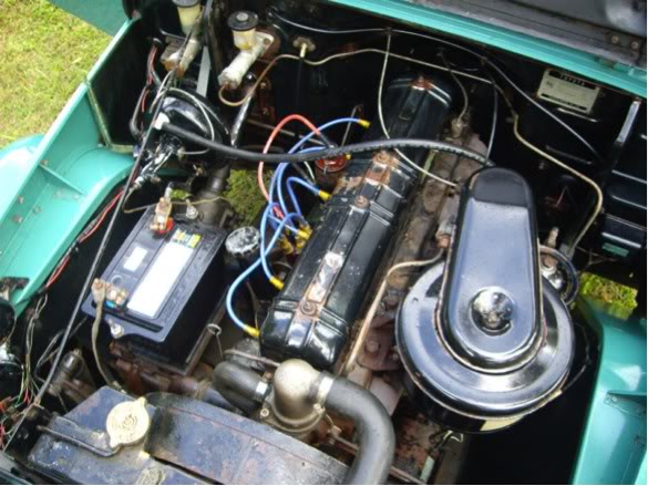

also interested to know if your engine number matches the firewall stamping? i am yet to view a 135 motor that does but the early ones out here are all a bit battleweary. and i in pretty decicated fj45 territory. has each and every one had an engine exchange? or were such finer details overlooked during assembly? assembly where? the lone fj25 ruin of my aquaintance is unstamped on the firewall plate. think aussie25 the same he said from memory.

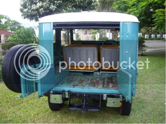

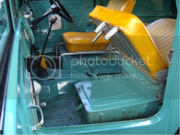

kind looked thru and didnt see anybody mention about the seat color? definitly looks like a redue...especially since the boot it the same color

also look at these pictures...what is this and is it coincidence?

Your right seats look original. the rear seats in the last early FJ40 are still in pretty good shape, Everything esle is pretty much trashed here in the desert.
I'll make a effort to check my 62 and 63 micro-fiche to check turn signals.
Not sure what the mark is on the back. I would have to have better pictures to give a opinion. But you'll the second picture had the handles on the rear hatch to push the buttons in when opening the hatch. This really puts this one as a transition between 63 and 64. More parts are starting to look 64. Better pictures of the front seats will help those changed between the 63 and 64 model years.

just retreating a couple of thoughts i have seen 64 tojos both with and without pcv valves but unsure as to engine swaps over the years. a bit of a rough generalisation but typically non pcv motors seem retain the fj25 manifold stamping.
iol bath air cleaners were certainly available in australia.
