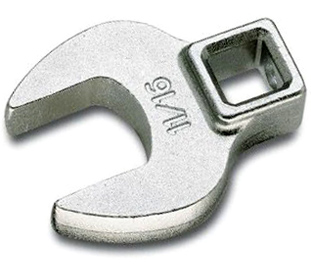

I'm wondering if there is room to use a crowfoot wrench?
You will offend the cruiser gods using that SAE tool on a metric bolt. Be prepared to buy another bellhousing!
I dunno Robert. I actually don't own any crowsfoot wrenches.
I've never owned a crowsfoot wrench either. I don't remember having any real problems getting that bolt out. I may have used a breaker bar that the end swiveled and then cheater on that for leverage. Seems the hardest part was just getting it to break free. Is it still at your dads house? Could possibly find some time in the next couple of days to give you a hand.
Just an example Mark. Only metric on this old FJ40. As a matter if fact all bolts removed during the painting process were replaced with stainless metric :)
