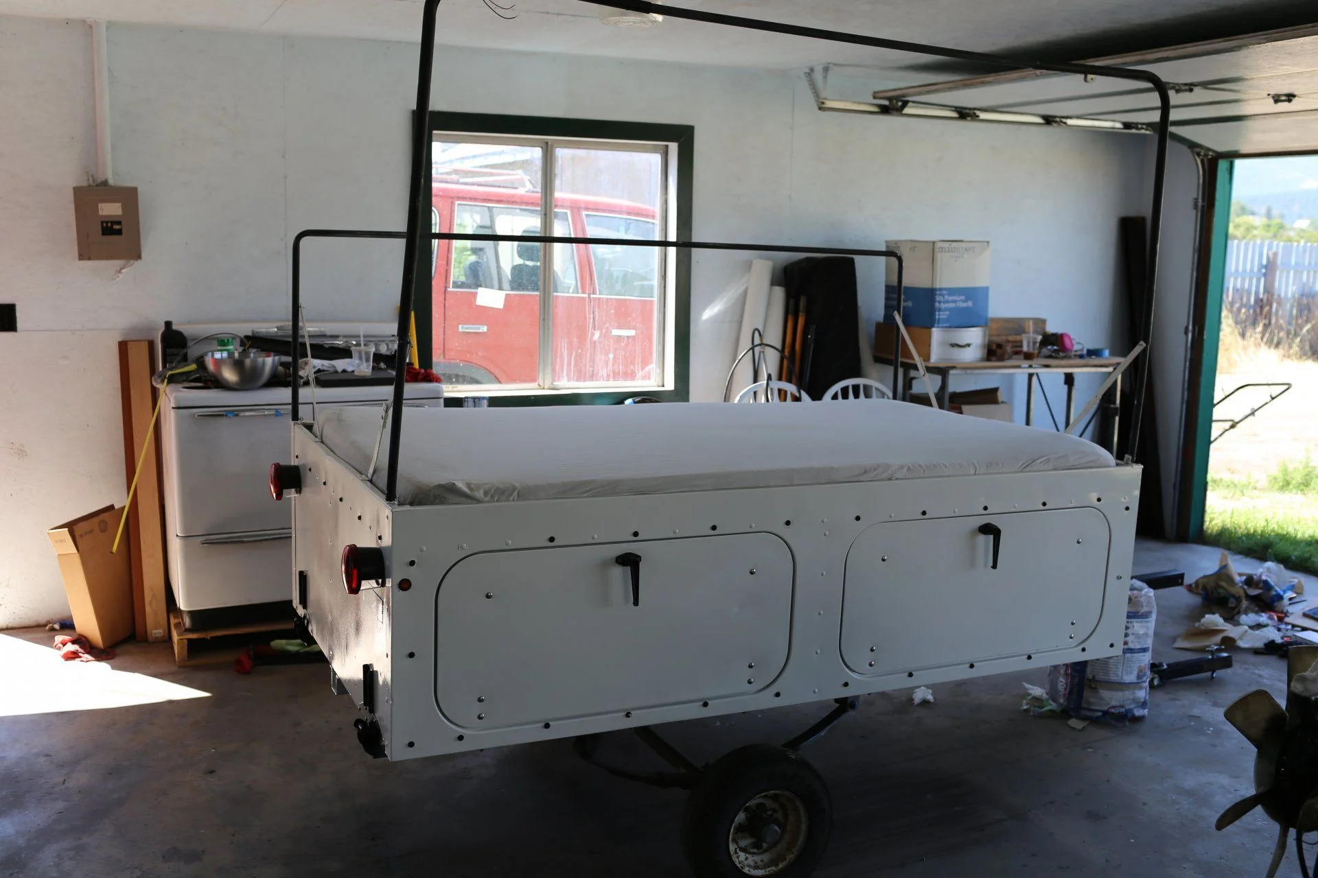

After painting - putting on all the hardware..

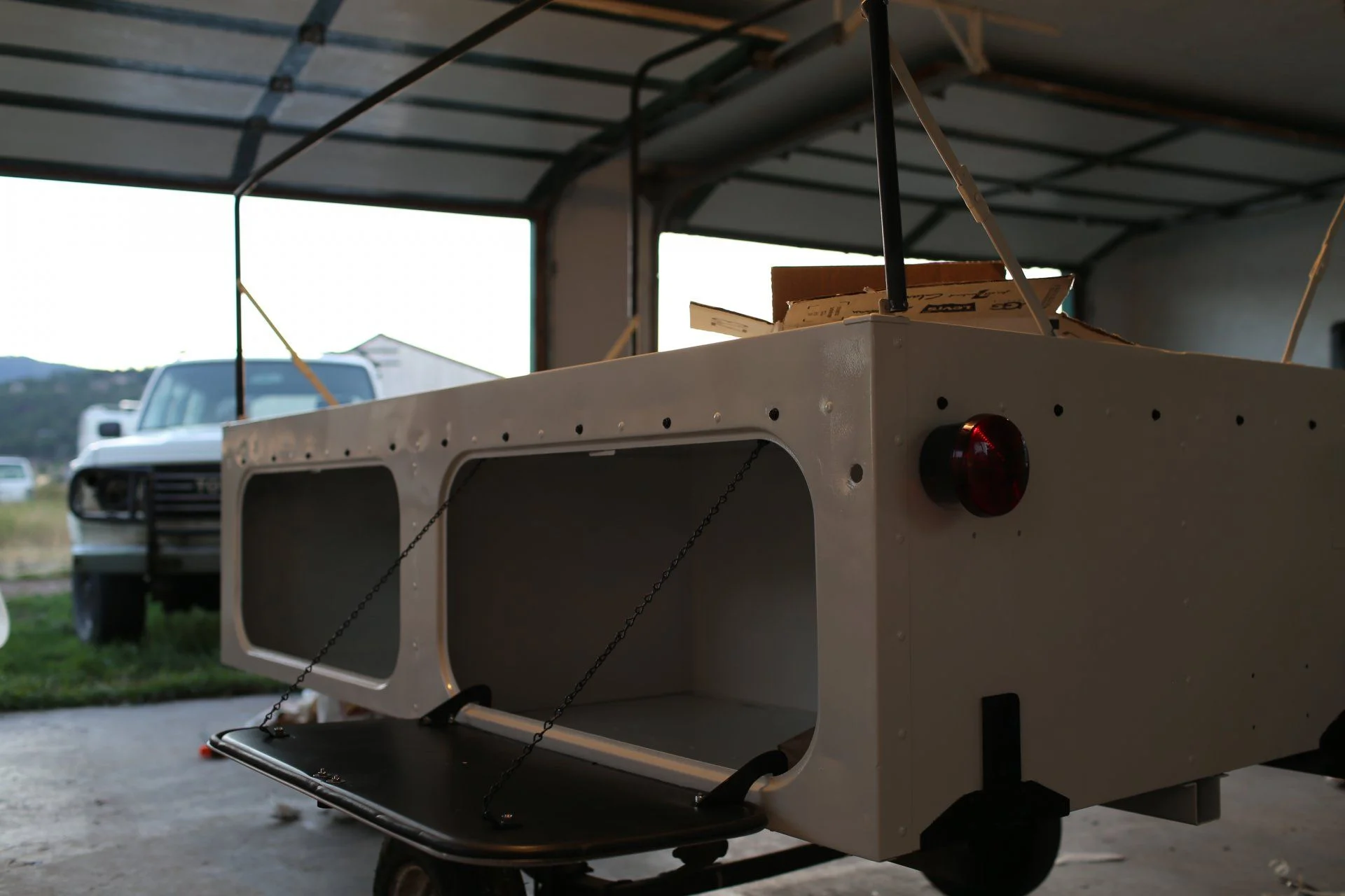

Storage (FJ60 in the background is my next project - it'll be fitted for a 3b and new interior)

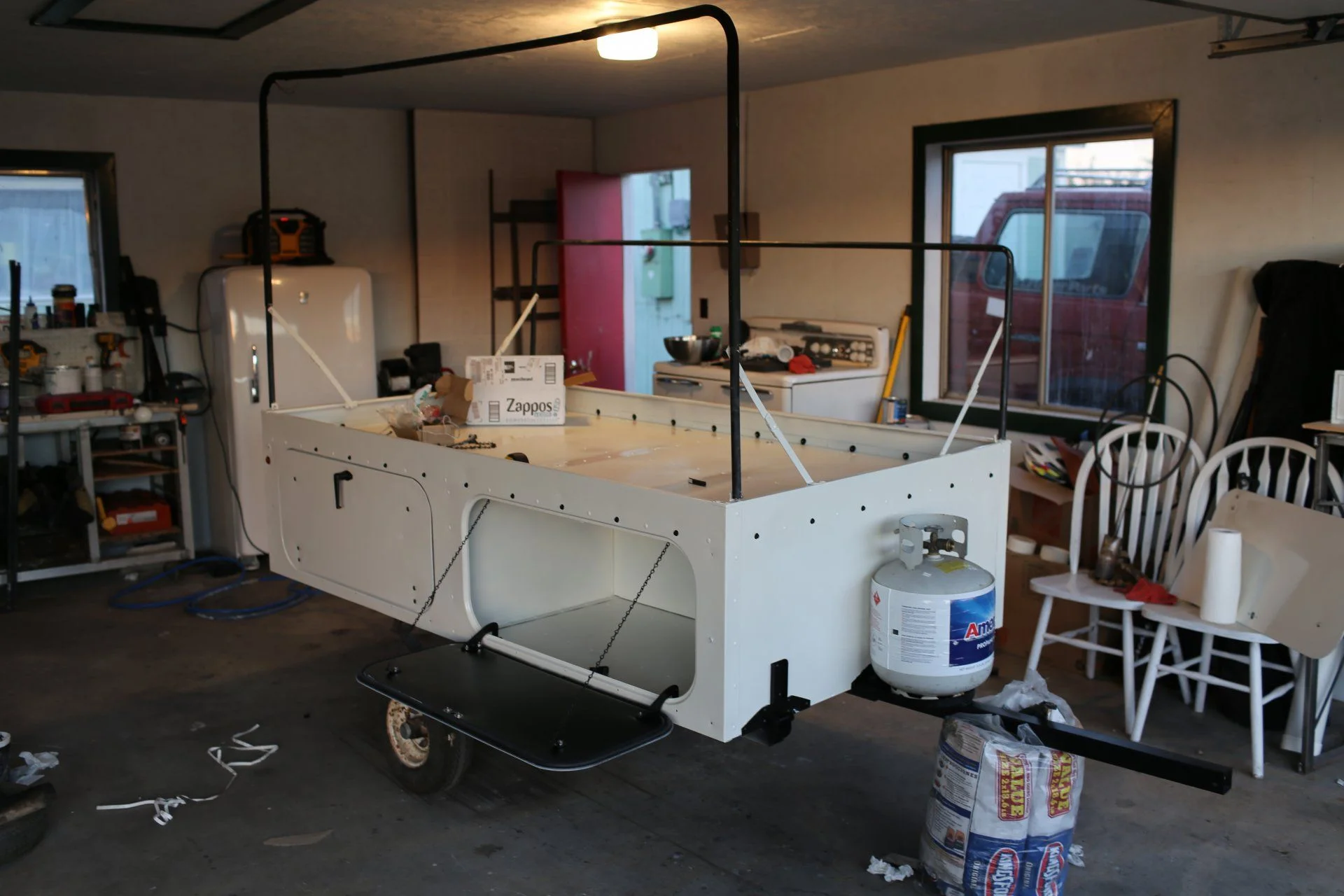

Fits a full size mattress neatly. The foam mattress is comfortable - especially after a long day!

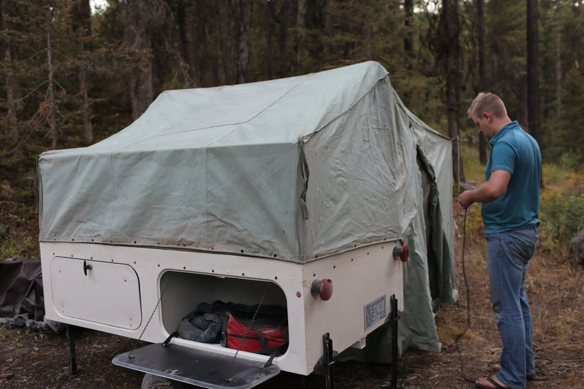

I painted it to match my FJ..
full
Setup normally takes 2-3 minutes, but when you forget the poles at home, it takes a bit longer and ends up looking odd enough that I don't have any other pictures at the moment!
