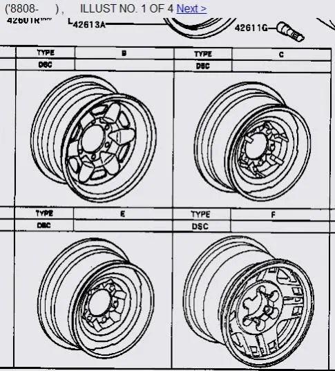

so if #42610-60111-03 grey is the non-clip wheel...i'm wondering if the #42610-60022.03 grey is the clip rim
this picture shows that they did have a clip and non-clip rim for those trucks E being the non-clip and C being the clip rim

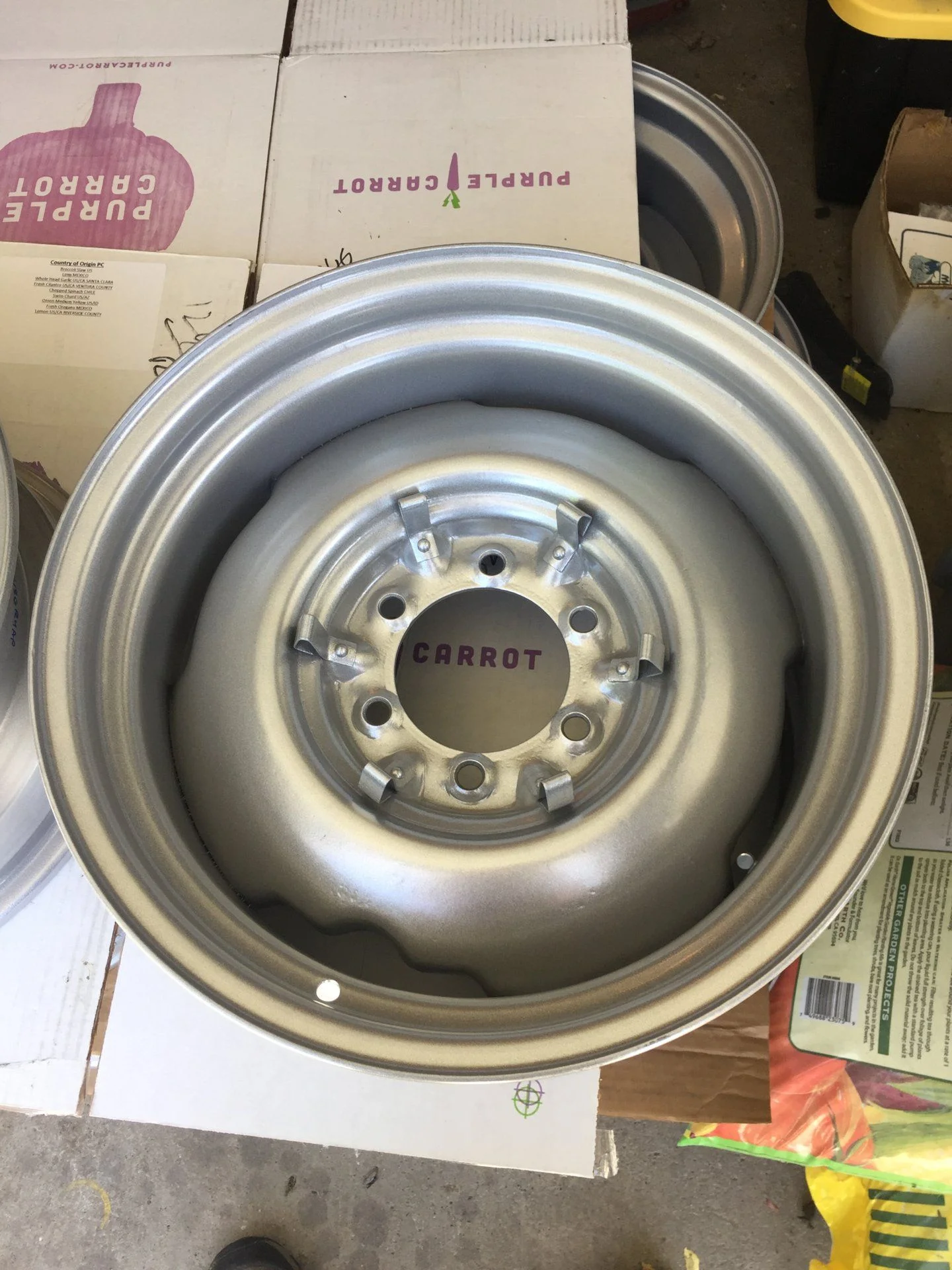

Did this ever get sorted? Australians got 15" one piece rims no clips, 16" one piece rims with clips [I run these on my 45], 16" split rims with clips and 16" split rims without clips.

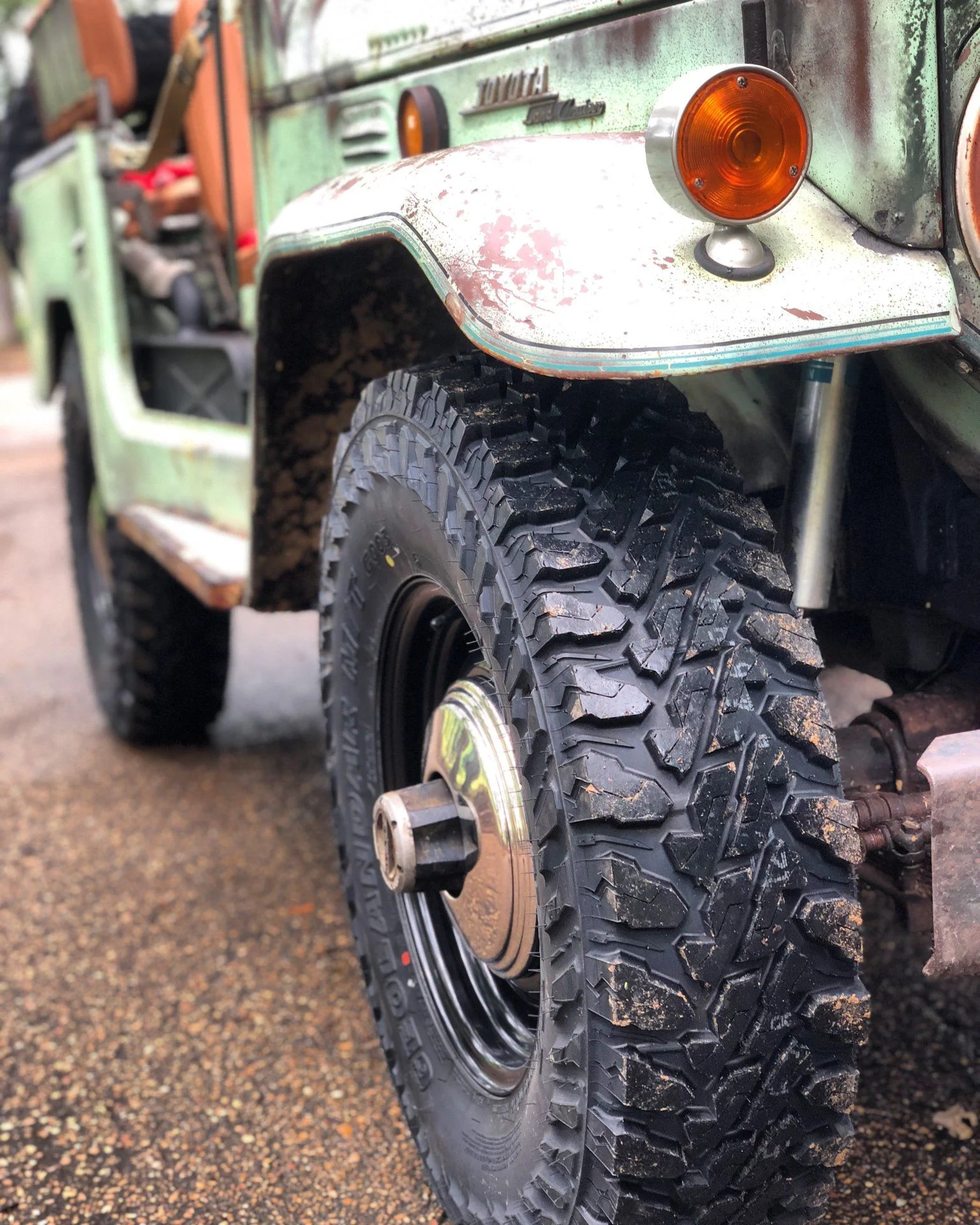

View attachment 1750723 Here is a 16” center that I had Stockton Wheel cut out and weld into a 17” outer, yes 16” splits came with clips not sure what on or years.
Hi mate, I am about to investigate this exact project. Why did you weld into a 17" band and not a 16"? I have found some 16x7 bands, and was going to use a set of split rim centres welded into the band.
