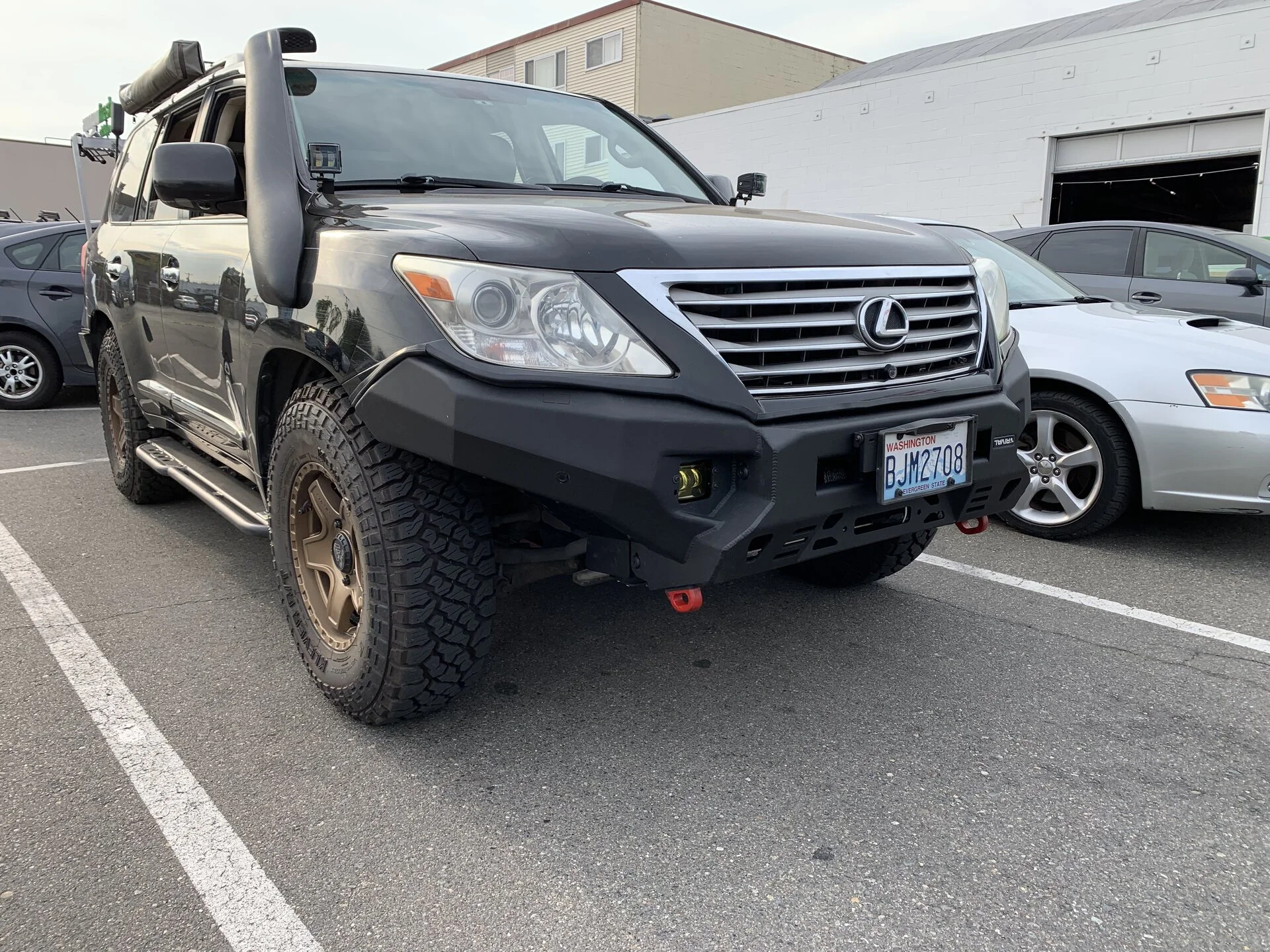

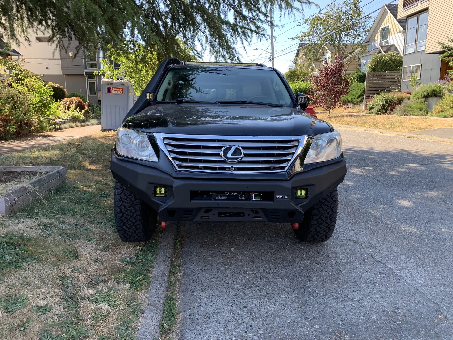

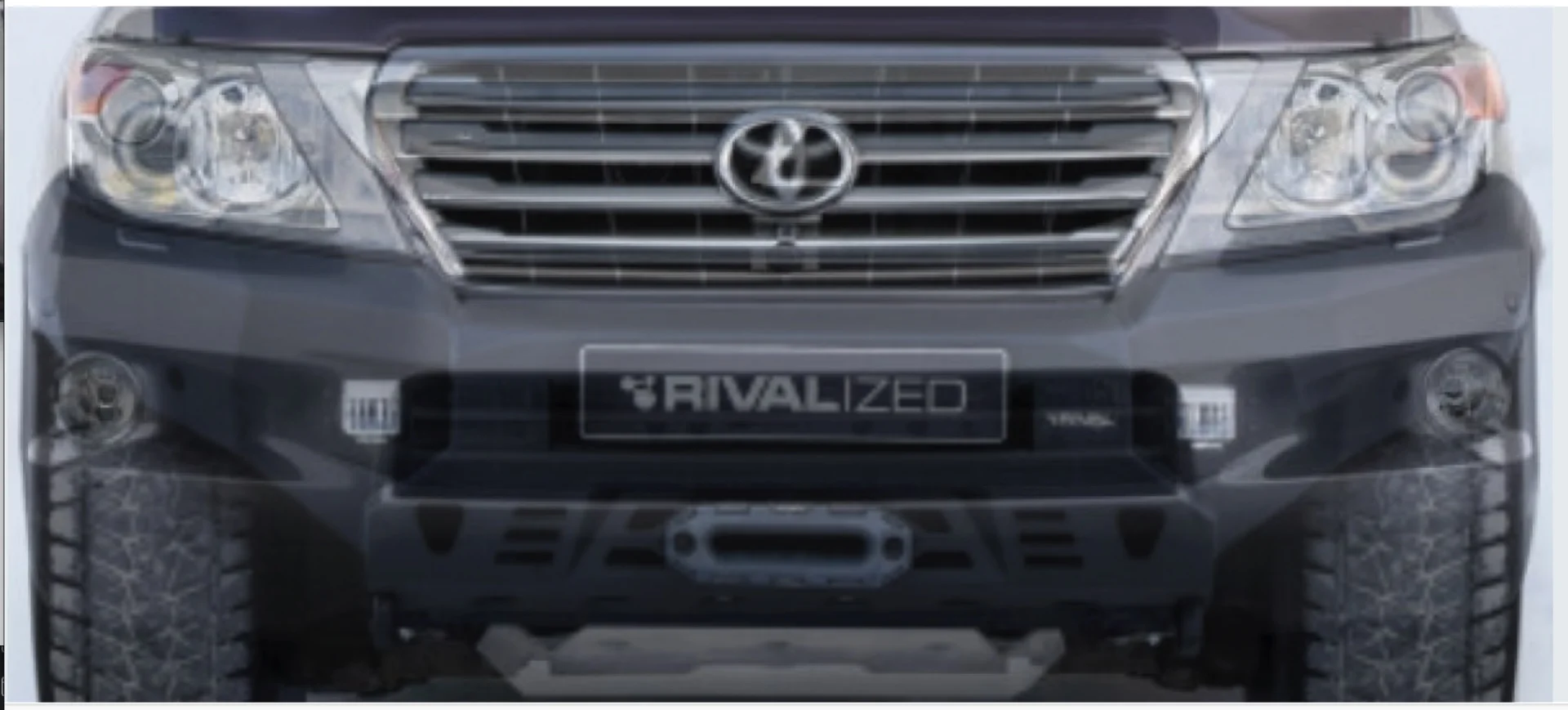

I think it’d be a pretty easy adapt for one of the lc200 rival 4x4 options.
I did a gen 1 using their gen1 lc200 bumper and it wasn’t that big a deal. The hardest part was doing some light fab (hacksaw, drill) to redo the light supports and front crossmember, which many other installs skip entirely.
I found making a composite photo where I overlayed an lc200 with the bumper installed on an lx570 made it pretty easy to see what it could look like.
rival may also have some install photos that they could share with you. . .

Crappy 3 minute photoshop of the Rhino4x4 bumper
You are underestimating the depth of the 2016+ grill. The distance from the radiator to the plastic is significantly more than a 2008-2015 LX or a Land Cruiser. You’d have massive overlap and not in an attractive way.
If you look at @grinchy ’s bumper, the grill goes all the way ti edge of the bumper.
Can a 2016+ LX owner post the distance from their frame horns to the front of the grill? Or to the furthestmost point of their lights?
I believe you. That's my fear and I don't have the fabrication skills to try to adapt a Rhino4x4 bumper on my own. I don't want some Habsburg-jawed LX running around town.

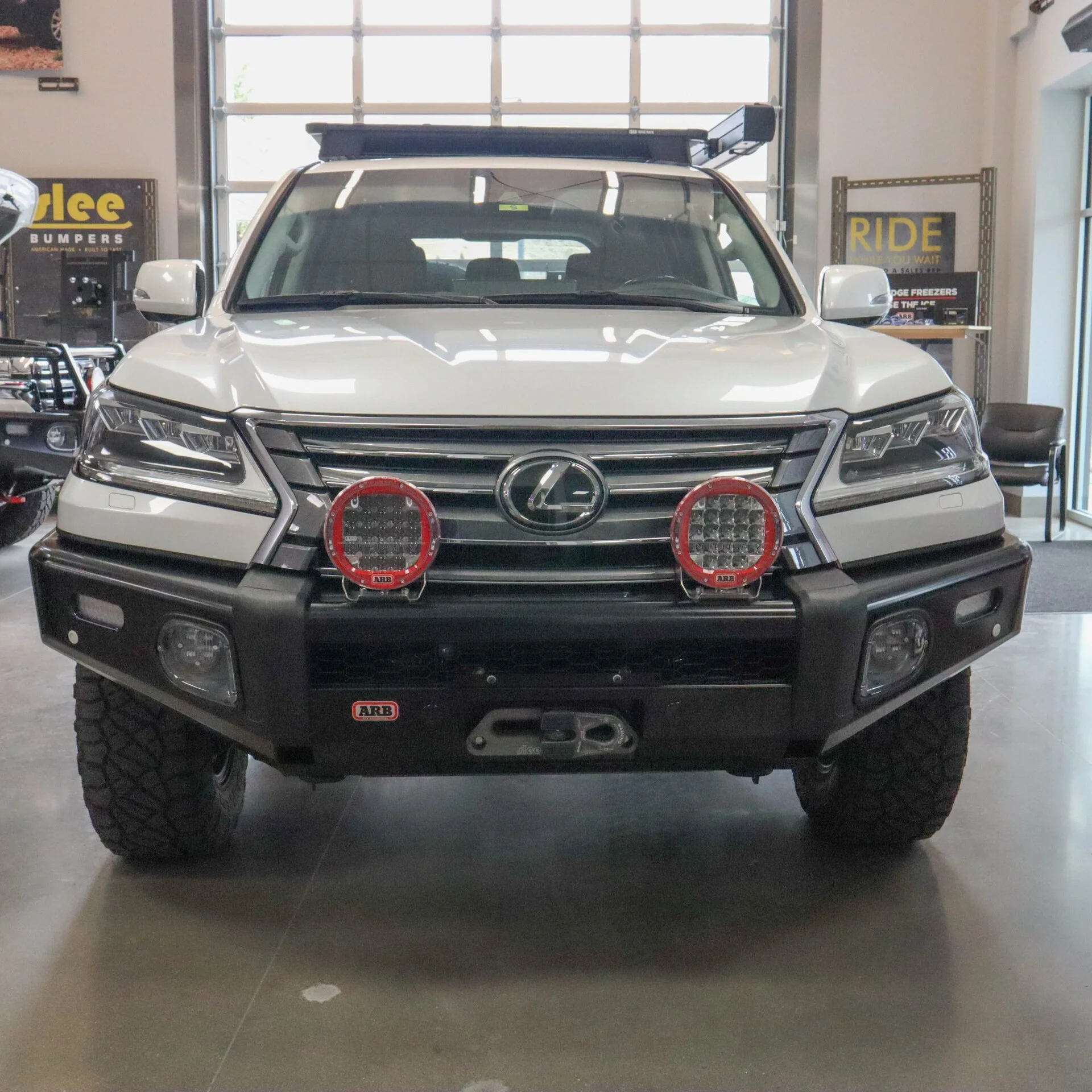

Only b/c it hasn't been mentioned or shown, have you seen how Slee adapted the sahara to this '16+

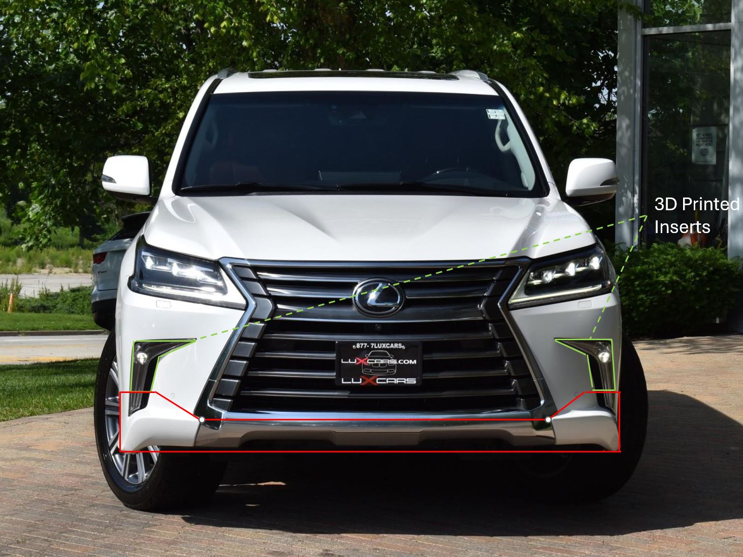

Thinking the same as you, the aftermarket bumpers for 16+ are either too bulky, heavy, or unfinished looking. The CBI is the cleanest one, but hate how overdesigned it looks. I want to have daily driver that looks OEM+ with good tire clearance, not a fully built expedition vehicle. Like how some of the GX guys do a clearance cut, have you thought about doing something similar to the quick MS paint I drawn up?
I agree on the CBI. I also dont know that it really increases clearance much, just some extra protection and the ability to mount a winch.
The fog lights make this hard. I actually have been thinking about possibly deleting the fog lights and 3d printing an insert that fills the hole with a cutout for a more conventional aftermarket fog light, like the Diode Dynamics SS3's or something.
My other concern is cooling. I dont wanna remove so much from the center of the bumper that it compromises airflow through the cooling stack since I do use my LX to tow a decent sized trailer.

1/3 of the grill flow area is gone with that now. Maybe its not a problem, IDK.
Looks like the sides probably increase clearance a couple inches.
Not an issue at all. No more than it is in the standard 2015 and earlier. The lower part is aesthetics more than anything else.
How does that integrate with the "skid" plates underneath? Could you get a pic of the underside?
