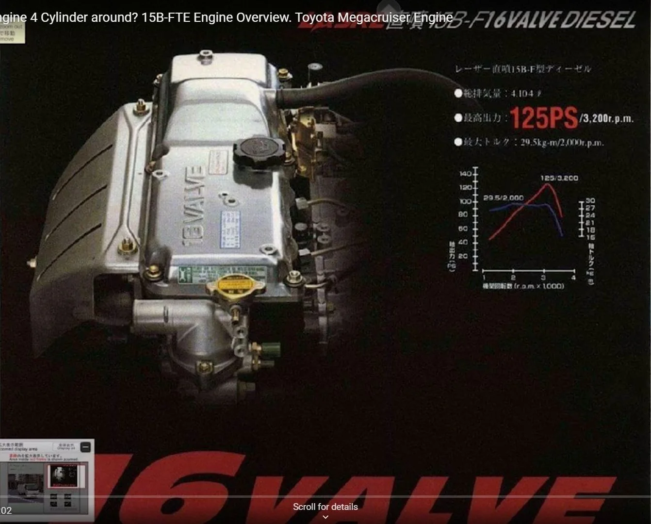

Saw these in a youtube video, so copied them out to post here. I'd never seen these before.... Would be neat to find the source documents and translate to english.
15B-F
15B-FT
15B-FTE
They really fall over at 3k don't they
I remember @Dougal commenting on that in another thread. I think it is a combination of things, but partly the diesel can only burn so fast in a large cylinder with a long stroke. Also, direct injection engines generally don't rev as high as indirect injection. Add to that these motors have the small CT12b turbo which likely runs out of puff pretty quickly on such big displacement. Finally, these motors are designed for commercial and military truck application. Most diesel engines in those types of vehicles are similar high torque low revving motors.

The torque dropping off at 3k rpm would probably be the governor starting to reduce fueling. There's been at least one thread on the 15b Facebook group where it's been said they suffer valve float issues at 3400rpm and above. Which is why peak power is at lower revs than the 13bt. (On the 13bt peak power is 3400rpm, and that's when fueling starts to be pulled back)

And 4.1 L displacement on the 15Bt is not really that big for bore and stroke. The cummins 6 cylinder is similar.

Yes it's the burn speed of diesel vs piston speed. Interestingly my Isuzu 4BD1T and VW 2.0 tdi hit peak power at roughly the same piston speed.
