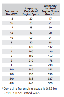

I might have just missed it, but did you run a new charge ("B") wire from the alt to battery? If not, that seems like a recipe for disaster. I replaced my B wire with a new 1/0 through a 200a breaker.
IMO you should reduce that breaker size, 1/0 can only carry about 130....ish amps depending on construction material, this means the cable would burn in a short before the breaker tripped, unless I missing something?

Wire Size (AWG)Copper Conductor Temp. RatingAluminum Conductor Temp. Rating
14*20A25A
12*25A30A20A25A
10*35A40A30A35A
850A55A40A45A
665A75A50A60A
485A95A65A75A
2115A130A90A100A
1130A150A100A115A
1/0150A170A120A135A
2/0175A195A135A150A
3/0200A225A155A175A
4/0230A260A180A205A
Just come across this guide, I thought 135 was about right but that is maximum for Aluminium cable, so if you have copper cable then that is rated around 150 - 170, so sorry f I gave you a heart attack. Given you are not going over 150 amp you could have used AWG 1 but I too am for overkill so agree with your choice or even gone heavier. I see the circuit breaker being the issue, a 200 amp breaker may not actual trip much before 250 - 280 amps, as it is the cable you wish to protect then I would consider a 130 amp breaker, as breakers tend to 'hold' longer than fuses, and the fact that your unlikely to need the full output of the alternator for more than a few minutes that may be the way to go? Or perhaps swap the breaker for a fuse of around 140 amps, they tend to tolerate a higher amperage of around an additional 5 -10 %, again fitting in nicely with the short period of time you expect to see full alternator output. Or if you insist on a breaker then increase the cable size to 2/0 so plenty of flexibility in your choice of fuse or breaker.

Pretty sure Ancor 1/0 is rated above 200a in an engine bay, but I’ll need to double check that.

I'm not opposed to increasing the cable size, but per Ancor:
EDIT -
Interesting that the table I found above has different ratings, I am not familiar with ratings outside of Europe but the tables are way different. In general a cable inside an engine bay has to be de-rated due to heat.

I always go off of the manufacturer that is producing the cable I'm using, not all cables are built to the same standard.
