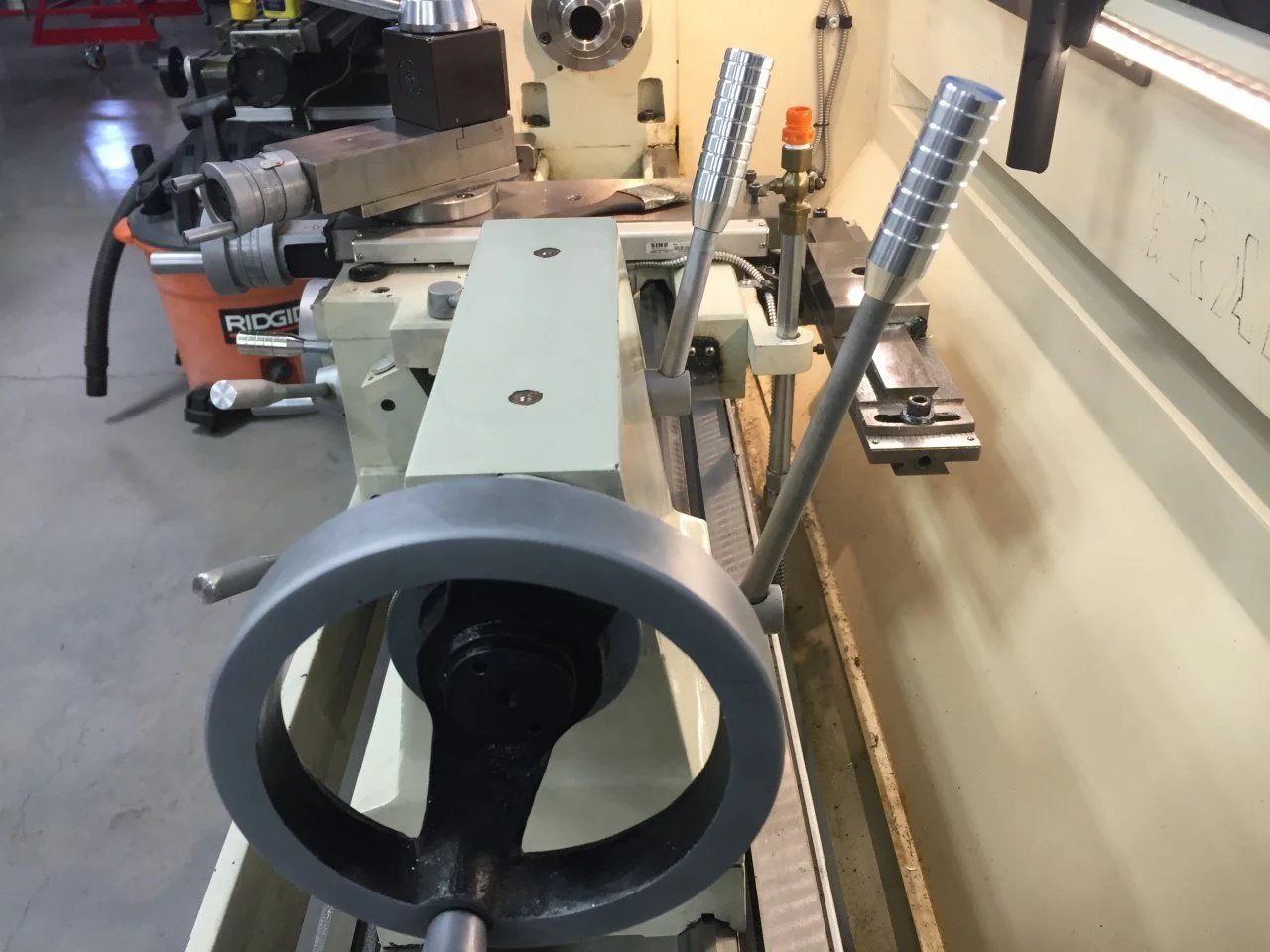

Turned out new lever knobs for the lathe. I always felt the original plastic knobs felt small and cheesy. I used 7/8" aluminum and 17º on the taper with a drilled/taped for a10x1.5 thread. The treaded end was also counterbored for a flush look once installed.

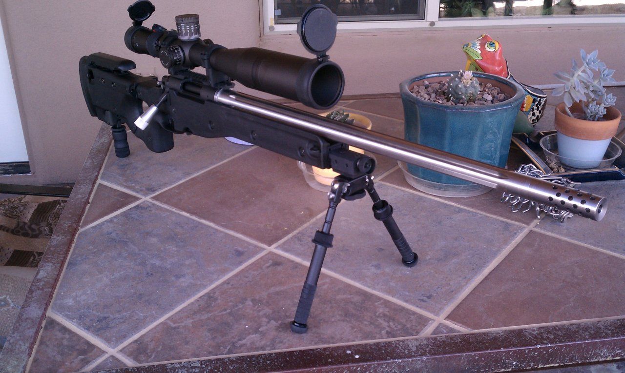

I done a fair share of rifle barrels both turning and threading at receiver end as well as business end and always check prior to ending up with an anchor. I blue printed this action and barrel on this .308 precision rifle. The barrel is a Mike Rock 5R SS cryogenically treated fluted barrel and it ran me a pretty penny, so yea, I was s***ting bricks during the 30+ hours of setup and machining. The rifle hits a 10" dinner plate at 1K yards and at 516 yards I can cover three shots with a quarter after completion of build.
The compensator was build by me as well. Its loud as hell but has almost no muzzle rise behaving like a .22. I also have a Ti suppressor that can be slipped on bringing the decibels down to around 74 but tends to pull the groups down and to the right. The groups actually tighten up with the suppressor but you lose your glass acquisition between rounds unlike the compensator which keeps the glass in target.
Sorry man, I'm easily distracted by weapon conversation haha!
That is one sweet .308 - great job on it . Wish I still had my eyesight - used to love sport shooting/hunting and really miss my semi-custom 25-06 , that thing was fun .
