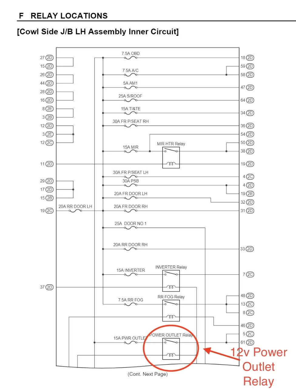

I checked the wiring diagram and realized that there is a relay in the main body ecu (cowl side l/h junction box). I found this in the wiring diagram of the inner assembly of the junction box (pic below).
Since the fuse is fine, and the port is also fine I suspect that the relay is the culprit.
Does anyone have experience fixing this? Could the problem something that I am missing and not the relay?
Does anyone know if I take out the junction box, will I be able to open it and replace the relay?

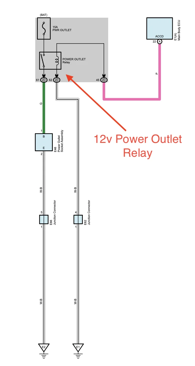

Wiring diagram of the 12v power outlet:

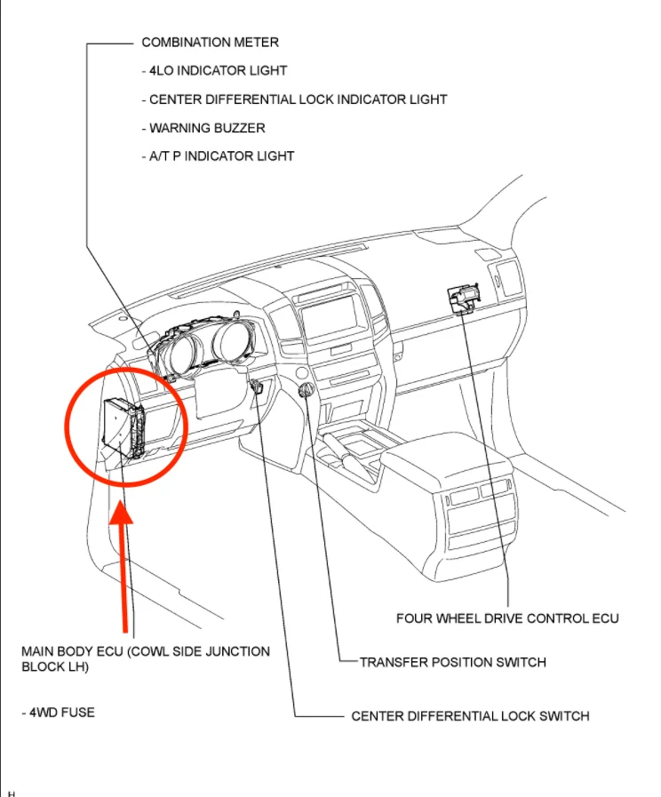

Location of the main body ecu (cowl side LH junction box):
Wiring diagram of the inner circuit of main body ECU:
