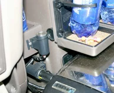

Did you consider mounting the plugs on the back of the console? Easy to do and looks clean. Wired to the battery via a fused terminal block so the kids dvd player doesn't shut down when gassing up.
Good points, Wasnt trying to jack your thread or dis your mod. We make our rigs our own as we see fit. I simply chose to mimic a configuration I have seen in some newer non toyota suv's. There is space in the outer shell of the center console where the plugs wont intrude into the usable interior well but will still be above the heater vents. I used a west marine dual socket with the flaps. i saw a similar installation in a rotw.
Yea, I saw that thread too which is what got me started searching the WestMarine site. Once I saw those shiny ones I was hooked.
"Wasnt trying to jack your thread or dis your mod"
I really never thought that at all. I just answered your question. I wheel with my kids most of the time and they're in and out constantly with muddy boots and such. My CB has taken quite the beating over the years hanging on the back of the center console. I couldn't see power cords lasting more than one weekend in that location.
