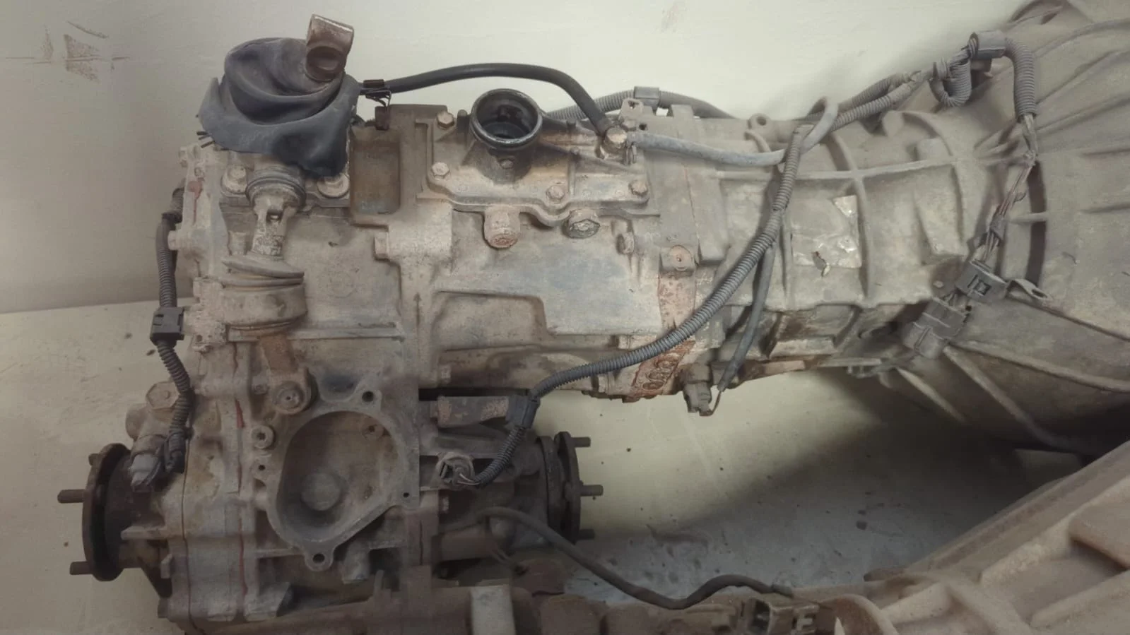

A friend of mine sent me this:

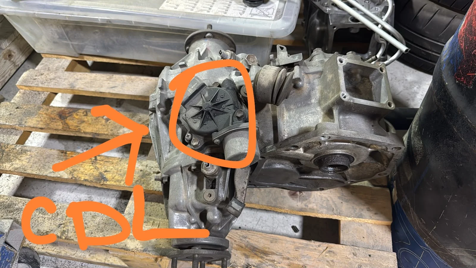

Now the ones with the CDL, I think, have the actuator motor. Like this:
you can have CDL and part time at same time and it will look exactly like the last pic you sent
Yes the truck left the factory with a center diff but the truck will move regardless of my CDL selection. I have the case out now and I think it might just have a spool in it. Haven’t taken the case apart.
