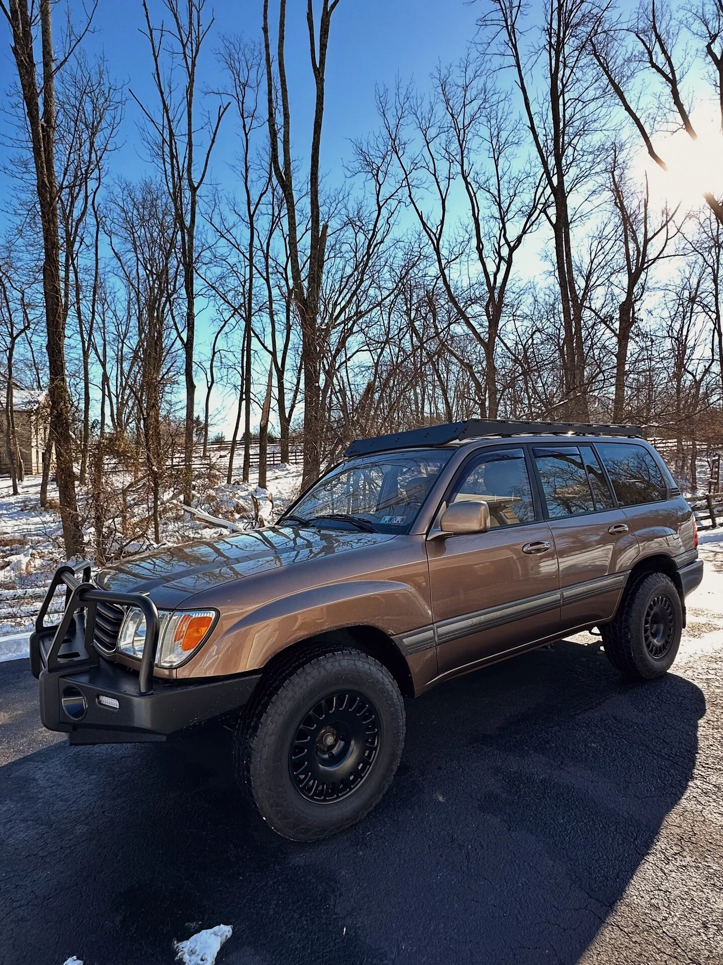

I ended up going 265 70 R17 with Zero Offset wheels. They fit without rubbing UNTIL i put the winch in my front bumper. I now get some rubbing on sharp turns.
Looks like I’ll be swapping the suspension sooner than expected!
If it rubs after the added weight of the winch, just crank the t-bars on each side a little.
Good looking wheels!
I'm sure you know this, If you crank the torsion bars, make sure you get a front end alignment afterwards.
