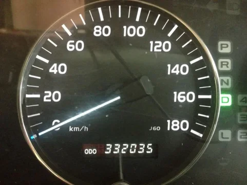

Officially broken in.
That puts me 6,317 miles ahead & also recently broken in...
