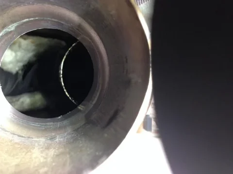

I helped a friend install the catback setup in his lx470. It seemed to absolutely suck all the power. Engine would spool and it made very little power to maintain a constant 35 up a slight hill. Seemed it was a 4 cylinder or like it was pulling a 5000 lb load. We took the muffler off and looked inside- I am guessing it was muffler design, but you can see the insulation inside. Almost like it was blocking flow. Is this expected ? Does the ems take away power when a silencer is added?
Pics attached.

I do not have any experience with the silencer but it does look restrictive. Other members have had good results with their 100's and 80's with the Moroso SpiralFlow. Your friend may want this section cut out and replaced with the Spiralflow.

thanks for the good luck.. he picked up a new magnaflow and will install it tomorrow into the new system. he doesn't care about the sound, nor do I.. i think the main aspect is getting the restriction sorted out; seems like an internal failure/restriction.. It may also serve to be a loss of money for the replacement if the problem is elsewhere, but that seems to be the only change to the lx.

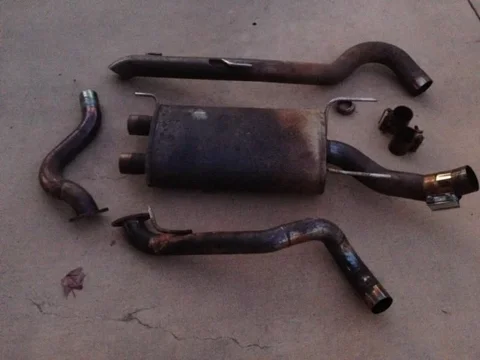

Turns out problem was the ems muffler was faulty. Internals were buggered and craftsmanship doesn't seem comparable to the magnaflow. Here is an interior pic of the ems.
My question- what's with the exposed insulation? Interior isn't nice and rounded where the metal baffling splits. Just seems cut and jagged. I have no idea if that makes a difference bit the inside of the magnaflow looked significantly better built.
Anyways, everything buttoned up and he threw the ems parts away and is better off. Power back, sound good and quality built.

I don't think he was even bothering with trying to get a reply to ems. Service has been demonstrated to be inconsistent and communication not there strong suit. Parts were to be garbaged, so I asked to take the muffler and will cut it open and post up for others to see the interior quality of the ems muffler. The fit is wrong as well; the muffler should have an exit on the back on the drivers side of the exhaust, not the Center. It interferes with locker airlines and hits. Anyways, when I get around to it I am happy to share craftsman ship of the muffler, which appears to be something hobbled together in china on the cheap.

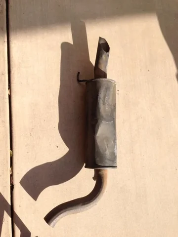

The ems muffler shown in this link is compressed and bent. I thought it was peculiar as the muffler on my buddies lx did the same thing in the same spot; required another acquisition of another muffler. Either the hangers not in the right place, muffler the wrong size and it gets damaged. the fit overall on the cat back is tight; to keep it from banging on torsion bar and driveshaft, the tubing has to be massaged (read, bent flat in spots with a hammer).

I guess I was not one of the lucky ones that received a MagnaFlo muffler with my EMS cat back exhaust back in July. The inside perforated baffles have completely separated from the housing. Still waiting on EMS to warranty the part, which they claim in an email that they will. It's been three weeks and now they're not responding to emails or phone calls. I would also suggest to anyone that has one of these to check the pipe that snakes over the driveshaft. Mine was rubbing under full compression. I put my stock system back on and couldn't be happier. Don't miss the drone and really don't feel the increased horsepower gain was worth the trouble.
