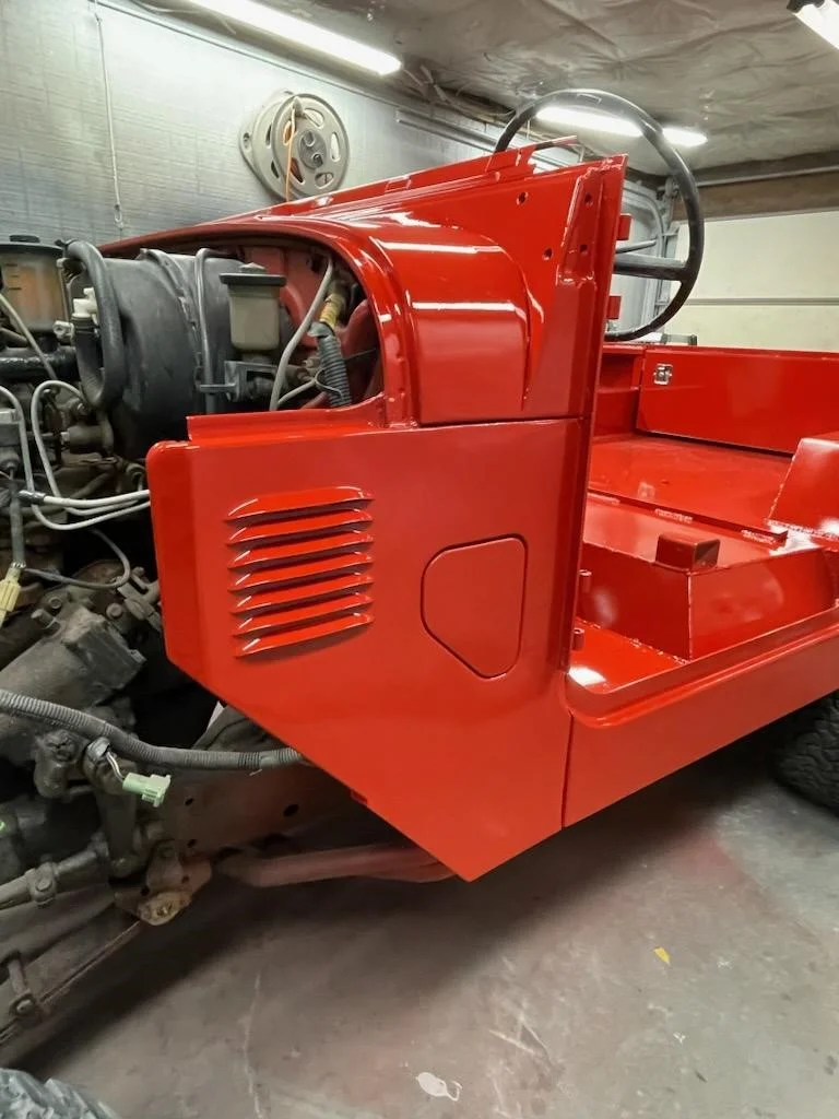

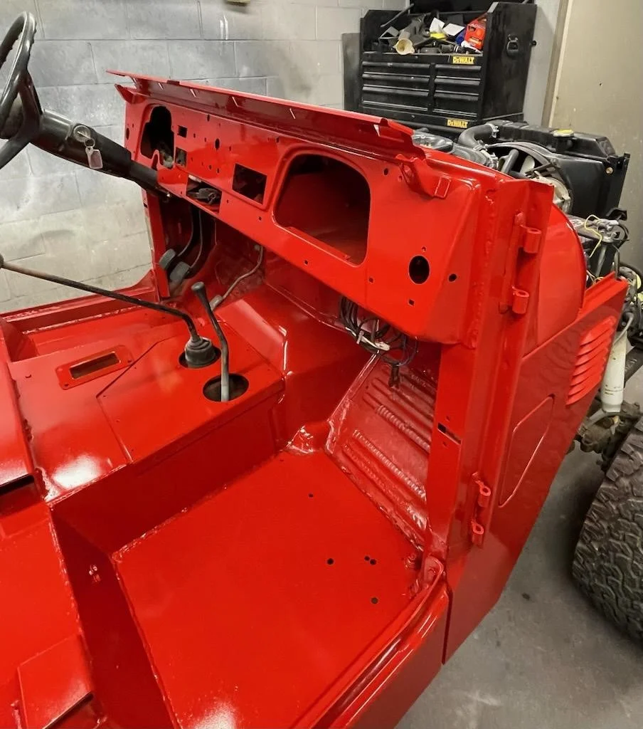

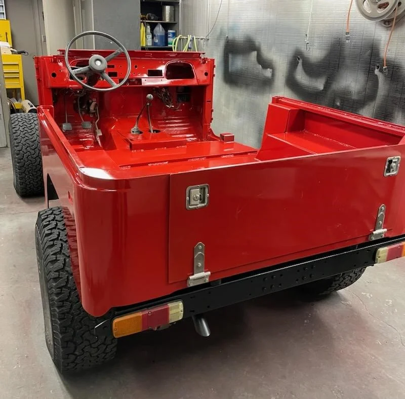

After a brief stay at the paint and body spa (since March 2021), paint has actually been applied. Big improvement! Hope to pick up most of it next week!
Stay tuned for reassembly pics (but as usual, please don't hold your breath).

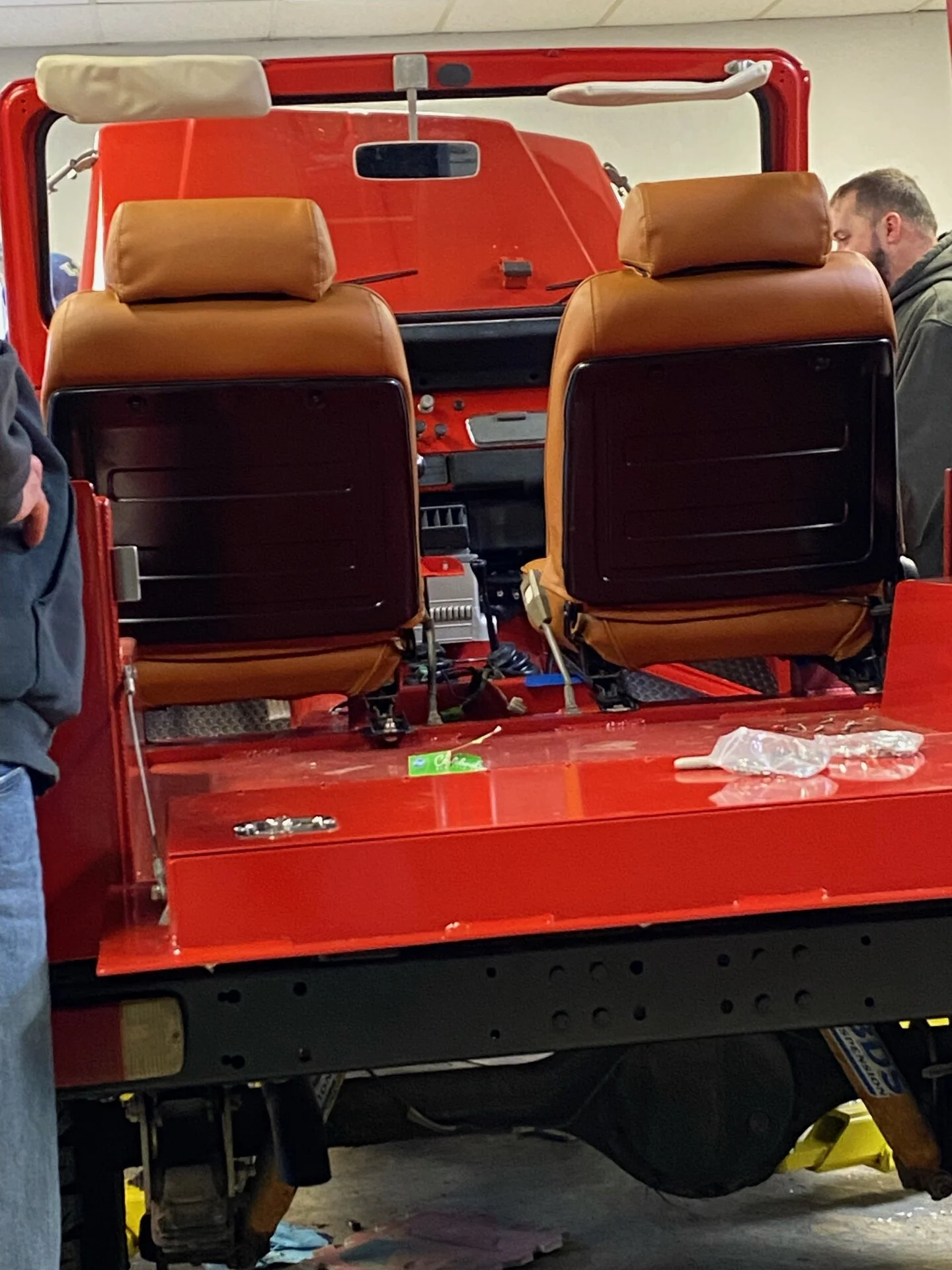

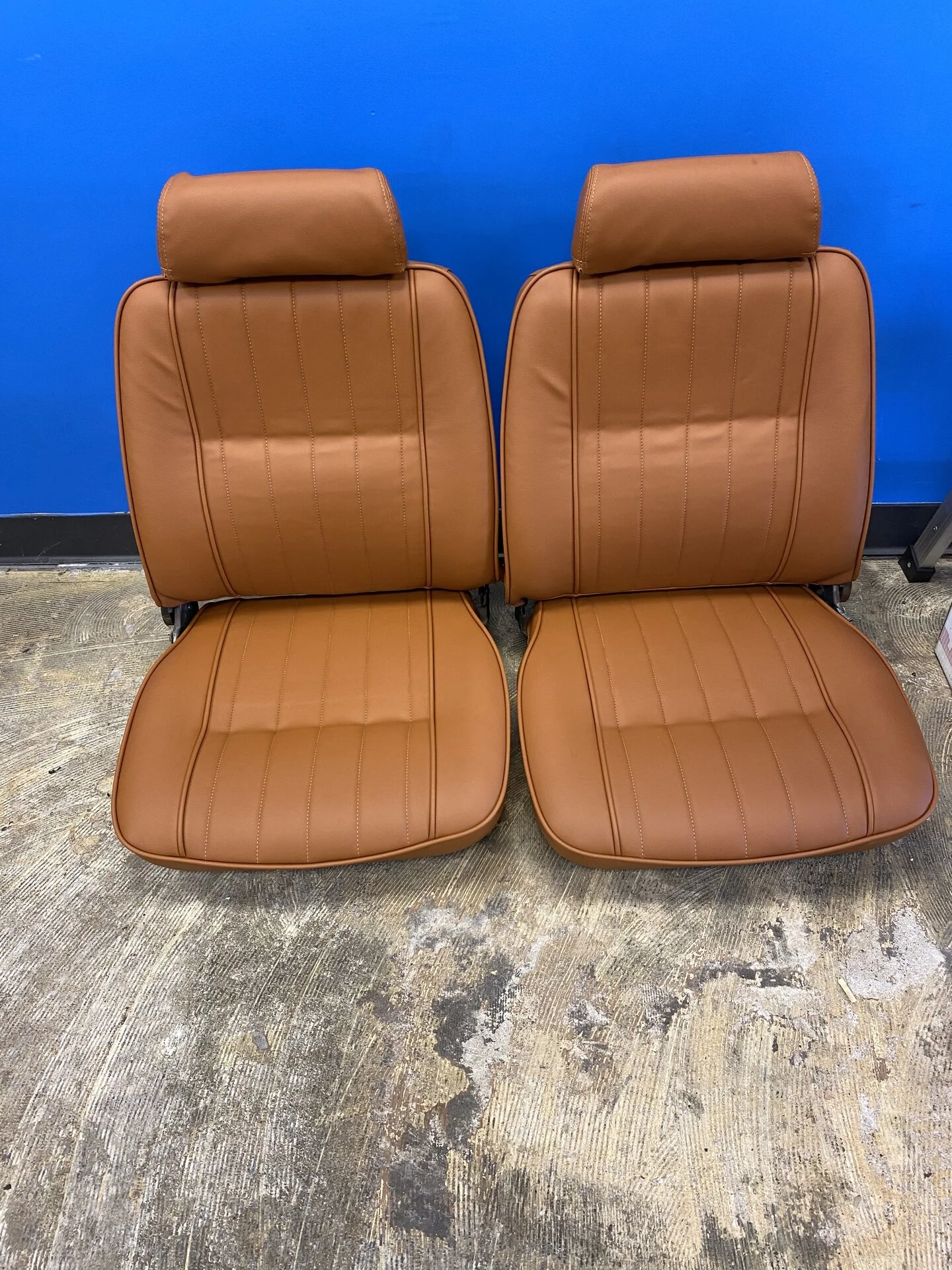

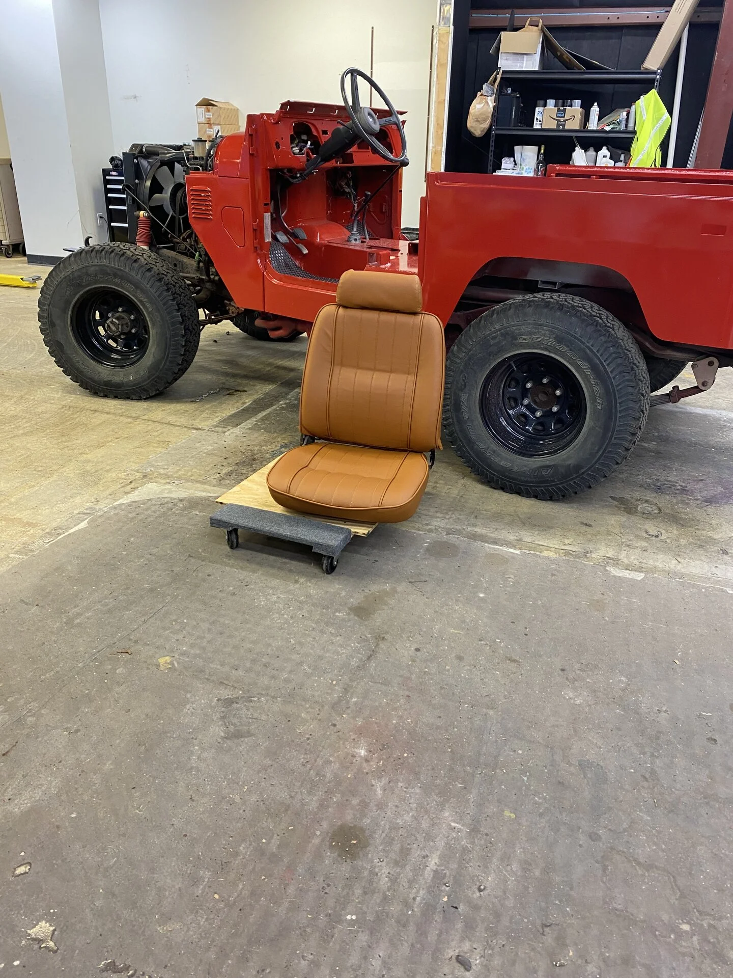

Anyone have suggestions on where to source seat covers and foam? I tried searching but could not find anything helpful.
Anyone tried the Cruiser Corps coral covers? Thought they might look good with the red. The photos on their site look tan but the name coral throws me.
Thanks in advance!
Thanks in advance!
Great question, as "Coral" I think of a almost red color, but if you look at the pictures, it almost seems like a light brown with a red tint... very deceptive color in my opinion...
AW
Thanks for the link! After additional searching, I have decided to go with Cruiser Corps coral. I was worried about the headrests not matching but finally saw that they also sell the covers. Will likely also replace the seat bottoms with foam from Specter. I will post pics once I get the seats back.

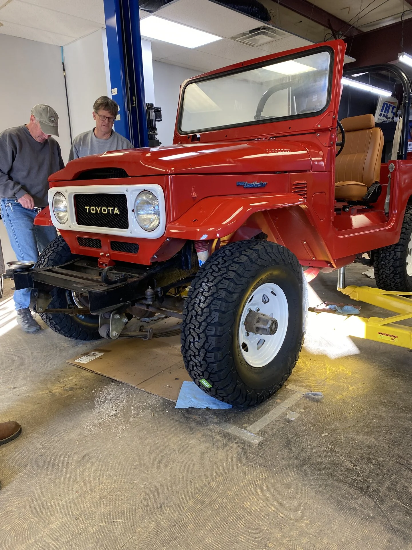

I have attached a photo for interest and photos of the seat covers so folks can see what the coral covers look like with Freeborn Red.

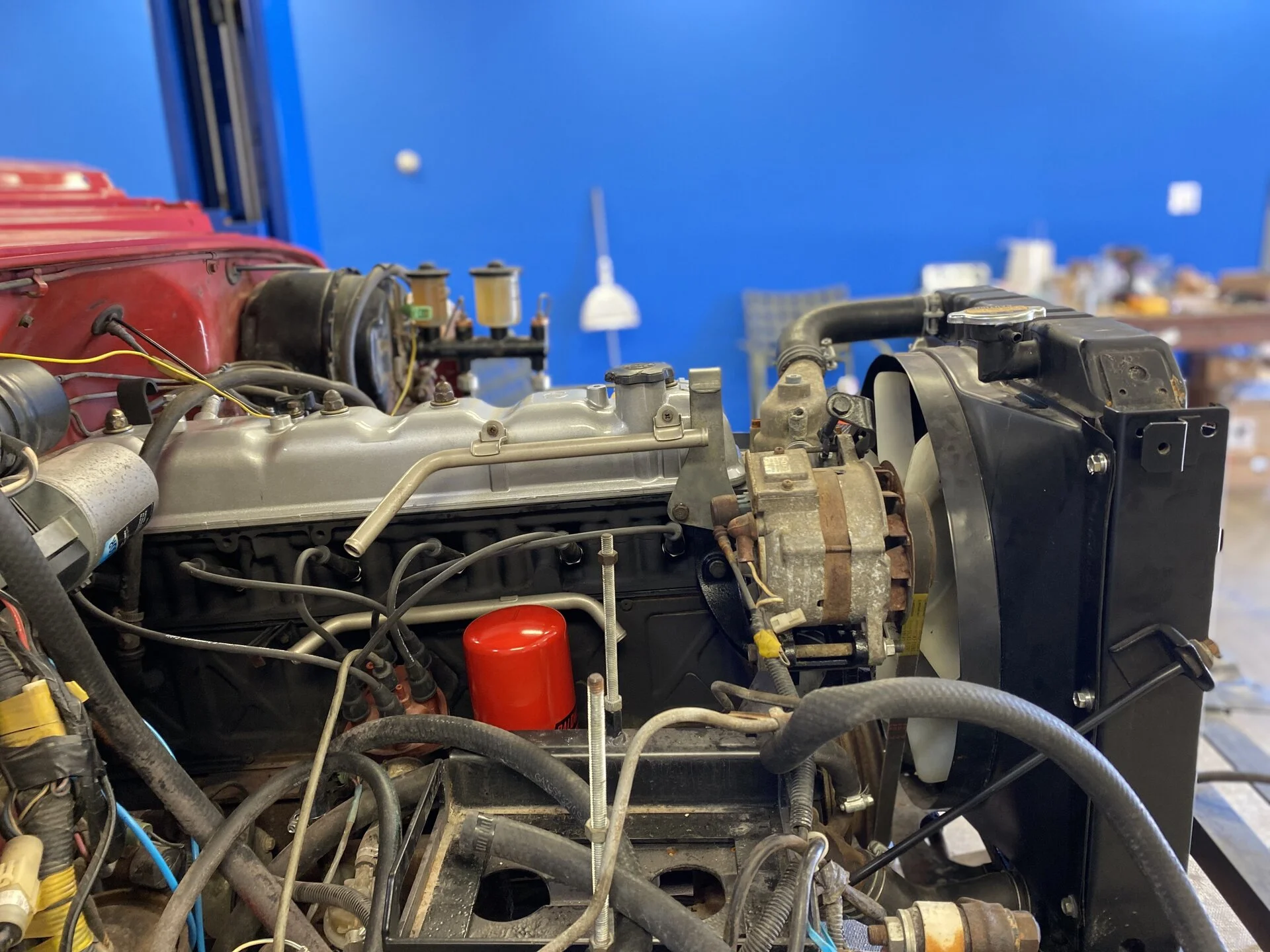

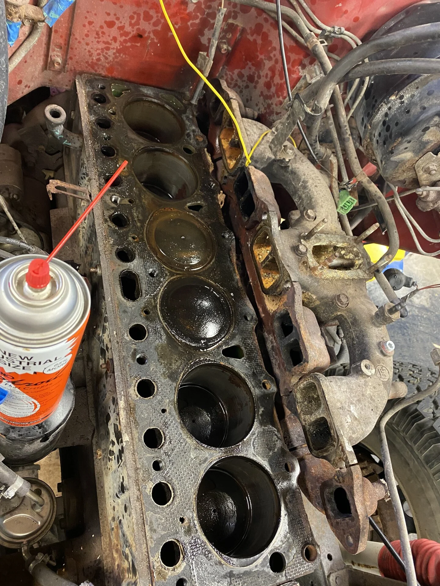

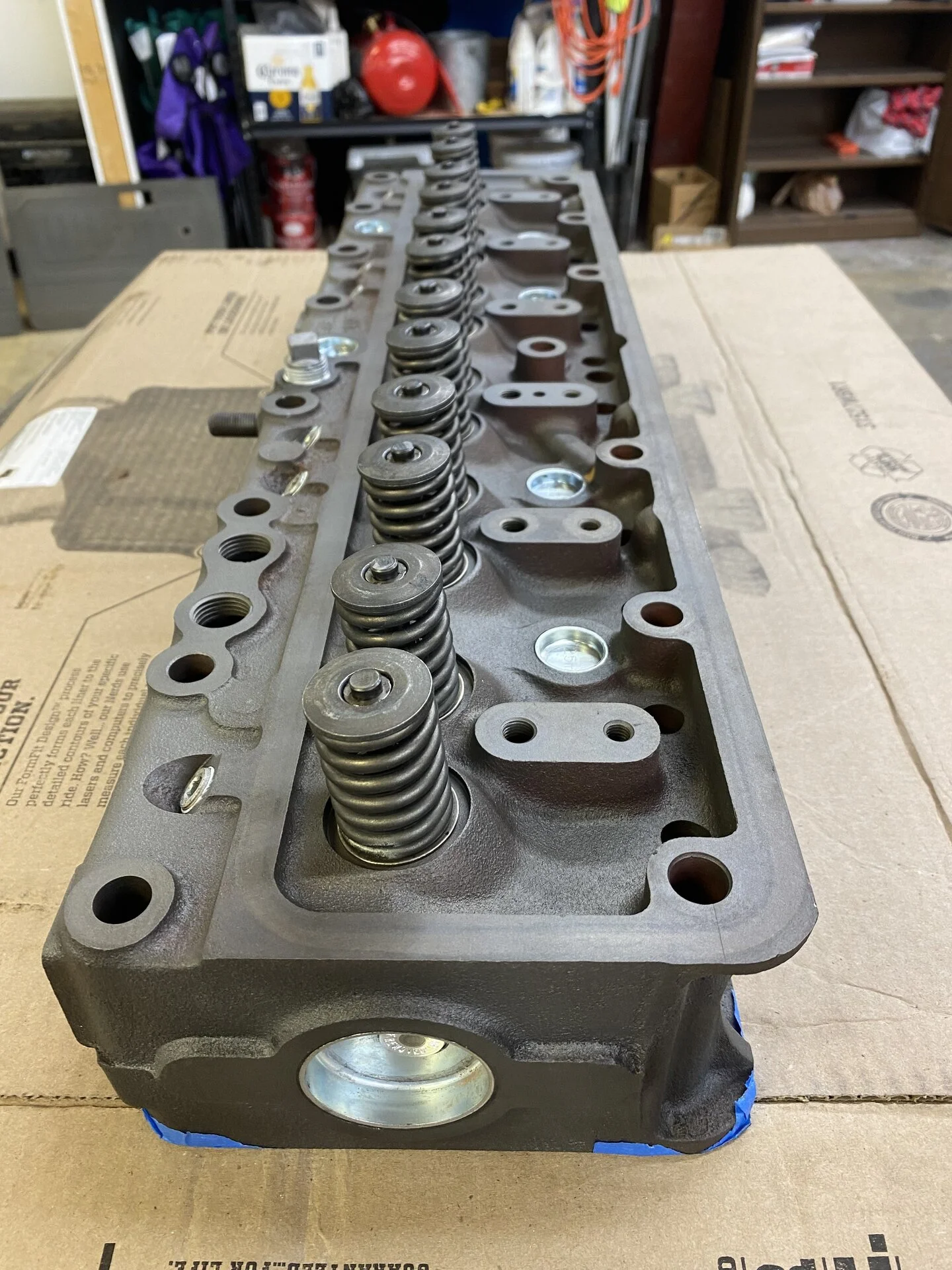

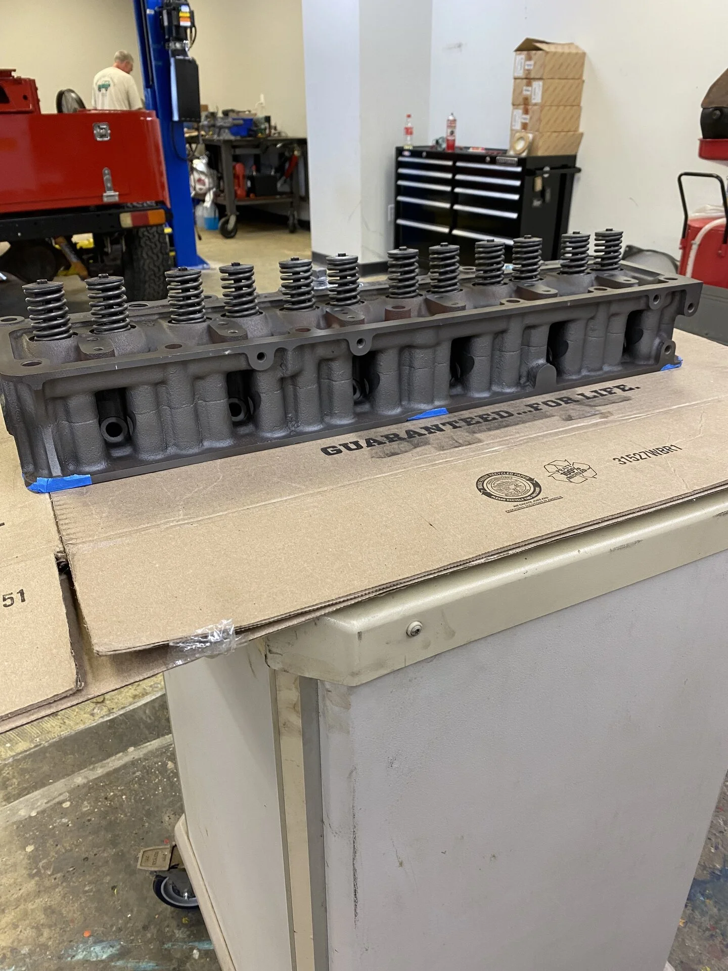

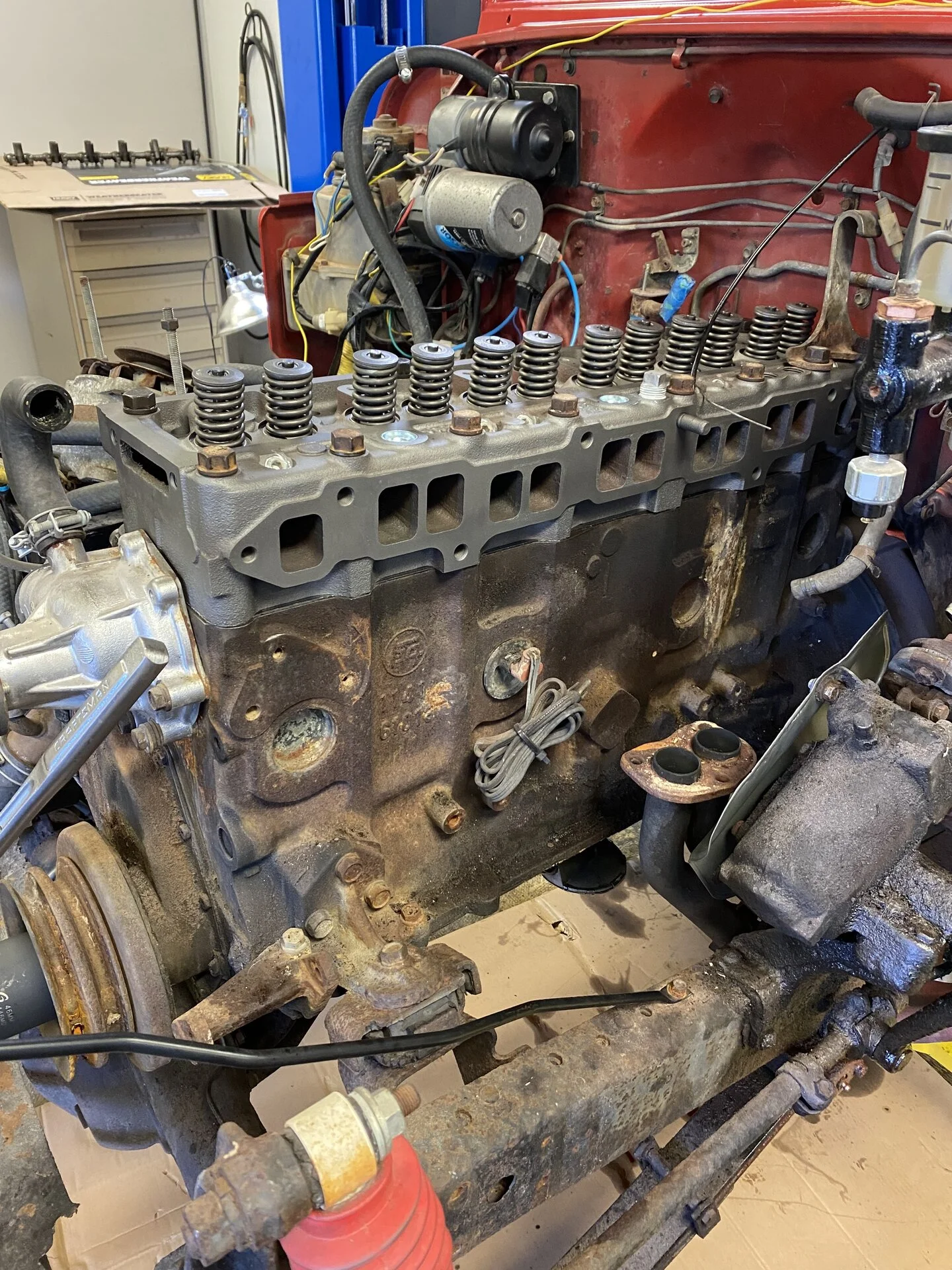

After retrieving the 40 from paint, we were stumped when we could not get it to start or even turn over. Turns out, that while sitting in the painter's yard under a tarp for two+ years, water had entered the air cleaner, carb, intake manifold and unfortunately, the engine. It was locked up.
We removed the head and let penetrating oil sit in the cylinders for a couple of weeks. Fortunately, only the piston in cylinder six was seiezed. We got it freed up and determined all the rest were okay.
We removed the pan and the pistons to confirm the condition of the cylinder walls. They were okay, so we honed them since we were that far in. Most of the rings were stuck and some were broken. We replaced them using Toyota parts. Compression is good now!

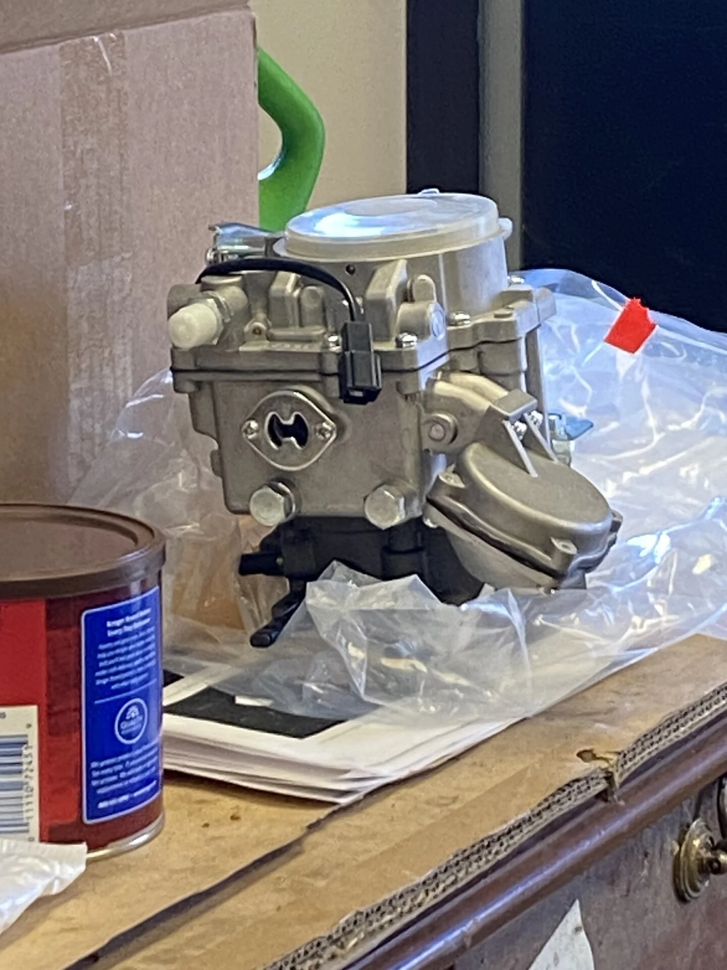

The carb was nasty after soaking in water for who knows how long. Attached is a picture of what was left after disassembly. Gives you an idea of the condition. We rebuilt it but never got it so it would idle properly.
Based on recommendations in this forum, I bought a City Racer replacement and spacer. Plug and play!
In your opinion, are the seat covers more on the “brown” side Of the spectrum 🤔?
Yes. I was concerned they might be too orange and not look good with the Freeborn. I like them and all the comments from those who have seen them have been positive

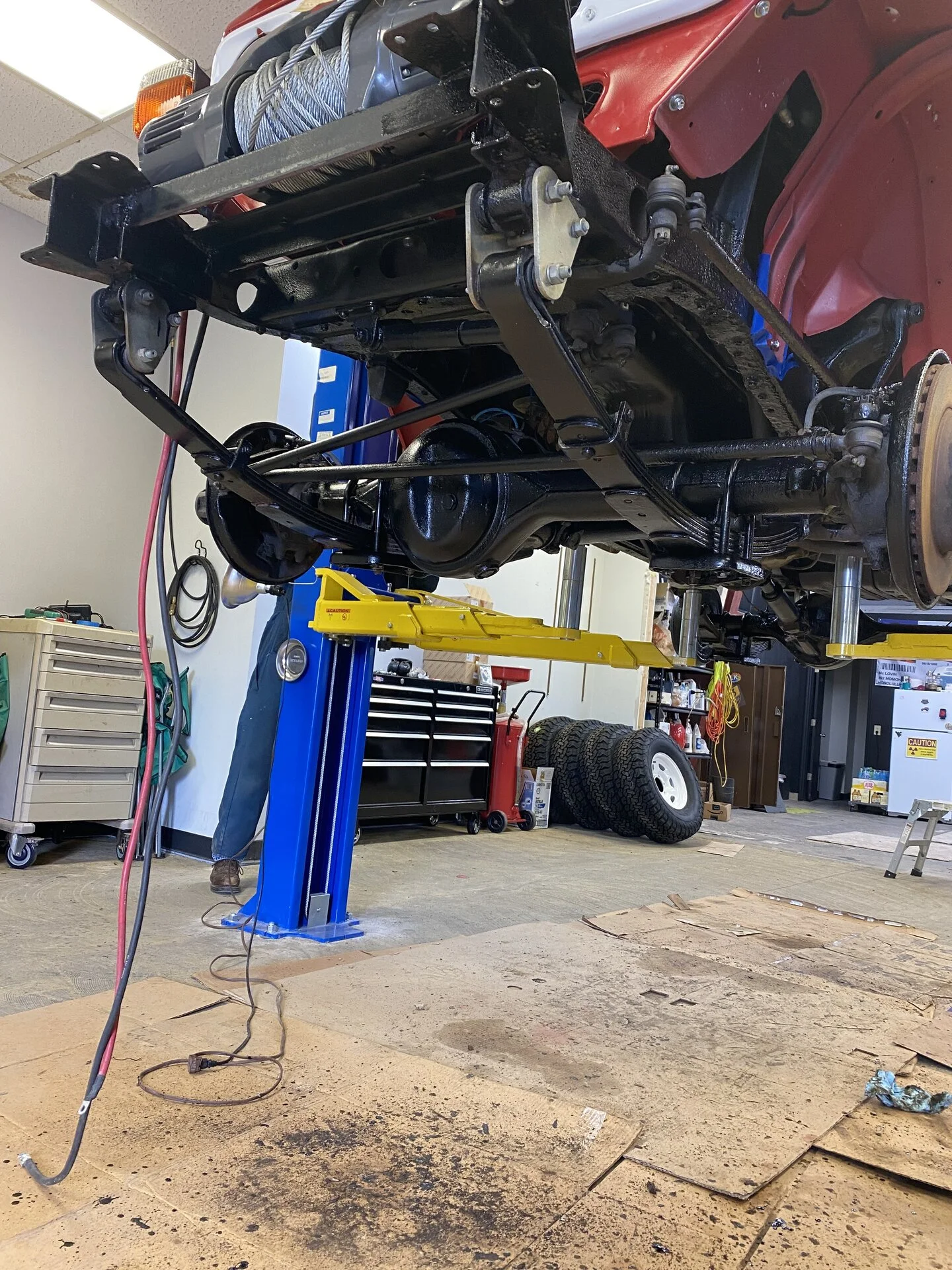

Thank you for your kind words, much appreciated! The frozen engine was an unexpected setback. But it gave us an opportunity to refresh the head and rings. We've made progress but I have neglected this thread. Thought I would update it. Most recently, we have cleaned and coated the underside. Little more to do but it is looking much better!
