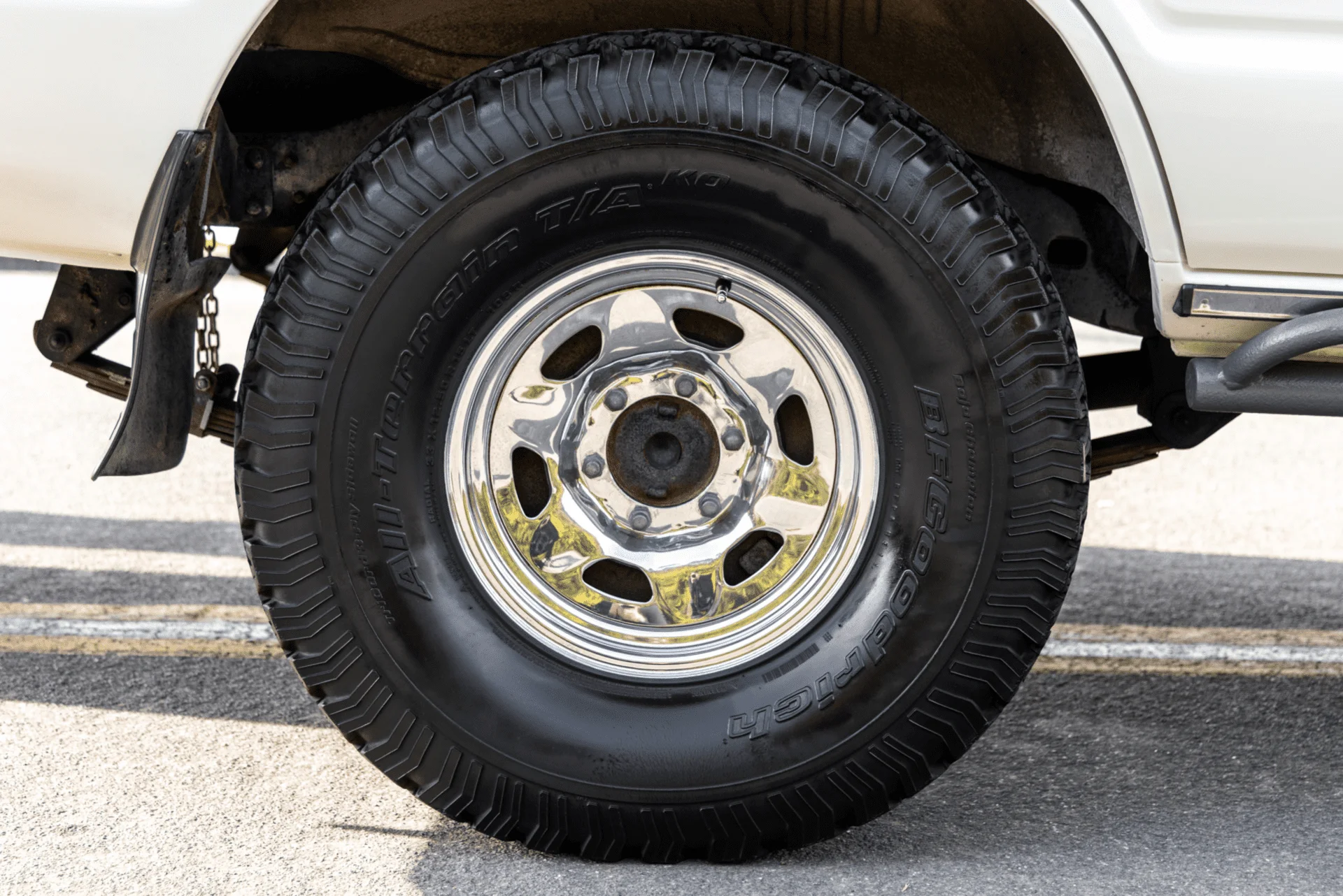

Just noticed that the PO put 12.5 on the stock FJ62 chrome wheels. Interesting, should I be concerned?

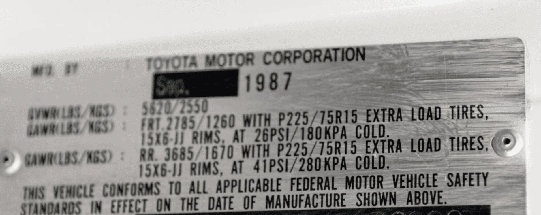

If the tag is correct, I have 6" wheels with 12.5 tires.... BALOONS!
