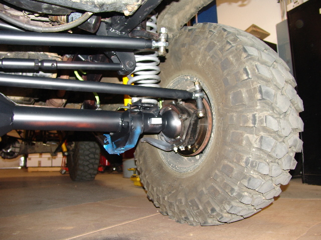

Somthing ive been working on. FJ62 rear flipped/turned, FJ80 outers. Im setting it up to use the stock 80 inners also so no custom inners are needed. I have the knuckles at a freind of a freinds cnc shop being drawn up on autocad this week for the high steer arms and ill drop off the balls (inners C's) today with my buddy so he can turn down the o.d. of the ball "slug" to fit the housing end. Pretty straight forward.
Slees uzj100 using the same setup, bling like though.
Ill be using the same type high steer setup.

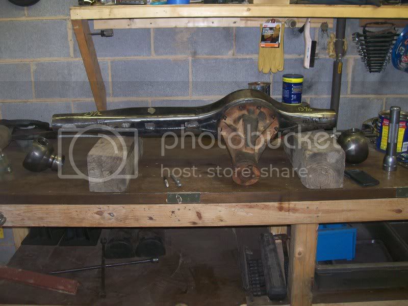

When I got the housing. Ends were cut already. Beside a stock 80 front shaved/stripped down. Lots of rust to deal with on the housing.

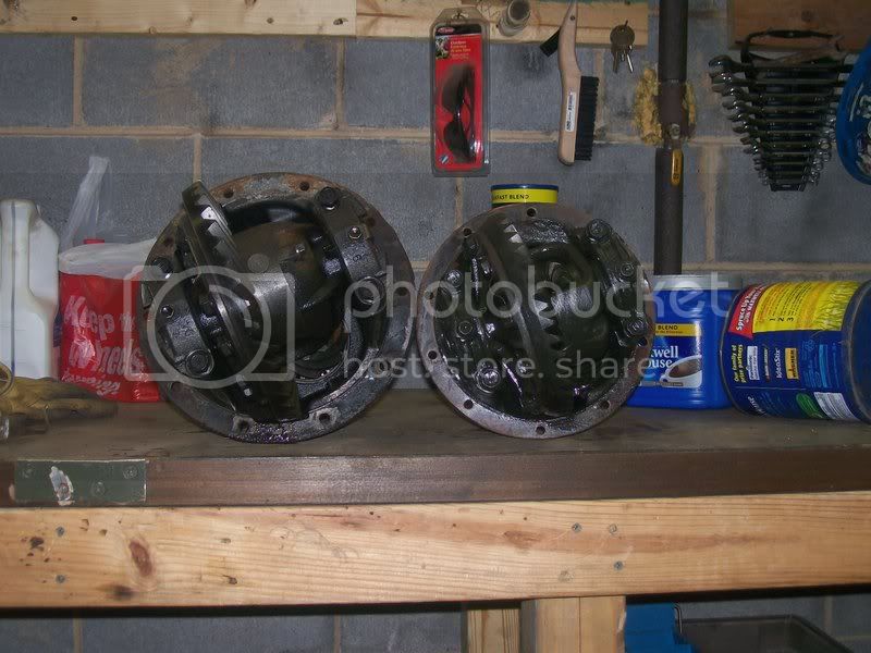

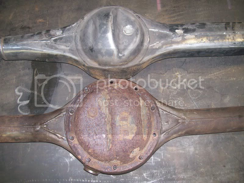

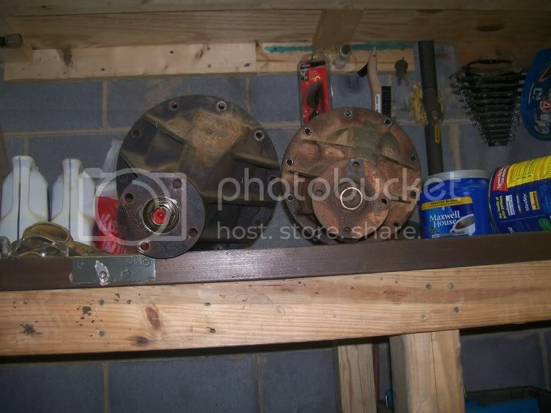

Comparison pics of the LP 8" I was going to run and the 9.5"

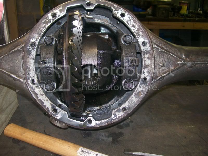

Note the "tabs" on the 9.5" bearing caps, these contact the housing flange for support.
Started by cutting the knuckles off the 80 and cleaning the 62 up.

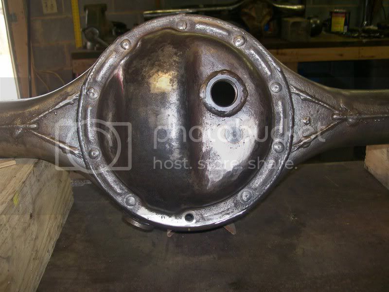

Here's how the 9.5 bearing caps are supported by the housing, almost like a 8.4 girdle. Also had to flip the diff back to low pinion, and notch the flange accordingly. This rear had a removable cover so that helped with it,otherwise the cover would have to be cut and turned.
Welded the cover on as I plan to shave/plate this one as well as have a a steering ram bridge/cover so it dosent need to be removeable. Also had to fill the stock fill hole and added a large one I had laying around.

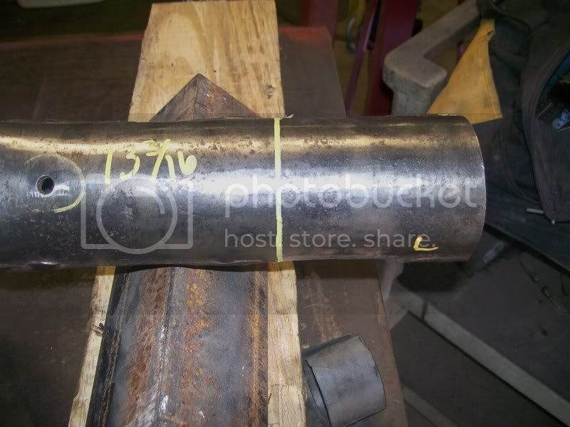

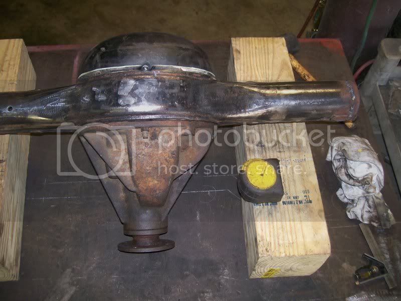

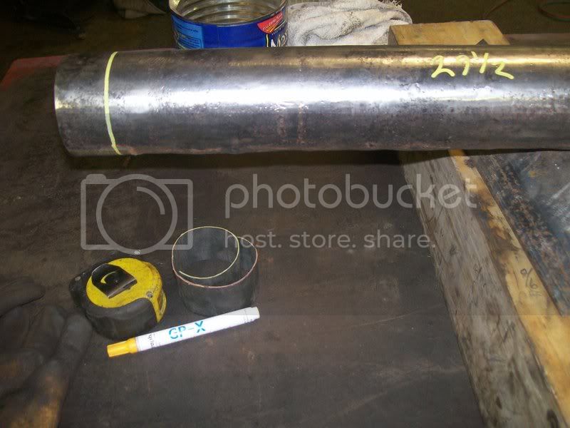

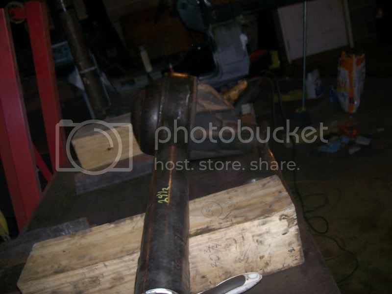

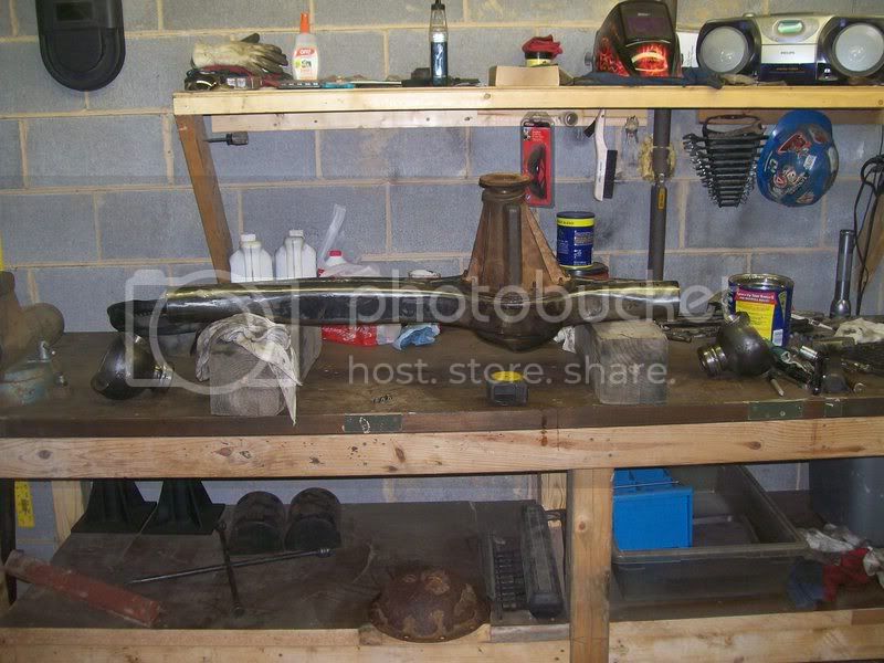

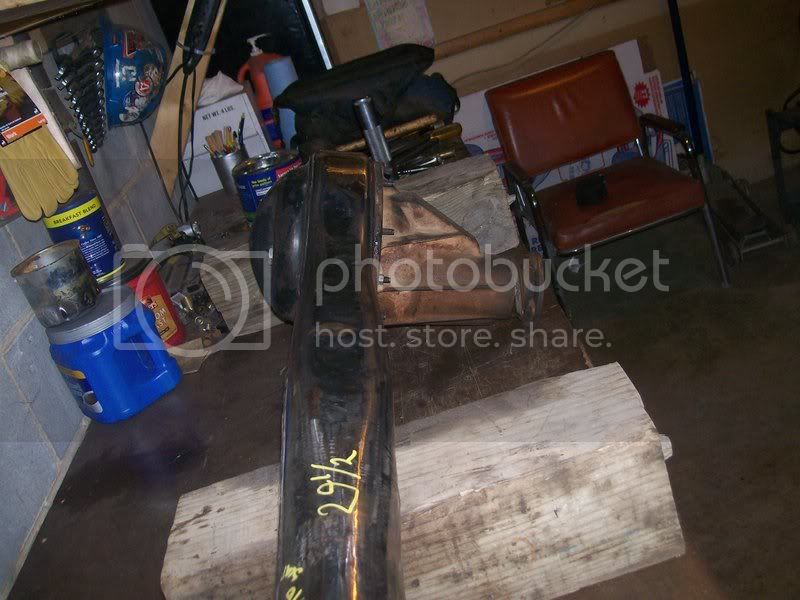

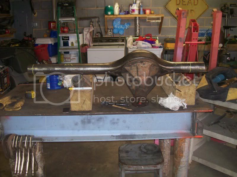

Next I setup to cut the 62 to length. I put the center in both housings, pulled a tape from the side gear to the cut at the ends on the 80 and marked the 62 accordingly.
Cut it, got it within 1/16" of what the 80 housing measured. I feel good about it at this point. Ill start on shaving/plating it today, as well as drop the balls off to be turned. I'll kinda be on hold till I get my knuckles back after that.

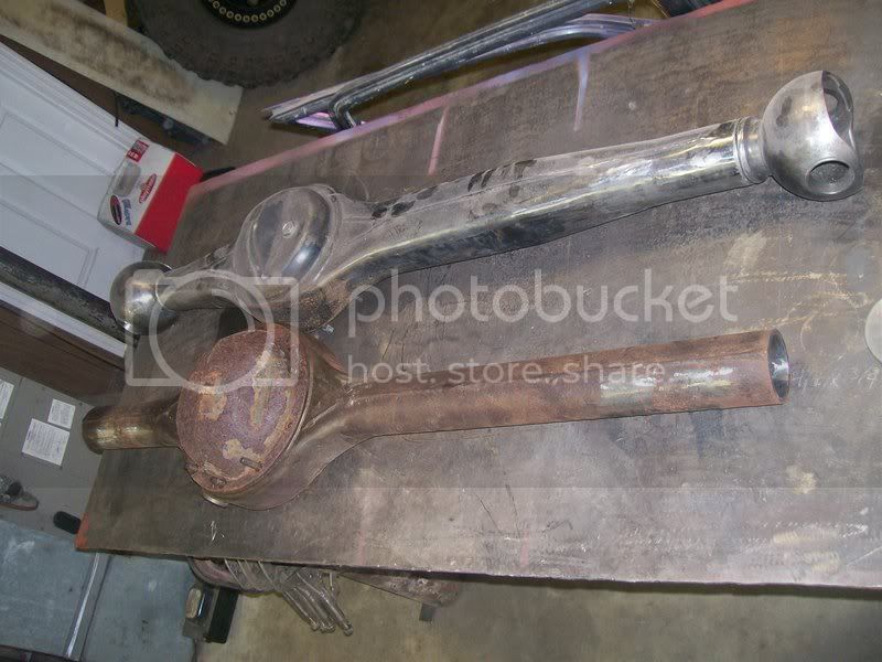

Heres a couple more size referance pics.
And a 80 birf beside a mini.

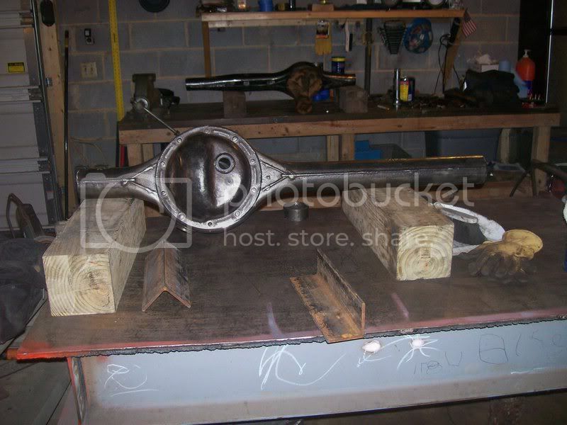

I shaved the 62 rear housing I was using but was not happy with the results. I also galled 2 bolt holes in it. I came across a semi float 80 rear for cheap so I decided to scrap the 62 housing, pick up the SF 80 rear and start over. I paid 200 for it and I must say it is one of the best junkyard axles I have come across for the dollar. Almost perfect 4.11 3rd with brand new gear dope in it. The SF is a c-clip axle for those wondering so about the only differance between it and the 62 was the offset, and OEM gussets. I wanted the gussets (strength, matchs rear) and the offset just barely allows the use of stock 80 inners. *disclamer* A FF 80 rear will not work for this application without cutting down the long side inner, the housing is too short on the long side. I took more time this time and it came out much cleaner and I am happy with the results. Im waiting for my inner balls to get done before I cut it to length, and I will assemble it for mock up then.
to the pics....

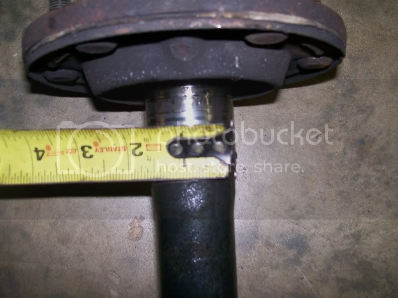

The SF inners are HUGE, almost 1.75", shame it has c-clips.
I took a pic of the axle complete but the dam camera didnt take it. I spent 4 hours cutting/cleaning off brakets. Again I took my time so I didnt fawk anything up (heat draw)

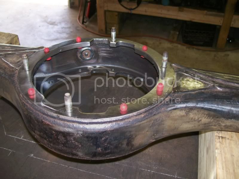

The 9.5" 3rd's bolt/stud pattern is simetrical (unlike 8") so there are no stud holes to move. Only need is the ring gear clearance to the opp. side. I also took my time and chased all the stud holes with a plug tap to make sure not to gall anything this time. Also a trick I learned from the tool section here, stick ear plugs in the fresh holes to keep crap out of them, works wonders. The do get a lil crispy with heat but dont melt. I just pluged the drain on this one. I will never shave a 9.5 again.

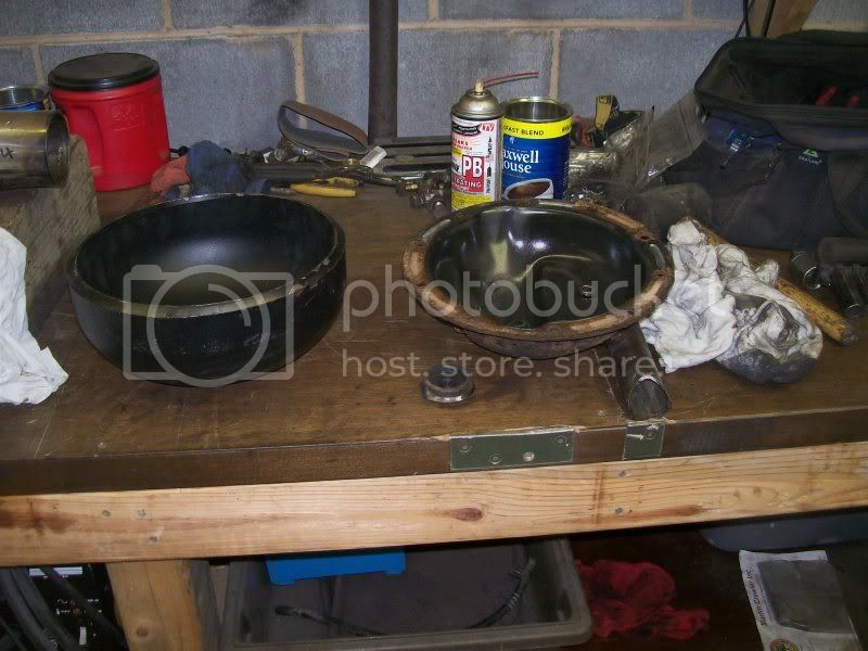

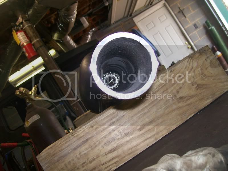

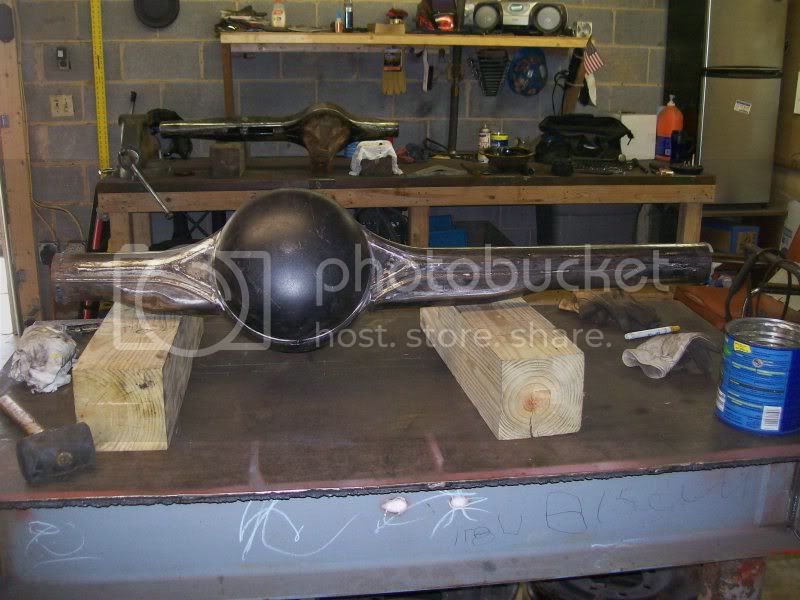

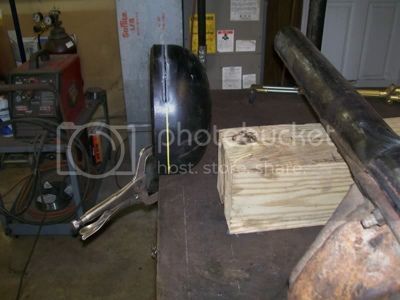

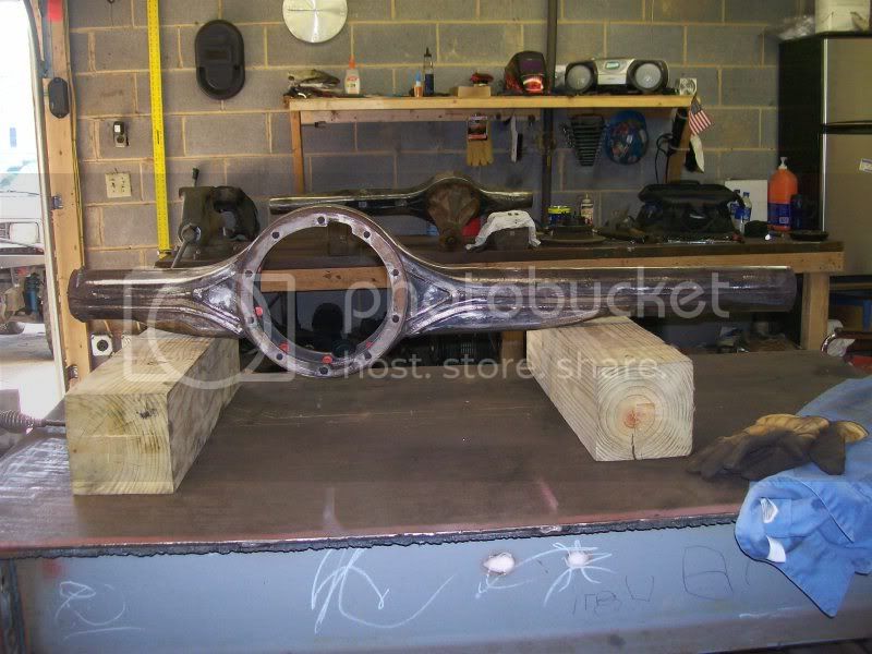

Took the 10" sch40, weld on pipe cap (10 3/4" o.d.) and cut it down to match the oem cover. This thing is BEEF! almost 1/2" thick, 28lbs! I should never have to worry bout chunking again.
Tacked it on for now, I still have to put a fill plug in it and I want to see where the inners are landing in the side gears before I burn it in.

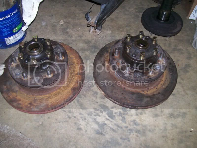

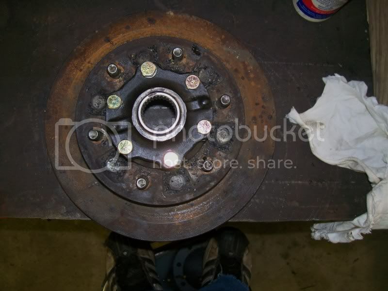

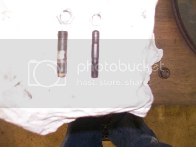

Also worked on the hubs a bit. I'll be drilling/tapping the 8mm-1.25 studs on the flanges (front and rear) to 10mm-1.25 and running grade 10.9 bolts in them. Heres is a size comparison.

Looking Good!, What where the hangups with Shaving the other Housing?
and Why did you cut a Slot in Both Sides of the Housing for the Ring Gear (Diff side, and Cover Side)
"FJ62 rear flipped/turned, FJ80 outers."
That's what you gotta do when you start off w/ a REAR axle. You rotate it, cut out new ring gear passages & fill in the old one's. I've done two hybrids similar to this. One is 30 spline & the other is 35 spline. My decision was mainly cuz I wanted a front diff w/ a removable cover, wider WB, & use D60 outers but retain the LC diff I already had.
Yep ring gear clearance. I was going to fill the other side in but decided against it with the cover being welded on. I think the heat applied to it to fill it would do more harm to the flange then the notch will.
On the shave... I cut a lil much out, and the cover I had was beond repair with the rust but I tried to use it anyway. Mistake! IMO its just not worth it for the clearance gained. Now 8" stuff is different, you can get a frigg'n 1.5" out of them.

Punched my hubs out to 3/8" with grade 8's in em. The 10mm stuff was 3.5x as much as grd8 :shaking: I messed with the cone washers for a bit but have about decided on just using lock tight on the threads and a lock washer at the head. Ill do this with the rear flanges also.
Thoughts?
the cone washers spread out the load of the stud more on the surface of the flange.
The Grade 8 3/8's stuff should work, i guess time will tell if its strong.

Damn, I hope you never break those grade 8 bolts; you'll never get em out. At least with grade 5s they act like fuses (break the thing you can fix easily) and you can drill em out without too much trouble. Or maybe you thinking of just replacing the entire hub if they break?...of course the idea is they wont break...hmmm

Well I hope the grd8's will hold. There is a guy in canada I got the idea from, he has beat on his buggy (2500lbs) without problems...his are on the rear steering axle too. He just built a 300hp 4.3 for it too so we'll know REAL soon how tuff they are. I think they are a big upgrade over the lil 8mm studs they replaced. With lock tight and lock washers sould stay in. IF they break I have enuff material left to punch them out to 10mm, I really think the bolt will be fine it the cone washers delete I wonder about. So the D70 dosent have them?
