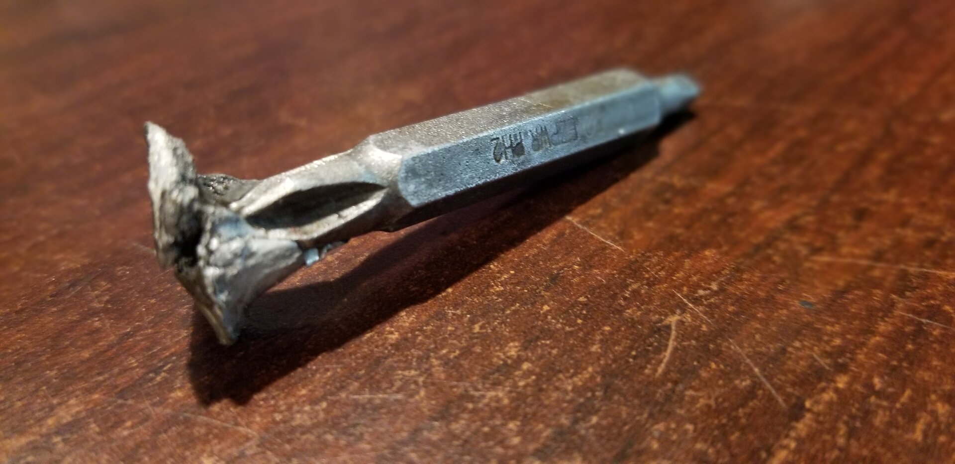

update on this is there's metal fragments in the oil pan, as I was expecting. .. SO, what's the experience level here with metal in the oil pan? Obviously it's from the hole in the piston and what ever got in there ( didn't find it yet, but the plug that got knocked out of the piston top was in there.

If it was mine, I would pull it and do EVERYTHING because you cannot be sure how much metal particles migrated through the oiling system and decided to carve grooves in the bearings.
Totally agree. Especially now after seeing in the 1st oil pan. Found the culprit, along with some of the metal from the piston and the chunk missing from the bottom of the head.
They were separate in the pan, I glued them together.
So, is that YOUR screwdriver bit or a PO?
Youch!
