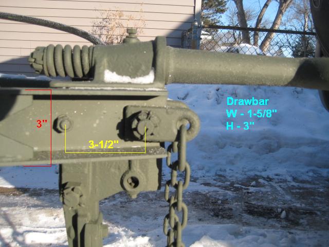

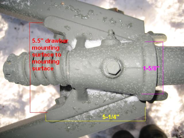

Here are some pics/measurements I took a couple years ago of the M100 style.
I'm wondering how easy it might be to adapt one to a single leg tongue.
What does the bolt at the top, 90* from the zerk, do?
thanks for the link. I did search, but didn't see that.
That lunette is actually from my Japanese Type-73, but may be the same as the M100. The top bolt could or could not be on the M100, and it only allows access to the lunette shaft's ring.
On the M416 type, the top bolt is the location for the zerk.
What you could make an assembly which mimicked the angled draw-bars of the military trailer to form a U, or two zig-zag brackets to bolt to the sides of the center bar, and the angled face of the lunette housing.

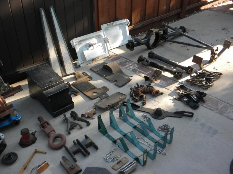

NT, I picked up this lunette ring on here. I am not sure where it came from or who made it (it's at Woody's house in Wis) But it would probably be a heck of a lot easier to adapt to your trailer than the military one.
KT may remember where he originally got it from.
https://forum.ih8mud.com/sale-parts/528258-driveway-parts-sale.html
attachment.php
Mace, That one looks to be one of the larger sizes, like for a tandem axle tilt-bed backhoe trailer or similar. Other than that it does look like it would be an easier adaptation. Hum, more research.....

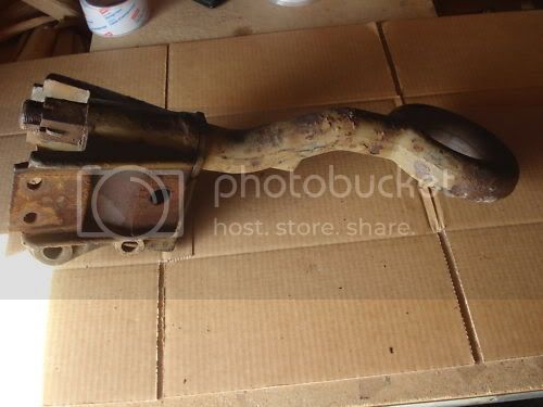

Searching fleabag, $135:
I'm guessing that this is the casting that has two of the tapered holes?
If the flats on the shoulder and the lack of spring loading are something to go by, it doesn't look like these are intended to rotate in use.
Looking at the pic below, those rotating pintles aren't tiny. That one is over a foot long.
Turns out that a friend's 416 that I thought had been converted to a ball coupler wasn't, so I'll go have a look at it if need be.
I believe this set up is from a M101. It only has the one tapered hole and you are right it does not rotate. I have one of the M101 and I have the lunette flip the other way. This are also not spring loaded.
