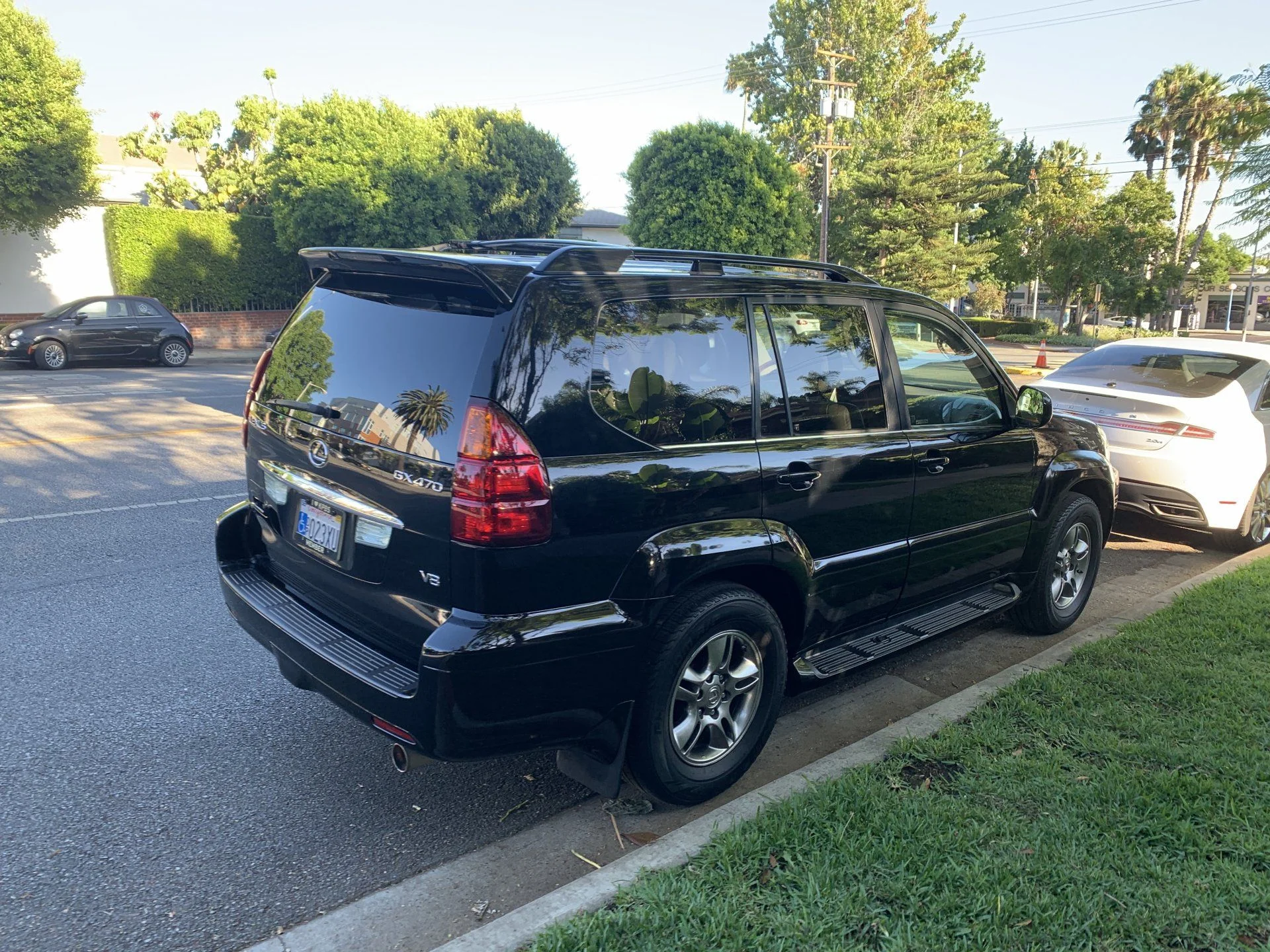

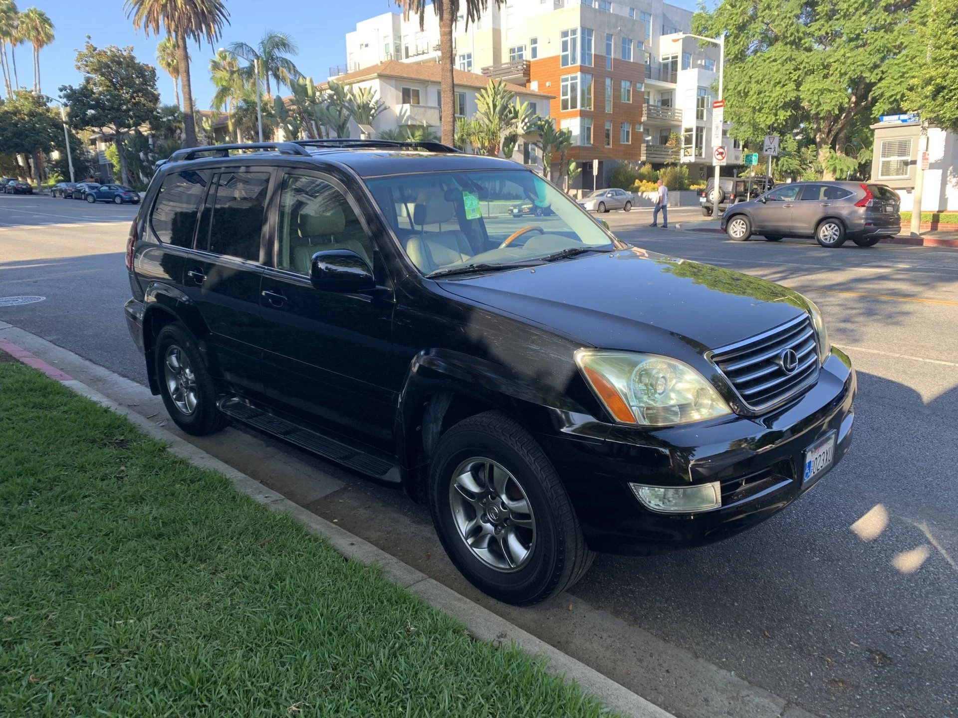

Hey fellows GXOR-ers! I joined the club last weekend with this new to me '04 with 195k on the clock. 3rd owner, SoCal vehicle all its life, and it came with a ton of maintenance records. Timing belt and water pump were done in January, so I'm good to go there.
Here's how she stands today:
Plan to build it into a mild overlander and daily driver. With that said, I could really use some help figuring out what I want to do to it.

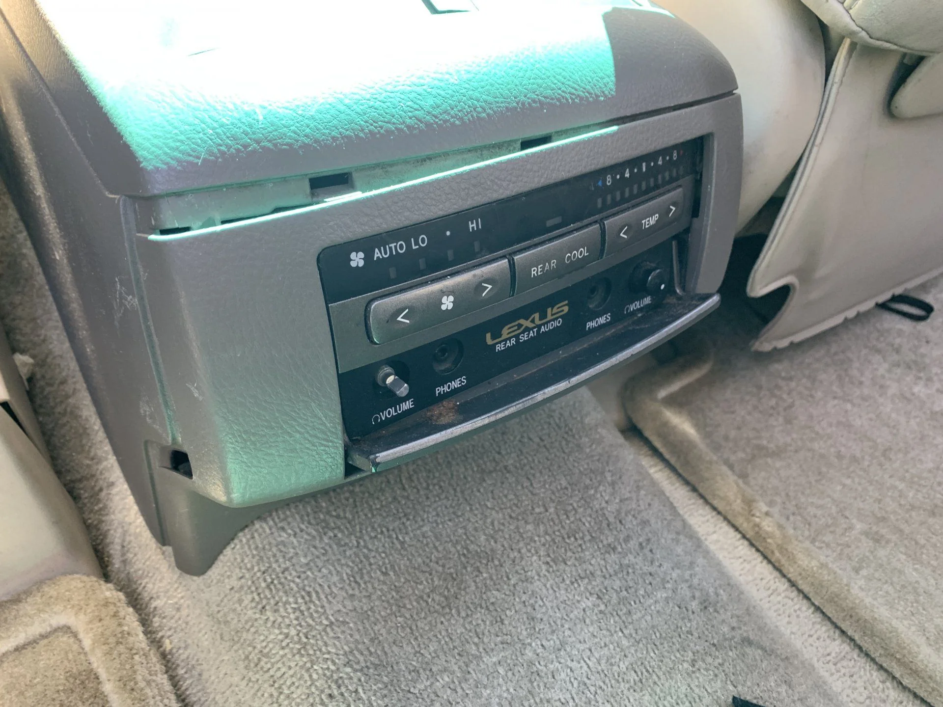

Anyone have a part number or spare one of these trim pieces for sale? I need the taupe color that matches the tan interior. I bumped the a/c controls with my knee yesterday and the tab on the inside that it screws onto broke, so now it's half-recessed into the space

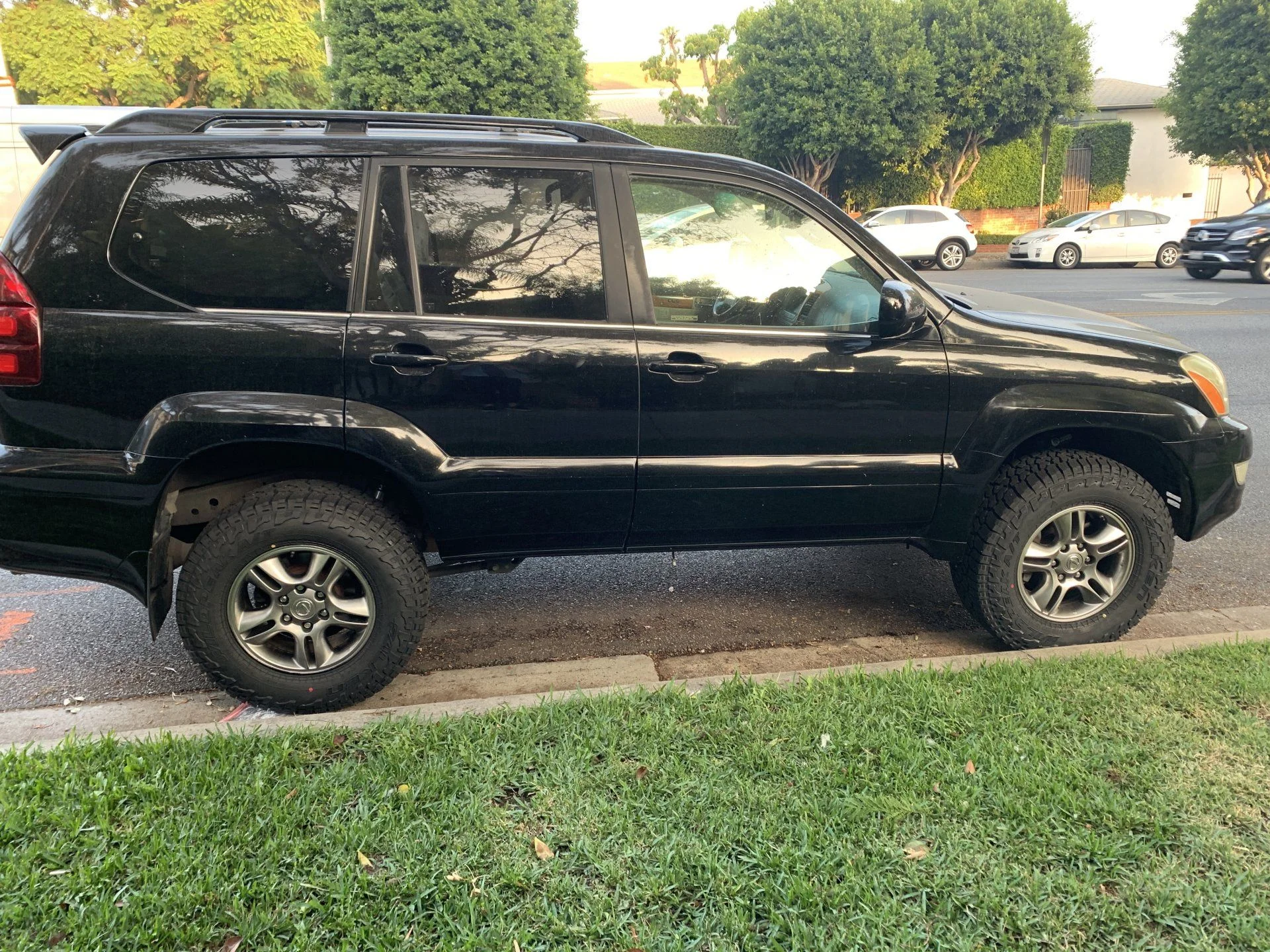

So, to bring it back up to speed — I picked up my GX from its install-fest yesterday and I'm psyched with how it came out.
It got:
  • Eibach Pro Lift
  • Freedom Offroad F/R UCA's
  • New CV axle
  • Lots of fluids
  • Swaybar links
  • 5 Falken Wildpeaks (265/70R17)
  • Alignment
  • Probably a couple of things I'm forgetting
