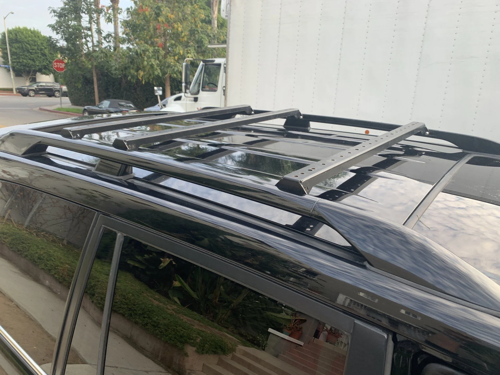

  • Installed the LFD roof rails. I have four, but couldn't get the last one to fit. It's about 1/16th of an inch too long :bang:

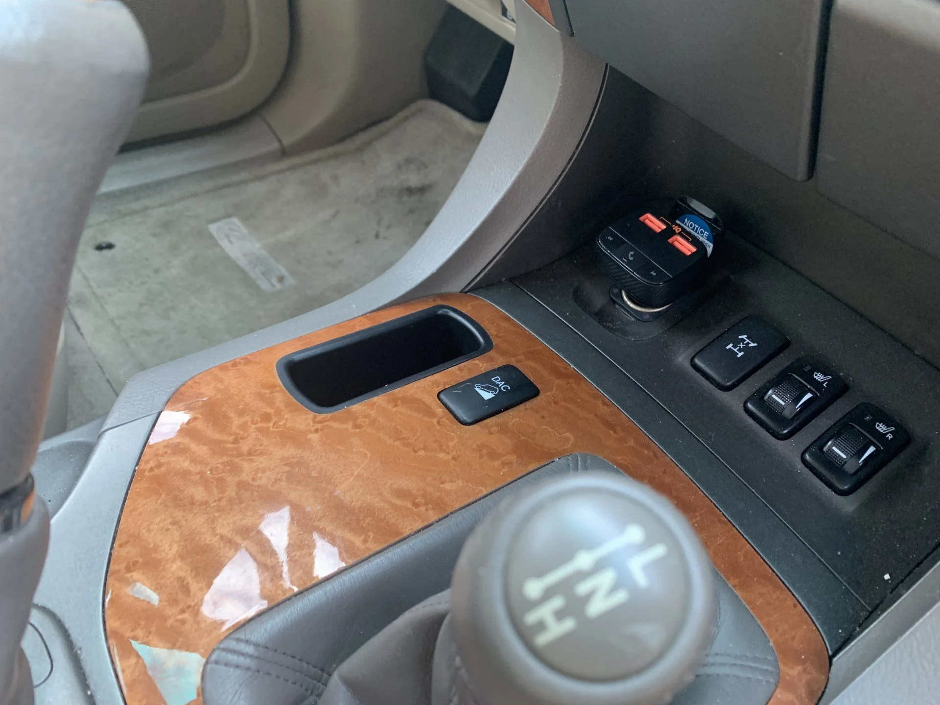

  • Pulled the AHC control unit and replaced it with the "cup" version (at least until I need the switch plate version) :cool:

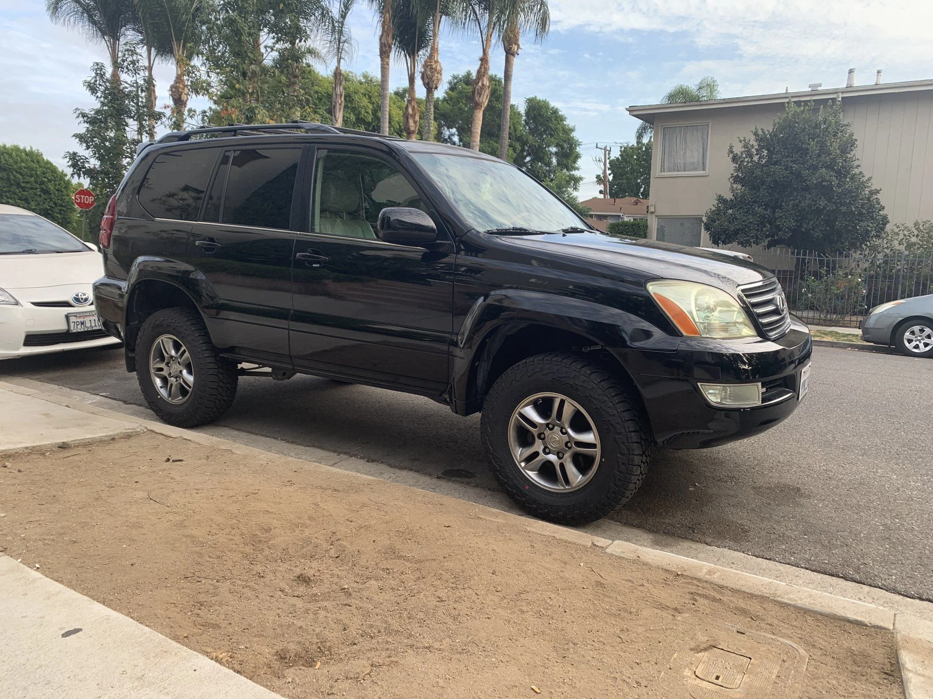

  • Measured the lift which was 21 center to wheel well in the front, and 23 in the rear. I was 19.5-20 all the way around pre-lift, so it's ~2 in the front (which was intended) but looking like about 3" in the rear on the Eibach kit. I'm assuming that this is due to my airbags being on their way out. I believe it's correctly installed; the shop that did it is reputable and has installed this kit before.
  • Added an Anker Roav F0 bluetooth to FM transmitter. Probably end up upgrading it once I figure out what I want to switch to, but for $15 this is a solid hold-over.

The Eibach kit is the standard "Eibach Pro Lift Kit" for the GX. I purchased from Rogue Offroad, but there are a bunch of retailers who sell it. I think it's heavily backordered right now. Check with Peak Suspension, Yotamafia, etc. (Just google the kit and start emailing retailers.)
So far I dig it. The street manners are solid — a little stiffer than stock, but in a good way IMO. For my offroad purposes, it's been great. I'm not into rock crawling or anything, just wanted a mild lift for general overlanding, etc.
