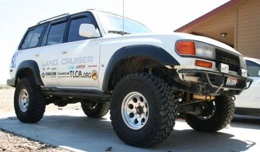

Wheels: Mickey Thompson 16x8s with 3.6” backspacing for a slightly wider stance
Tires: Toyo Open Country MTs, probably the toughest nonSwamper tire made. At 78lbs each for the 315/75/16 they are heafty beasts
Gears and Lockers: Factory retrofitted lockers with stock gears (possible diesel swap has made me stall on the regear) I ran wires from the rear to the front and installed factory pins using BostonMangler’s instructions. Amsoil Grease and knuckle rebuild this spring.
Slee Caster correction plates
OME J springs
OME L shocks
FZJFillmore bolt in spacers in the front
Metal Tech Protype Sliders, the cat guard is killer! I’ve slammed it hard and not moved the sliders.

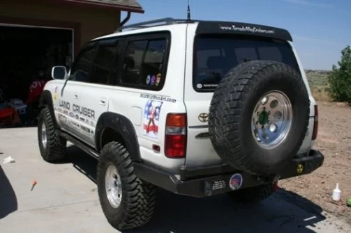

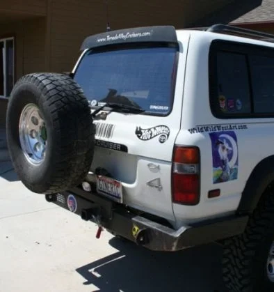

Custom Rear bumper: Frame was not cut but center crossmember was partially removed, main section is 3x6” rectangular tubing notched over the frame rails, 5/8” plate recovery mounts bolted to the frame and welded to the main section, sides are 2x4” recutangular tubing, corners and ends are capped with ¼” plate, ¼” plates mounted to frame with 3/8” bolts using nut clips clipped through the plug hole with two new holes drilled, the side supports are 1x2” 3/8” thick tubing, Swingout is hinged on a 1” trailer spindle with the tube actually being from a semi truck leaf spring. Swingout is 1x2” 3/8” tubing with a 40 series license plate bracket. The swingout is undergoing revisions. It need to tuck closer to the body as it drags on steep obstacles. It is still better clearance wise than the manufactured bumpers other than maybe the 4x4 labs but I want more clearance.
Skidplate is a home built ¼” piece of plate with a piece of angle iron running doen the edge of the frame using factory bolt holes in the frame. Probably the crappiest welds around as the angle iron was recycled and was coated with teflon. But so far it works.

DS rear view, home built rear bumper
PS front view, Metal Tech Sliders, MT Classic 2 wheels, Toyo MTs
Rear bumper side mount: 1/4" plate, 3/8" bolts with clip nuts installed through factory plug into new holes drilled into the frame.

Rear bumper and Swingout: 3x6" rectangular tubing, notched to go over the frame, center crossmember partially removed, the remaining has two 1/4" flat plates with holes drilled in them to act as another mounting point, 5/8" plate steel used for recovery points welded to the bumper and bolted to the frame.

Wheels were not chosen for looks but for function. Finding a non custom wheel that has less backspacing to make the Cruiser wider is tough. I came down to 3 choices and this was the best of the 3. I had the Eagle 589s (Mickey Thompson Classic copies) on my other 80 and I think I might still prefer the look of those. But these are definitely growing on me. I'm definitely not liking the maintanence they take. I may get them powdercoated silver. And there is a chance they will end up with beadlocks or even fake ones to protect the rim edges. I'm pretty hard on wheels.

The 91 was a little wider with 3.25" backspaced wheels. In my opinion it was perfect.
Oh and I think I may have forgot this. I run the narrow 91 flares on my 94.
