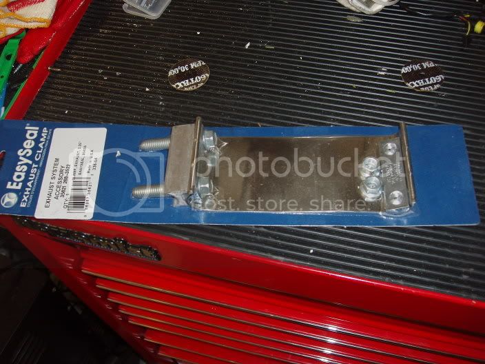

Well i finally install my TRD/Borla exhaust today after waiting 5 months.It was not bad,i had to cut off all the stock bolts and one clamp.I had to spray some lube on this joint to get it apart.
Everything bolted up back with no problem and i used the stock gasket and a new band clamp instead of the "c" clamp that comes with it.
It sounds pretty good,it's not loud.It is so light compare to the stock one

The band clamp i used
