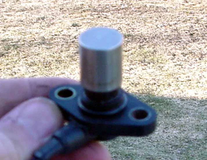

To start these first set of pics shows the sensor, gasket and it's mating surface on the oil pan.
Looking at the sensor you'll notice near the base of it there is a releif around it's body.

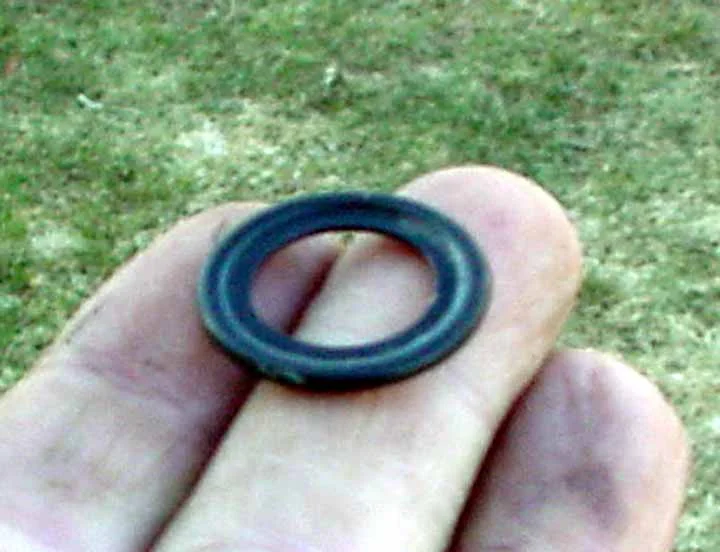

Looking at the gasket you'll notice tha there is a skirt on the inside of the O-ring. With the gasket installed this skirt sits inside that releif to hold the O-ring in place and centering it on the sensor.

So one could just replace the O-ring with a standard one off the shelf however it would be tedious to get everything lined up and ensure a good seal.

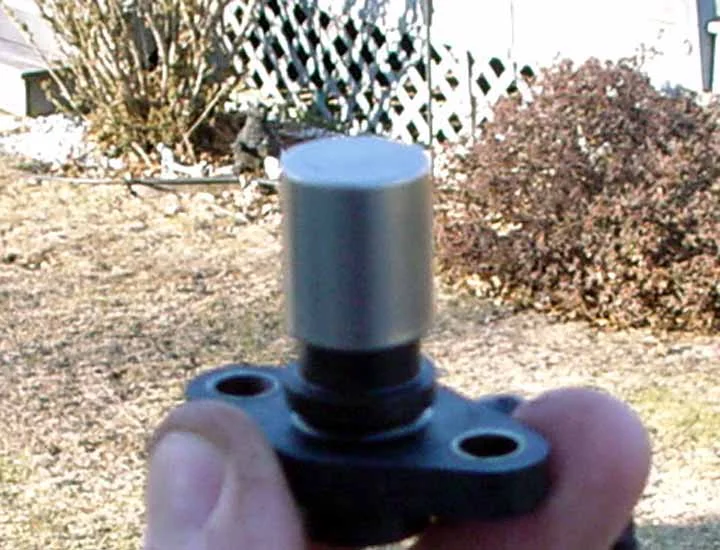

My solution was to use 2 O-rings, one smaller one to fill that releif and help hold a larger one centered for install.
The ones I used were as follows:
BrassCraft-SC 0558 3/4" I.D. (15/16" O.D.) x 3/32" wall
BrassCraft-SC 0584 9/16" I.D. (3/4" O.D.) x 3/32" wall
I placed the smaller one on the sensor and then pressed it into the relief to be sure it was seated completely.
I then placed the larger one over the top of it. The larger one was held off the base slightly but didn't cause any install problems.
