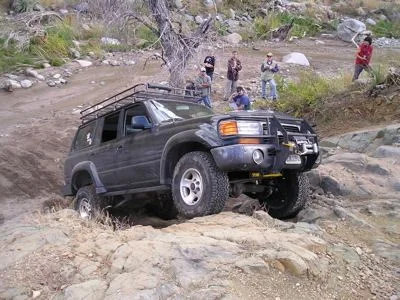

Early pic of the 80 and some complementary poooser shots...
