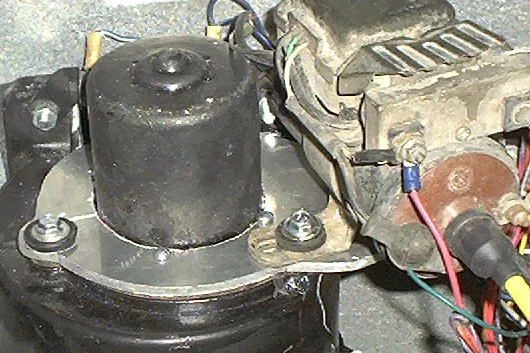

On my 76 FJ the "squirrel wheel fan" input shaft hole was larger in diameter than the Napa Fan shaft making a press fit undoable. I drilled a hole through the shaft and another through the shaft and wheel and inserted codder pins in both. It took both holes and pins to hold the fan securely.
I used 1/4 aluminum(sp?) It had a veneer of stainless steel as it came from an industrial stove top (salvage yard $2.00), for the bracket and will be getting a nice new fancy Pertronix coil to put up there very soon.

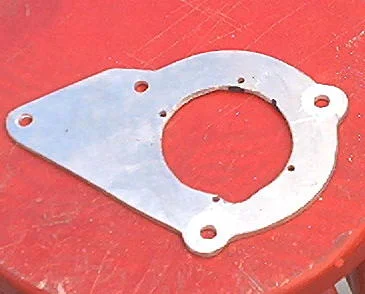

mounted the restistor behind the motor for looks. The first pic is the Napa motor. It comes attached to a large plate that is full of lumps. I cut most of it off and then cut the remaining lumps down the middle and hammered them flat before attaching to my new shiny plate.
My first attempt I tried to modify and use the Napa's orginal bracket but it looked to "backyard fab" when it was done. ---just because you are ghetto doesn't mean you have to be ghetto.

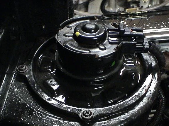

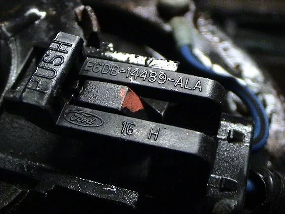

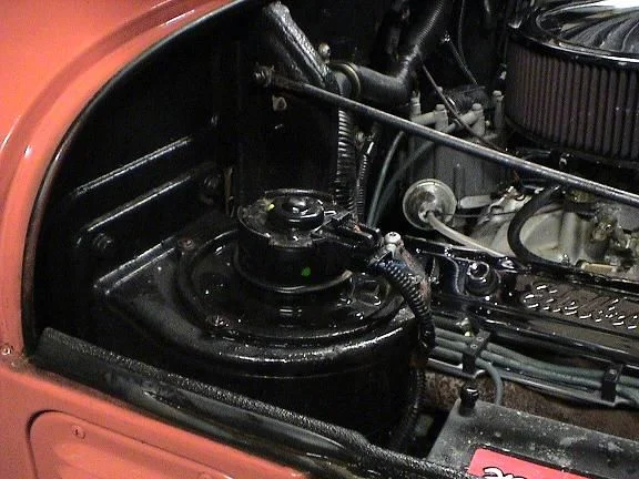

I installed a Ford Escort motor/squirrel cage unit into my 67 FJ40's stock heater motor housing. That was about 8 to 10 years ago so my memory is a little fuzzy on the details, but I believe the new motor was from a 88-89 Ford Escort. I'm not 100% sure on the years I listed, it could be from the early 90's as well.
I originally got the motor from my Dad when he worked at a Ford dealer since he was tired of seeing it collect dust. It was a "take-off" from a Escort that received a dealer A/C install.
As far as I can remember it went in fairly easy because the squirrel cage was just slightly smaller in diameter than the LC's. I think I drilled new holes for the mounting screws and that was about it.
Here's some pics that might help identify what year this thing is from.
It works like gangbusters too. About twice as good as my tired stock unit.
