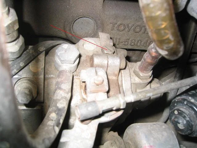

humm I need some more info, so I should do this to the pump in my 3B? I need to know where I put it in?
There is a screw on the top of the diaphram area at the end of the injection pump closest to the firewall. Kinda where the edic arm attaches. I think its like 4 drops. I just put mineral oil in there. I've had no problems.

Is there a chance someone could take a pic of the place where the oil is supposed to go?or is there a diagram-I have the FSM. I am sure neither the PO nor me have ever messed with that. Also, where is the fuel feed pump filter? sorry for my ignorance...

I hope this is it :)
