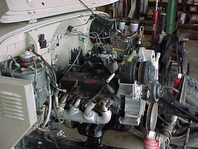

sneek peek
more pix in a day or 2

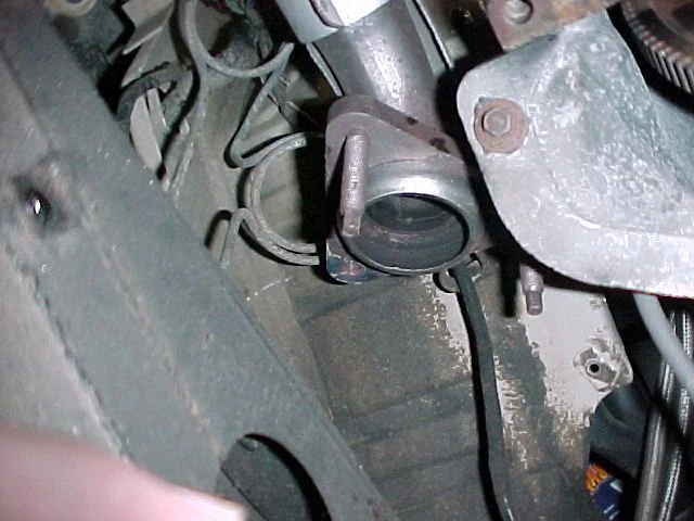

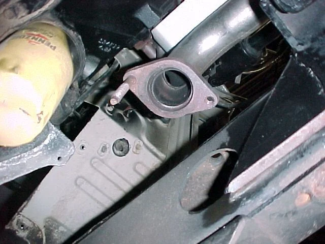

youre gonna need to change out that passenger side manifold? I eneded up running manifolds off a van when I had my 4.3.

I have heard those 4.3 engines are a real pain to get the exhause manifolds set up right. Not much selection to choose from ;p
Not making Moab this year, Razorback Ramble is the next event for us, last time I talked to Casey he had more Texans registered than Arkansas boys.........
These manifolds are gonna work they are OEM 87 Monte Carlo.

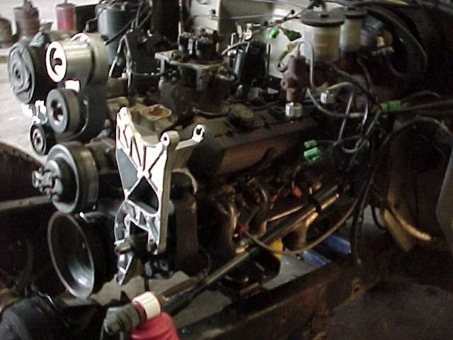

I'm working on a 4.3 vortec swap along with a 4l60e. Where did you end up putting the motor mounts?
12.5'' back from the back edge of the shock towers

Did you offset it at all, or is it centered?
Have not a clue, we were looking at the exhaust manifolds and the PS pump in relation to the steering shaft, this dictated where we positioned it.
Butch

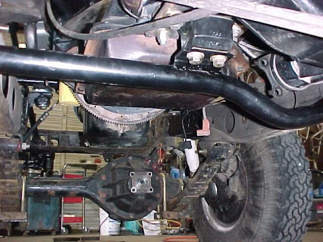

OK, more pix, the engine is offset 1" to the drivers side.....
here is our mount like we do on these setups.
takes all the stress off of one of the mount pads, you have 2, one on the T350 and one on the AA adapter........

Mount is T 350 from Energy Suspension......
I just built a tranny mount like that after seeing it on Extreme 4x4s Ranger. I double tubed it, which was major overkill. Did you drill a hole through the end plate and run the tube through?
