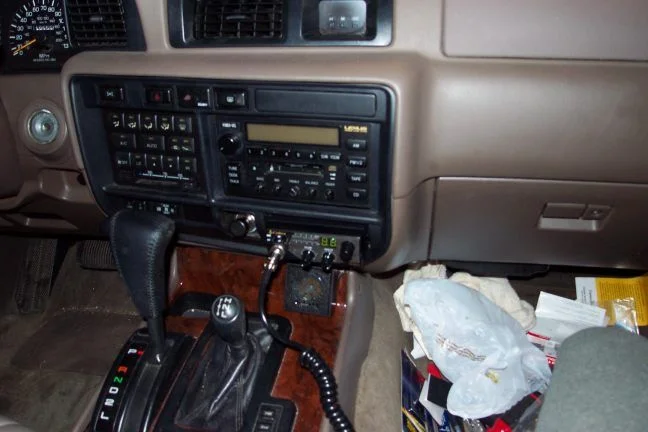

The first question is what size CB to buy. I first bought a regular size CB like the one in my FJ40. I then came home and did a search after thinking about where to install it. Unless you have replaced your radio, there is no great solution to installing a regular size CB in an 80/LX450. That’s were I was pointed to the solution above that works great for others. I did something similar. So why did I feel this deserved another thread? The CB cable routing and power. I will include some solutions mentioned by others along with what I did. The thread recommended a mini Uniden. I searched around and went to a truck stop and they were out of the Uniden’s, but had a Cobra that was a little taller, but installed just as easy.

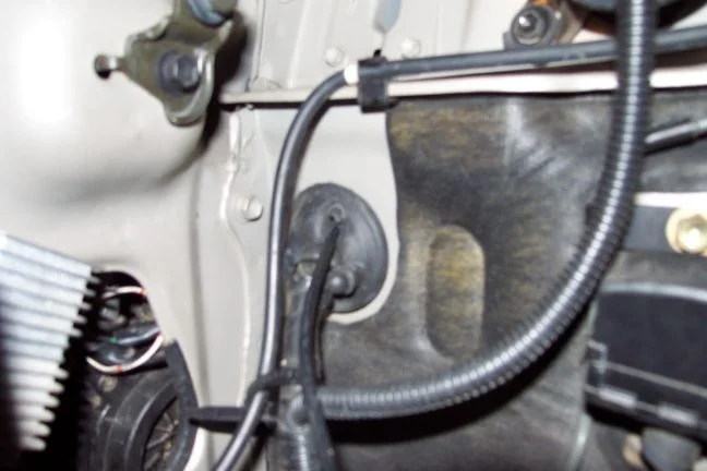

I took off the Glove Box door and on my 97 LX450, there were to many components in the way to be able to get the access Dan Talked about. There were several other suggestions but I wanted to make sure I could get to it from the Dash side before I tried. Having the Glove Box off does help the install.
I felt up behind the dash above the Glove box and could feel a grommet. I went and looked in the engine bay and there was a grommet with what I would call two “nipples” on it. I cut one of the nipples and made the hole larger and placed the antenna cable through the hole. With the Glove Box off, I routed the cable up and over the radio and down to the ashtray slot. I then connected the other end to my ARB.
I took all the slack out of the cable from the engine compartment. I did not want it coming loose and catching on anything. I wrapped the excess in a loop and used a plastic tie and placed the excess in a spot to the left of the Glove Box.

I decided I could do that later if I didn’t like my install. I utilized the alternative listed on Christo’s site and bought a 90 deg Elbow and installed that on the back of CB and hooked the cable with that. Hooking the cable up to the back as is would make it stick out to far
Finally, where to install the external speaker. The CB speaker gets buried within the dash. I bought a small rectangular speaker and used Velcro to attach it to the console behind the shifter.
Remember that all the wires need to come out the ashtray hole before you install the CB.

7. To install the CB, the two tabs that have the holes for the screws (removed in step 1) need to be trimmed down. The upper and inside lip have to trimmed down about 1/4". This is a try and fit procedure. The fit is fairly tight but that is good since you will not attach the CB to anything once it is installed.
It is real tight once it is installed.
This method turned out real well. I probably will leave it the way it is and not take apart the radio to get the extra clearance. At least, I can change my mind later.
I Bought a 4 ft fiberglass ant and simply unscrew it when I am not going to use it.
A side view of the install.

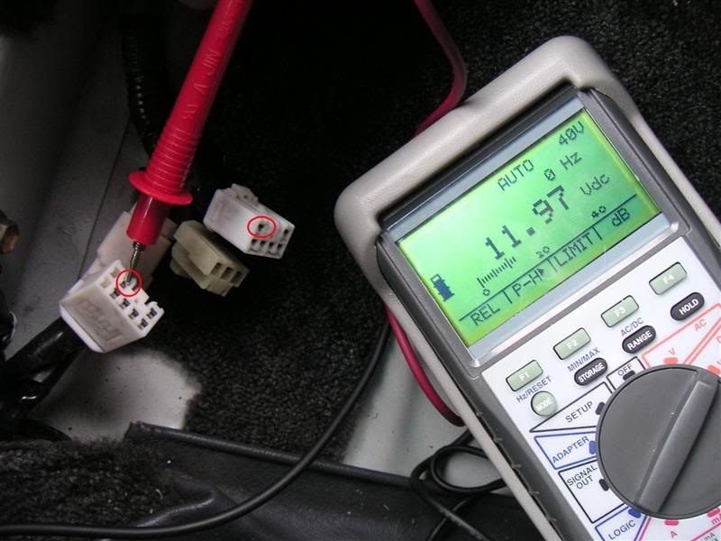

Next question is where to power it. First I followed the thread on unused cables under the console and thought one of them could provide power easily. I only found two of the three mentioned, but maybe the third is used in the LX450 for something else (No cell phone here). I found one with +5V Hot, but not 12.
I just had an idea about that +5V source that might be useful for those who use computers in their LC. Tap into that plug and place a USB plug onto it. THen you could use those little computer LED lights, fans things like that.. but more practical would be charging a PDA or a GPS unit, like my Belkin Bluetooth GPS, without taking up another 12V outlet. Since the adatper just reduces it down to 5V anyway. I haven't checked to see if my 94 has it, but I do remember 2 or 3 plugs under there when I installed some external hidden speakers in there for my Garmin Street pilot III.

Since this came up again, I had looked for that 5V source you mentioned in my 94 LC. I found 3 plugs and none of them had 5V but I did find 2 wires with 12V. Iin the picture are the 3 plugs and circled are the 12V leads. Are either of these plugs where you found 5V on your rig??
-Gary
