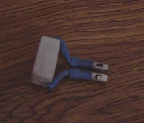

Well my 97 has been driving me crazy with the constant come and go of the PO401. First I tried switching the control for the EGR valve, nope. Also note there was absolutely no carbon in it nor the lines. So I guess it's my VSV control, and what a pain to get to. Could also be the sensor its self. Then I've heard the pesky PO401 will still come back some time down the road even after changing all of those parts.
The resistor replaces the input from the EGR gas temp sensor. Simply leave the temp sensor in the intake but unplug it and plug the resistor in. The sensor is located on the rear of the intake not far from the EGR modulator.
I used two female connectors taken from a toyota plug and soldered them on a 1k ohm, 5 watt resistor. Some heat shrink and your done. However I have noticed it will not kick the CEL OFF. I had to either re-set it will a scanner and then install the resistor or wait till the CEL went off by its self and then install.
NOTE I tried this only as a TEMP fix, but it's worked so well I may just leave it as is.
--UPDATE--, ecu looks for a 1k ohm range not a 1 ohm! simply follow the thread but with a 1k ohm resistor.

The 401 and 402 come from the EGR gas temp sensor. So it fixes either one and how can it kick on the code if you have the computer fooled??
A month, HA try like 6 months now and still no CEL. I would not have made a post if I was not some what confident in my work. Trying to omit usless posting in the tech. :D

I got started with the resistor when I was bored in the garage and took a look at what I had around for resistors. But the only thing I've checked is the moudulator and the sensor, so the only thing left is the VSV. But like I said some have said even after all that the code comes back after a few years.
