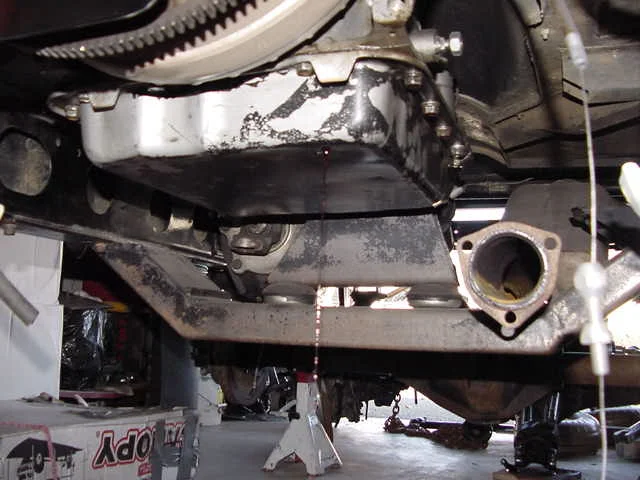

i got started on this over the last weekend. what have i done so far? got the cruiser in the garage and made some room to work around it. pulled the old engine/trans/t-case. put it up on jack stands, put the cage in for mock-up, pulled the brake master, pulled the rad, trans cooler and lines, all the brake lines are gone, most of the wiring is out, all the front sheet metal is off,......it's pretty much stripped down as far as i need to go. i think anyways.

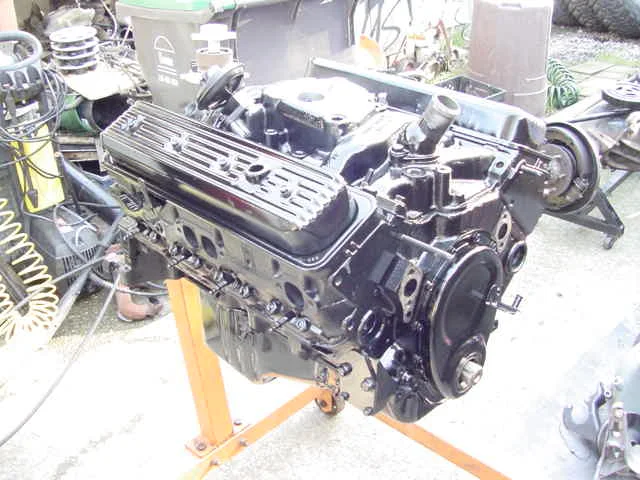

pulled the new engine out of a rolled 94 suburban donor vehicle.
cleaned up that engine, stripped it down, resealed it and painted the tall block.

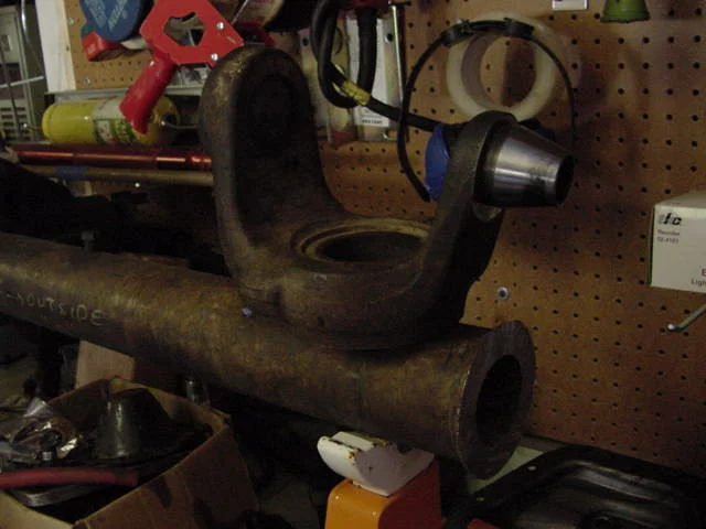

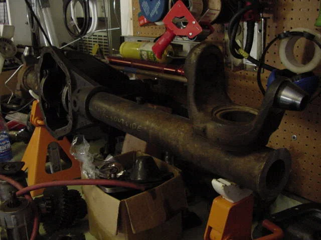

got the d60f on the bench, pulled it apart, did some measuring and chopped off the long side axle tube right at the "C".

a few before pics. gotta add "new crossmember"to the list, the old one hung down way too low.
