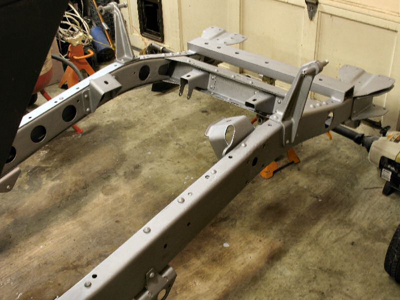

Rust Bullet (www.rustbullet.com) works really good over rust, adheres much better to metal than por15 does, the finish is also very durable. I redid the entire inside of the tub on the blazer I used to have, with nothing else on top of the rustbullet, at no point did any of the rustbullet wear off, after many wheeling trips (over the course of a few years) with sand and mud grinding into it under peoples feet. I just did the frame with it on my 65 build. The rougher(rustier) the surface is, the better it adheres.
Just finished this frame about a month ago. Sand blasted in the driveway then two coats of Silver Rust Bullet. I plan on leaving it silver :grinpimp:
^ Mmmmm that looks purrrrty! LOL
Seriously, it looks very nice... I assume using rust bullet doesnt require to ruff up the frame as much as POR does?
