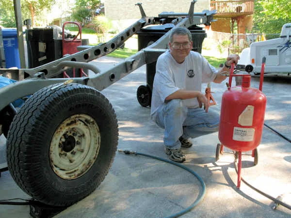

Coolerman, describe your sandblasting setup.
What was your media, specs on the compressor, and if you had to blast it all over again, what would you do differntly? Did you use a dryer of some type?
I use a Harbor Freight $79.99 (On sale) pot blaster. It holds about 40 lbs of simple playground sand which is $2.39 a 40 lbs bag at Lowes.
My compressor is a Lowes Kobalt 17CFM twin cylinder 220 Volt with 80 gallon tank. I use a 50' 1/2" hose to connect it to the pot and the pot has a built in water separater.
I use 1/8" nozzles and run the pot at 130 PSI. The pot is a bit hard to get adjusted properly but once it's 'right' I can blast for about 20 minutes before stopping to sweep up the sand, screen it, and put it back in the pot. My entire frame was done with 2 50lb bags on sand.
For protection from the silica dust I wear a painters hood, a respirator with twin filters, and over that a full face shield. Long welding gloves. long pants and if cold a sweat shirt complete my blasting outfit.
The only thing I would do diffferent is move the frame and blasting equipment to the yard and away from the wifes flowers. She was not happy with the sand I covered her flowers with. :doh:
