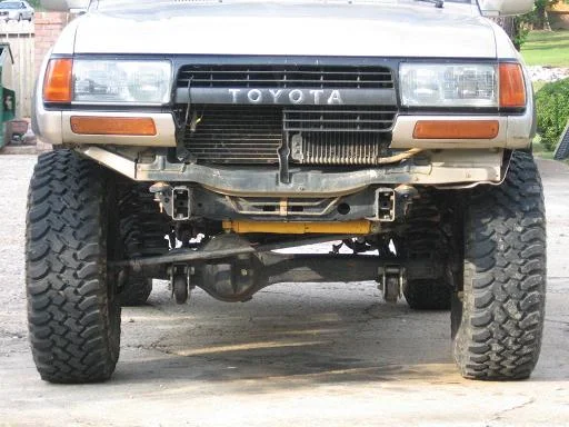

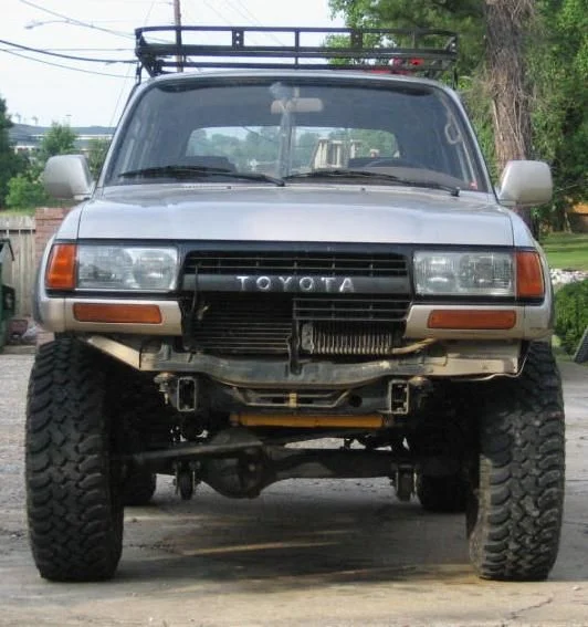

So I'm not afraid to cut things off my wagon and when it came time for a friend to build me a "light as possible front bumper" he asked me how I wanted to protect the front part of the wheel well. My response was "I'll just cut that crap off..." and I have! In these pics the passenger side has been modified and the driver side has not yet. I wanted to reference them just so you could see what I cut.
This modification will significantly increase my entry angle since now the bumper will not need to go low, the bottom tube is going follow the line of the passeger side. That's a 35 and looking straight ahead you can see the top of the tire!
Note: AC dryer is inside the engine compartment on 91-92's so I didn't have that to worry about:D
There is definitely more to come in the next few days....

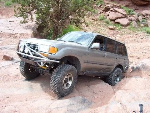

this is my tube bumper
and very nice might i add...

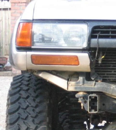

I first cut across the top of the brace to free it from the thin metal using a saw-zall, then notched a V in the brace and bent it up. Then a few tacks and we're there.... saw-the rest outta the way.
maybe you can see in this closer pic...
