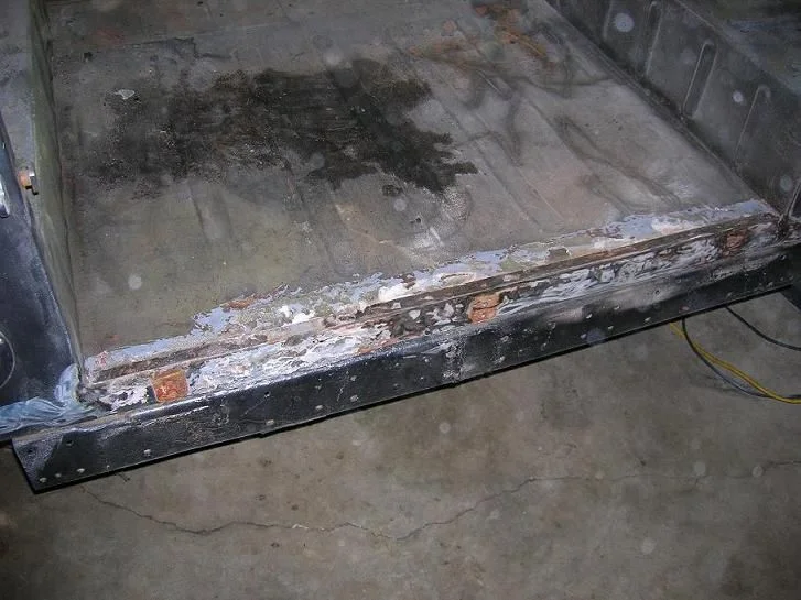

The body is not really in bad shape, small hole on the lower cowl near where the running boards would connect, rear tailight panels (I know, there should not be any tail lights in the panels - will fix it), a few small holes in the floor pan under the jack/tool compartment, and of course the rear sill.
One of the previous owners decided the fiberglass the entire floor and so I spent an entire day ripping up fiberglass. Seems to have protected the floor pans as there is little damage other than what was mentioned above.

Well I wouldn't call it great shape but not too bad. I definately have some metalwork to do. Found that other than the rear sill, the floor board under the driver's seat box is the worst. Can't find replacement floorboard for this early FJ. Wonder if a later year floorboard would still work and I could keep the box....

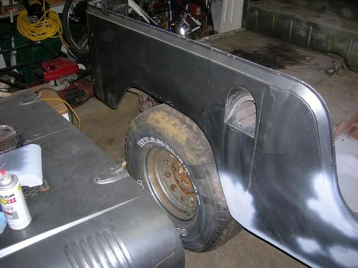

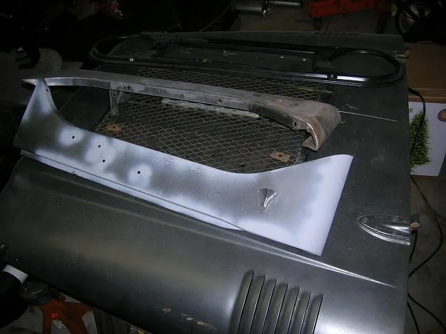

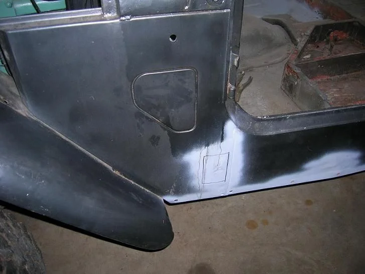

The grey primer is where I sanded down to bare metal to see how bad the damage was. The entire floor was covered in fiberglass (some can still be seen in the tool box area). I probably have to replace the floorboard under the toolbox and where the gastank sits (this is still solid metal but very pitted).

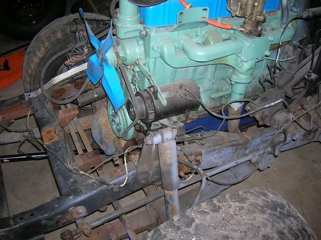

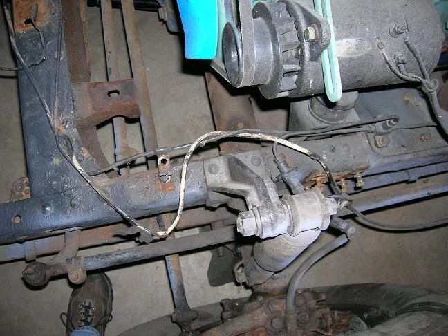

The engine photo shows all that was there when i got it. Missing radiator/mount, air cleaner assembly.

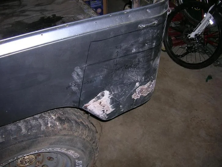

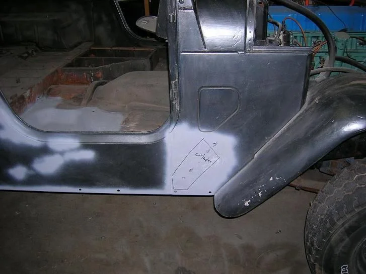

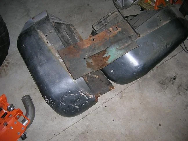

Got time to put in a little more work on the teardown/assessment. Took the rest of the front end apart. Only broke off one bolt removing the pass side fenders. Fenders look like doo doo but the bib seems to be in great shape minus the rattlecan paintjob and some surface rust. Taking a bunch of photos as I go (some to post but most as reference for when it all goes back together.
