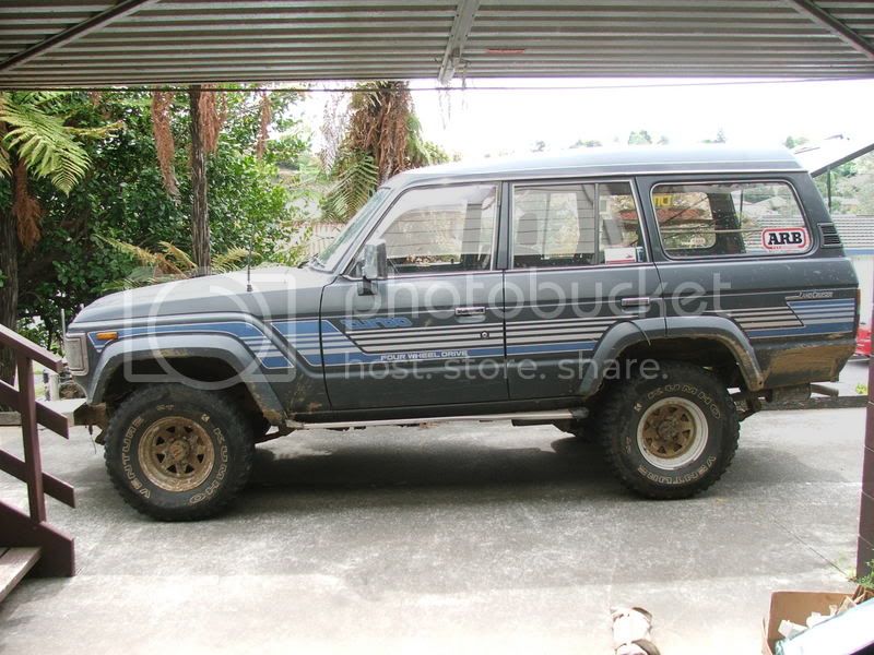

So a while back I asked the question whether 35x15x15.5" tyres would fit. Well there is only one way to find out....
Before 33x12.5x15" Kumho 834 MT
next to the new ones...
Old front stance..
New front stance
Old rear
New rear
3/4 view
side view
Now before you all ask the questions...
1. 2" spring lift
2. 50mm body lift
3. 15x10" rims max offset (Mangels)
4. 35x15x15.5 Mickey Thompson Baja Claw Radials
5. rears rub on the inside at full stuff
6. front corners were trimmed slightly and the inner guard punched in gently.
7. at full lock and full stuff inside of the tyre rubs slightly on the spring.
8. still drives well on the road.
9. 1988 HJ61 VX 12HT
I did lots of full articulation testing last night and it is very drivable. the only thing would be that I may consider would be a 6mm spacer for the rears.
Action pix coming this weekend.

You might be better to get longer shackles in the rear for a little clearance and lower bumpstops to reduce rub.
Bumper made from 6mm 5083 alloy. Its what I had at the time.
Full stuff 20mm clear under the rear bumpstops, and besides I'm stinkbug enough!
A slightly longer shackle would give you a little more room up front, and wouldnt affect castor enough that it would be difficult for you to get the truck recertified.

Hey Kiwi. Judging by your front shackle angle, you might be able to get a bit more lift in there. Are your springs sagged?

Springs are a year old (were new). I got a real good deal on them but I think the springs were for a non winch 60. When funds allow I will prob fit 2 of those OME Dakar spings. I want to rebuild the front first so the PTO will prob get the arse and I may go to a toyota Highmount 24V winch....still thinking about this.
I don't want to go to long shackles and wedges if I can help it.
