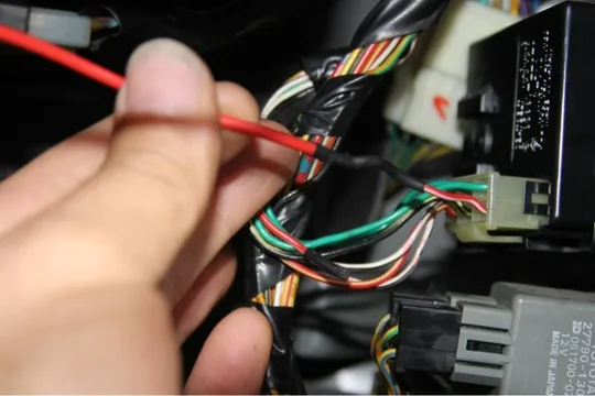

Here are some extra pictures. On the first picture you can see the red/white wire. One end taped off, the other end attached to a red wire that goes to te rivers side of the truck. This is behind the right side panel.
The second picture (sorry for the wrong focus, my arms were too short) shows how the red wire is connected to the green wire. This is behind the left side panel.
