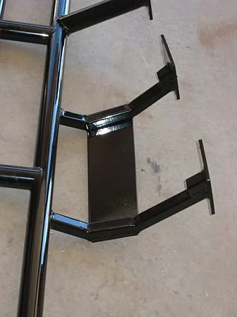

Thanks go to Box Rocket and others who have provided great ideas for cheap sliders. I decided to purchase a weld together 68" DOM kit from Adam at 4xinnovations.com. The price is extremely reasonable. A friend and I ordered two sets and my cost to the door was $200.:D
Here's a pic of the kit from Adam's website:
I built an exhaust skid plate from 3/8" for the passenger side. Although replicating the angles and building around the exhaust were somewhat of a PITA, overall if you have caveman welding skills and tools such as myself, the project comes in around :banana::banana:1/2.

Here they are after being powdercoated...
And here's a pic of the skidplate...

Did you have to notch the pinch welds on the body in order for these to fit? I understand with these universal kits that is sometimes a necessity. Nice job.
I didn't. I thought about doing it anyways in order to gain a little more clearance, but I had a few other things consuming my time...;)
Also the DOM doesn't flex like HREW, so hopefully I will be ok on rock impacts. I did test the sliders by lifting the Cruiser via a jack under the sliders. I know that impact is significantly different, but I'lll get a chance to test that out as well...
