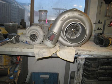

A small turbo that's working hard (or an outdated design) and outside its efficient range produces more heat than a larger turbo that's within its efficient range.
The terms "small and large" have no place in that discussion and "working hard" is also misplaced. You need to size turbos correctly.
Doesn't change the fact that using an arbitrary number such as 18psi above is only part of an incomplete picture.
It would be more useful in conjunction with intake air temperature information.
Swap out ct26 and grurbo for any other turbo name in the same scenarios if you like. The name of turbos is irrelevant, they were to provide an example of known turbos on this forum.
And how would that help anyone?
We all know the CT26 is outdated. No-one should be fitting them.
So, i can fit any turbo at all to any engine? Makes no difference, so long as it hits 18psi, it's all the same?
