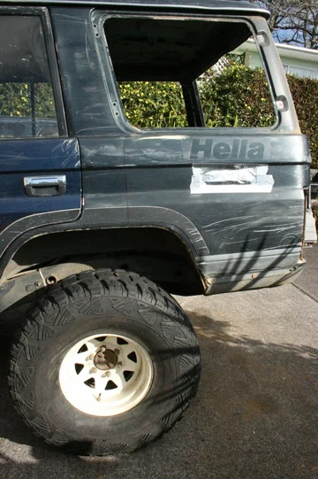

Well I have finally got up the nerve to chop the rear off the Prado from the C pillar back. Had enough of bashing into trees and dragging my rear around.
Will be a slow project but will throw up some pics from time to time. Here are a few after a day with a grinder.
You will be surprised how much weight is in those rear doors !
And also the rear quarters.. Will take it all to the scrappy later and get it weighed.
I also have a chassis to swap out. The original one is bent ! As I have discovered. The truck was involved in an accident before I got it. And I found this out a few years back when putting on my sliders and suspension lift...So a good straight chassis came up at a local yard and I grabbed it...So might as well make my body swap over a little easier with a smaller body and lighter too....:clap:
On to the photo's.

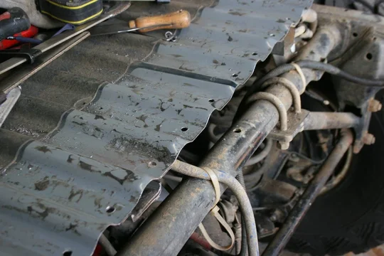

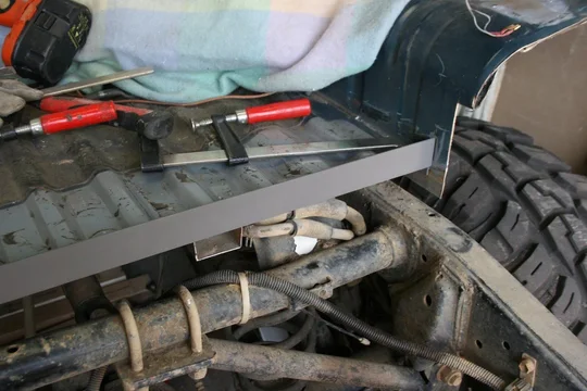

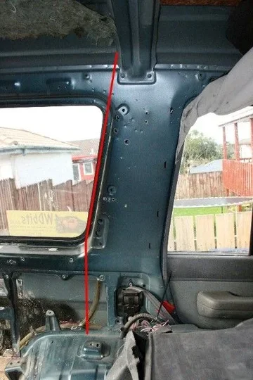

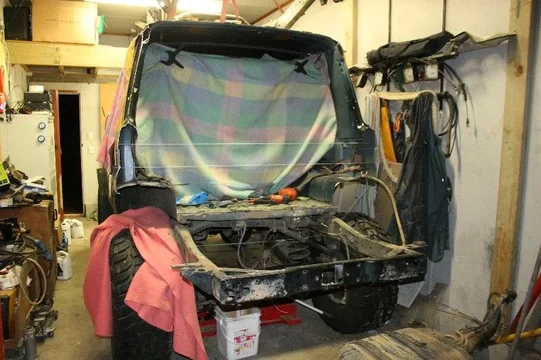

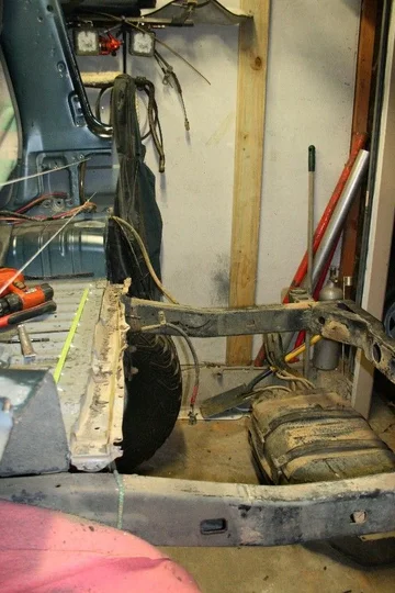

Few more photo's, this time of the support frame for the floor and the rear panels.
Bottom panel is going to finish just below the rear seat height and the window will go above that. No point making window bigger than it has to be !
Bottom floor pan support is a 3mm thick 40mm x 40mm angle. Stiffened the floor pan right up.
With the frame in I can now use it as a ref point to cut the wheel arches...
For those that are interested, the weight of all the rear panels / roof and doors minus glass from the C pillar back is a whopping 120 kg....plus or minus a bit...
