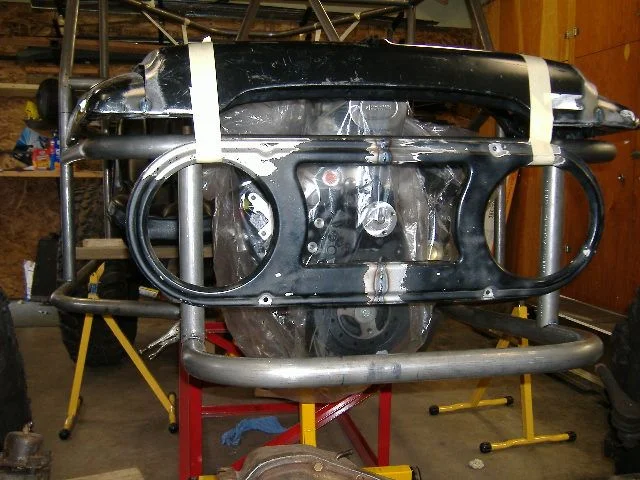

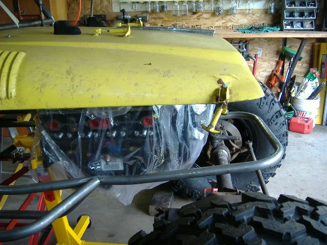

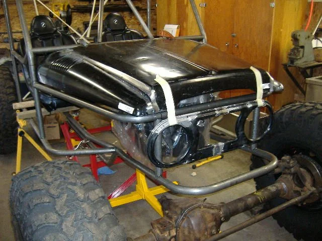

Neat way to narrow the hood! Makes me wish I hadn't already bent tube for the front clip on mine... Oh well, there's always version 3.1!

Eskimo, ya there was some head scratching when it came to the hood. I still need to split the corners, dolly the it up to meet the mid section and refab, but it was enough to fab the front top main tube.
