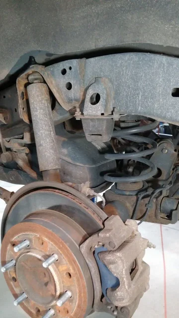

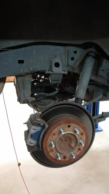

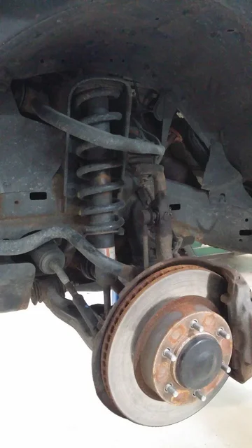

Dad got tired of rolling around on a creeper after, well lets just say a few years :D and finally got his two post Rotary 10K lbs lift. And just in time to put on my OME lift, what a coincidence!
I may have been a little nervous with the FJC being the test monkey for the lift we installed ourselves.. But she held true!:clap:

Thanks! Got told my Maxx's are in today and will be installed tomorrow but the local tire shop wasn't confident that they'll be able to do the alignment with the 2.5" OME lift.. I wouldn't think it would be that far out of whack, but what do I know. We'll see how they do and I may have another shop take a look at it if i'm not satisfied.
I've always been told and done this myself. It doesn't hurt to drive the Vehicle a little. 1/2 tank of gas or so after installing the lift before alignment is done. Let it settle in some.
A decent shop should be able to get you back into a tolerable spec with the setup you have. We have a local guy that's been doing alignments for years and he didn't have any issues getting me close. This is an older guide and there may be something newer but it is helpful.
