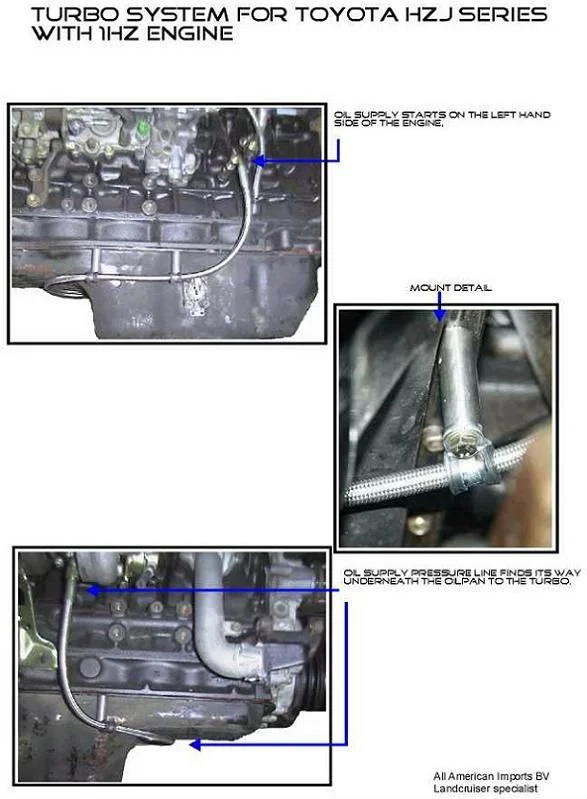

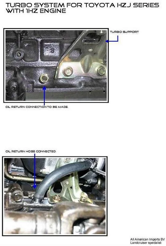

Also:
"Many turbo kit builders like you to fit the oil return pipe into the oilpan. Most of them like you to weld it which wil give you plenty of problems as the oil pan is built from 2 sheets metal with in between a plastic layer for sound reduction. See this as big fun when welding.
As we build the original Toyota kits for Toyota Europe we proposed Toyota to drill thru the block. They were very reluctant to do so but after doing a couple it was all OK. We never had one leaking, we never had one coming loose and we never had one being ripped off by the driveshaft.
Doing this connection you do not have to remove the oilpan. You drain the oil, drill the hole, tap the thread, fit the connection, flush the pan twice ( 1 time with kerosene and the second time with a couple of litres of the engine oil you just drained and then refill."

Quote:
Originally Posted by crushers View Post
if you are achieveing the max boost then it isn't the boost that is going to kill your engine... it is your right foot.
Tapage is offline   Reply With Quote
i also wonder about drilling into the oil feed through the block... how do they keep ALL the metal shavings out of the passage?
cheers
with kerosene and oil " flush "
That was my concern, but it is not a passage he says, just the side of the block. Apparently they have done it many times without problems, but I would prefer to drop the pan and flush and check visually myself.
